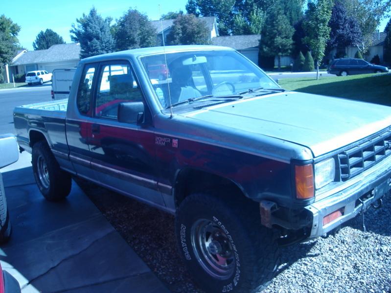

    Brand new to me d50 owner, just bought this little rig for me and my son to work on and have several questions for those of you in the know. Engine sounds good and carb looks new or rebuilt. Can't find any numbers on the carb, can anyone tell me from the pics what it is?

    Try pulling the bottom cover off to see if you can unjam the forks. The carb looks to be the stock mikuni.

    Is a Mikuni Carb, Trans looks like mine from my 2.6, chain drive transfer (KM145?). Assuming you have a 2.6l G54B, even though I can't see the front of the engine.
