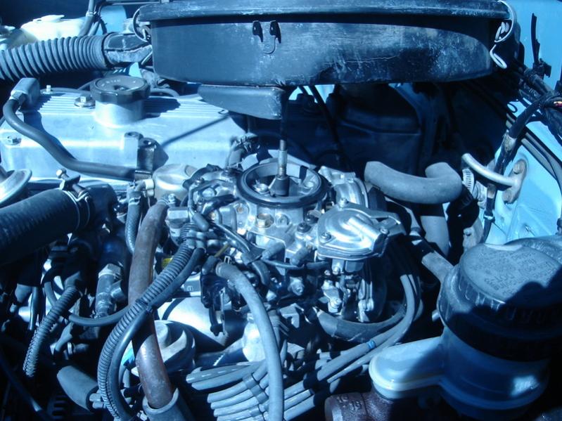

    Brand new to me d50 owner, just bought this little rig for me and my son to work on and have several questions for those of you in the know. Engine sounds good and carb looks new or rebuilt. Can't find any numbers on the carb, can anyone tell me from the pics what it is?

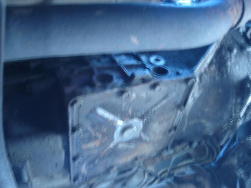

    5 spd manual tranny stuck in 2nd. I'd rather not do this more than once. Haven't seen a good writeup, did I miss it? Should I rebuild or have the tranny and transfer case rebuilt? Other seals or maintenance that should be done while the tranny is out? I know from experience on other cars I've worked on that certain areas are problematic to certain models while others are rock solid.

    Try pulling the bottom cover off to see if you can unjam the forks. The carb looks to be the stock mikuni.

    Is a Mikuni Carb, Trans looks like mine from my 2.6, chain drive transfer (KM145?). Assuming you have a 2.6l G54B, even though I can't see the front of the engine.

    Thanks for the feed back! Rear fork moves freely, front fork won't move. Not only that but the oil fill bolt was rounded off and is in so solid I can't get it to budge - bolt extractors, huge channel locks, vice grips and hammer, torch. Nothing worked. Finally got started pulling the tranny today (been out of town). I have manuals and was making good progress until I started taking off some of the wiring. Was going to ask how to take them off, went out to look again and just discovered that what looked to me like clear plastic solid butt splices are actually connectors that pull apart. I have a donor tranny and transfer case but not sure of it's condition. It does shift through all the gears.
