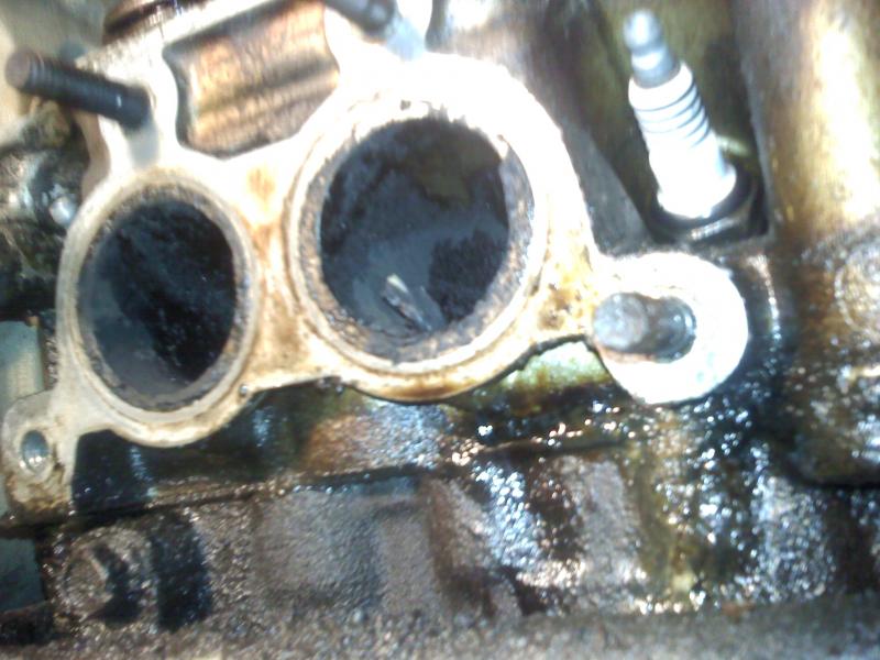

    a pic with the exhaust manifold. u can see the far back stud is missing. apparently one of the guys before me had broke it but with some soaking down with PB blaster everything came apart nicely.
    number 1&2 caked in carbon
    number 3&4 also caked in carbon
