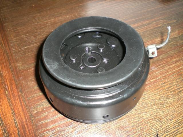

    I got the clutch today and took a picture. It looks great. The company is on ebay selling under Jensen Auto out of Michigan. You can get there rebuilt compressor for $200 or the clutch for $75 if anyone is interestedclutch.jpg.
