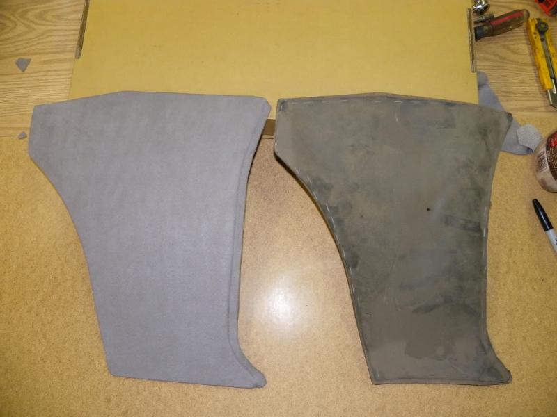

Cut the piece a little smaller then the original on the door edge then tool a 1" strip and glued it to the back of the cut piece then traced the edge the same width as the pinch weld and cut it. that gave the panel a step for the molding.At the back where the screw hole is I moved the screw down about a 1/4" to hold it on to the original bracket.The panel is flat like the original and the board is just cheap hardboard (smooth on one side and rough on the other)in the first pic you can see the type of board the panels are on top of.
fasho. thanks a lot for the explanation. did u lay some sort of fabric ovr the board too or spray painted?
