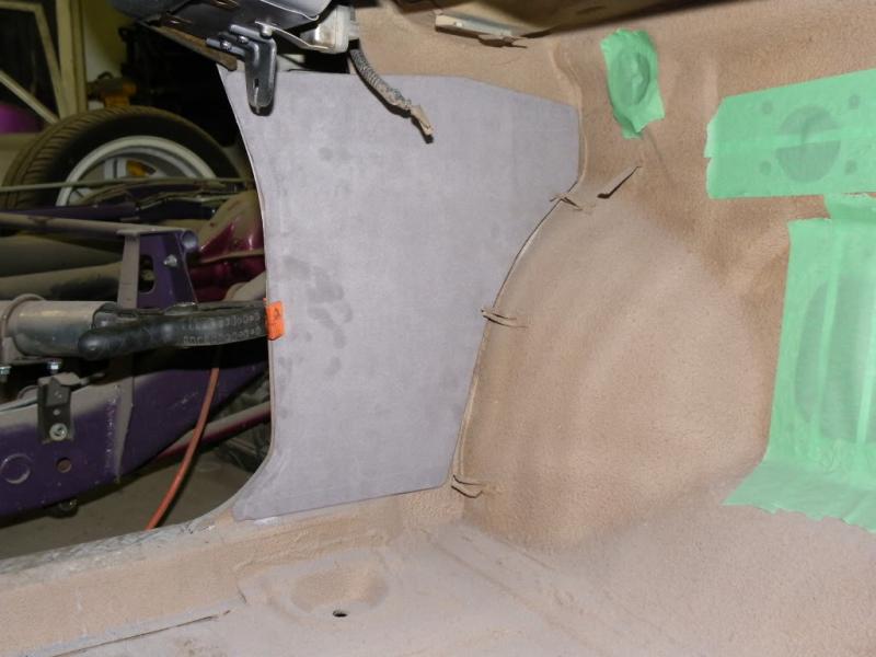

    Super easy to make new ones. I used 1/8th hard board. Traced the original on the board then cut with a jigsaw. then traced a 1" strip to make the step for the weather stripping to lock into place.This is what it ended up looking like after i covered it in the fabric.
    new panel and old card board
    Test fit
    Test fit
    i been staring at da pix for like 10 mins and still cant figure out how u fabricated the panels. how did u get it to curve and bend w/out cracking the board? and I know u mentioned the 1/8th hard board but what kind did u use? is there a certain type? thanks.

    Cut the piece a little smaller then the original on the door edge then tool a 1" strip and glued it to the back of the cut piece then traced the edge the same width as the pinch weld and cut it. that gave the panel a step for the molding.At the back where the screw hole is I moved the screw down about a 1/4" to hold it on to the original bracket.The panel is flat like the original and the board is just cheap hardboard (smooth on one side and rough on the other)in the first pic you can see the type of board the panels are on top of.
    You can also go to the arts and craft store and get the heaviest poster board they have and make them out of that - thats how I remade Geronimo's and will be for the 86.
    fasho. thanks a lot for the explanation. did u lay some sort of fabric ovr the board too or spray painted?
    I seen some guy make door panels on his '88 ram50 out of dark gray carpet.. they looked pretty strange, but interesting. its up on car domain somewhere.
    used the interior fabric to cover them.I just used the spray contact glue on the board and the material then carefully put the material over the board.The sprayed the back side and pulled the material tight and attached it on the back side.

    oh that makes sense.. now how durable is it? idk what the stock ones are made out of, but are the homemade hardboard ones pretty tough? I dont want them to rot at the slightest sign of moisture, but then again its just hardboard. lol idk
    the original 1st gen were a fiberboard much like cardboard but slightly more water resistant. Hardboard would be better - if you can find a plactic supply house, you could get ABS sheet plastic and make them from that.
