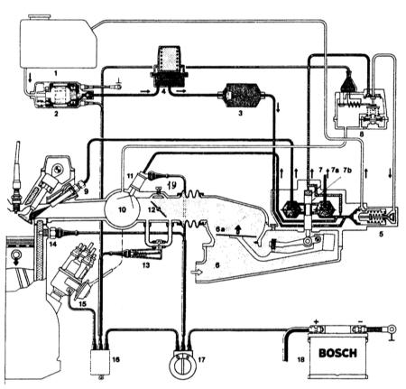

    Well you say you have a 2.0. I think a Bosch k jetronic set up would;d be kind of cool to put on. It's a simple system and theres no real computer to deal with. Just an O2 sensor. They have deferent size injectors for different size engines. Some light machine work on the intake for the injectors and thread in adapters. And best of all you can get the hole system real cheap off a VW Rabbit or Jetta. Now this could work, and it would would be a first for a truck like this. I love the system, there so simple. All that ever goes wrong is the fuel pump relay or the injector O rings would crack and make a vacuum leek.
