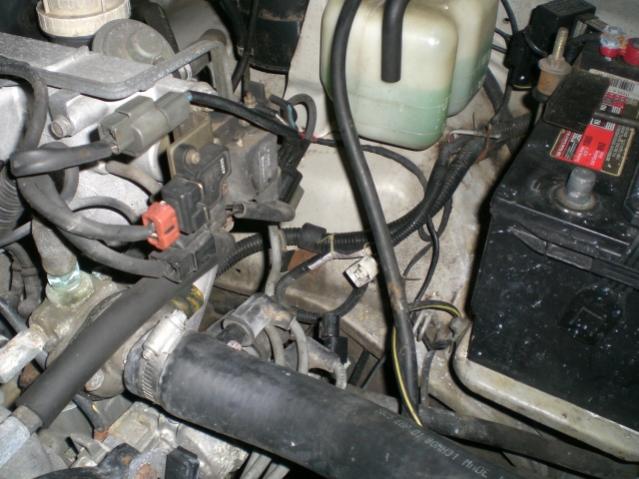

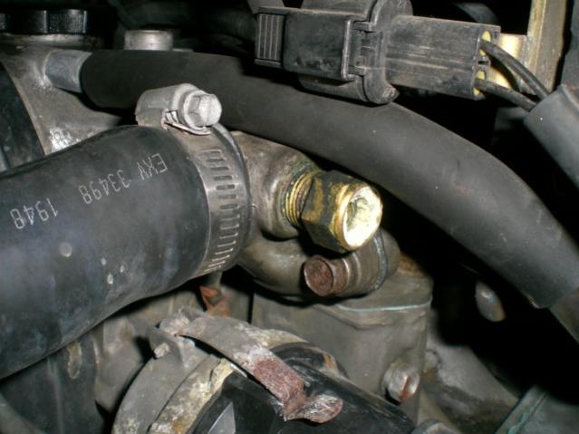

    I was checking to see why my a/c doesn't work, (new purchase, 1995 MM) it seems the compressor clutch isn't engaging when you push the switch, on following the schematics I noticed the coolant temp switch is included in it's path and on my switch it's contacts are gone (gutted) and the wire tie wrapped out of the way. Isn't this switch for the fuel injection and not the a/c? I'm confused.

    The temp sensor for the computer is on the top of the thermostat housing. That broken one is on the side.
    Its either a normally closed switch or normally open switch. Its job is to stop current to the clutch if the engine temp gets too high. That being said, does the connector have a jumper wire in it ? You might try jumping the harness side connector and see if the clutch comes on
    Is there power going to the clutch ?
    You sure its fully charged? There are also pressure switches that stop compressor operation if the refrigerant charge is too low.
    If you unplug the compressor clutch you can check to see if it even works at all by running a jumper wire from the battery.

    no power to clutch so checked fuse first, then started at dash switch, cleaned with contact cleaner it was hit or miss, then checked diagram and followed wires to temp switch, that's as far as I got to this point, just wanted to check how it came into play with the a/c. So the switch I have in the picture is not for the fuel injection just the a/c. Car runs great...The second picture has the white connector that I assumed connected to that broken switch, it's 2 prong 2 wire, it's just below the radiator water bottle.

    Was looking in the manual and the top sensor on the thermostat housing is for the a/c. The one broken on your manifold is the temp sensor for the ecu and t bttom one is for the gauge.
