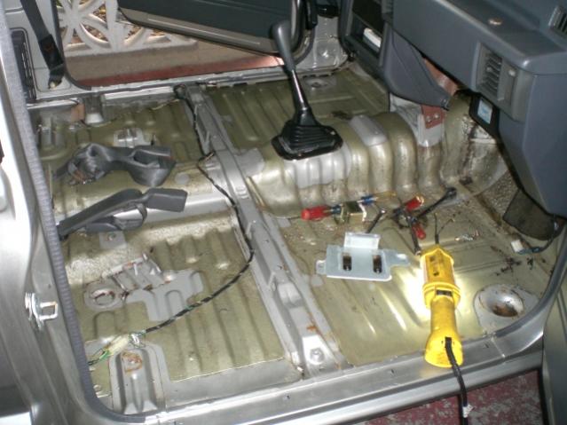

    Well made some progress today, I had to take the carpet out, so I cleaned underneath hung it out to dry and took out the glove box, heater motor and ecm to take a look up above. This side looks worse than the drivers...just take a look next to the hood hinge, I stuck the camera in the hole, well it's actually just the upper seam there, the hinge looks good. I'll cut the seam out of the lower cowl and weld in a patch...I'll remove that fender and take a look inside also. I do need an antenna, so now's the time, does anyone have one...hint,hint

    Today I cut the rust out, will weld in a patch, a little POR 15 and some seam sealer, should be good to go...well this side anyway

    today, I got the welding done on the passenger side
    Nice work, looks good as new.
