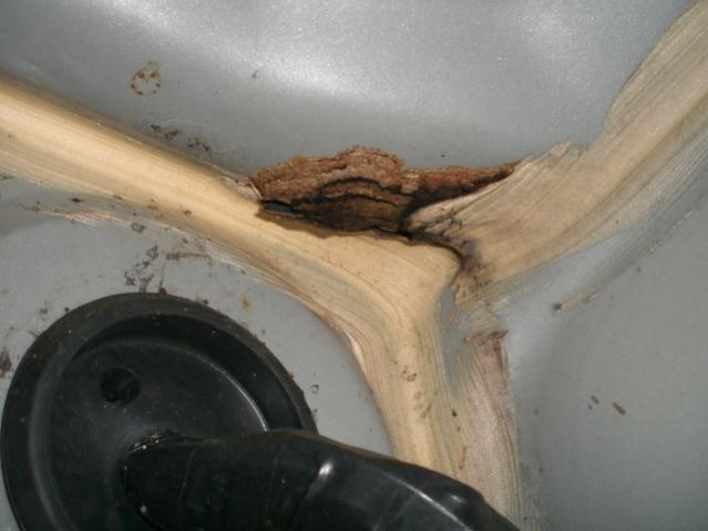

    Well I bought this 95' Saturday, now today mega rain from Sir Issac....noticed a drip puddle in the drivers floor board and by noon...well lets just say it's now a puddle. I pulled the wipers and cowl cover off at lunch to take a look, well it seems you can't see much into the corners, so I climbed underneath the dash to see a small rust hole in the corner of that tray, where the seam seal is. Is there some kind of drain hole (besides my new rust hole) on either side of this tray that could be plugged up....DAMN I hate leaks

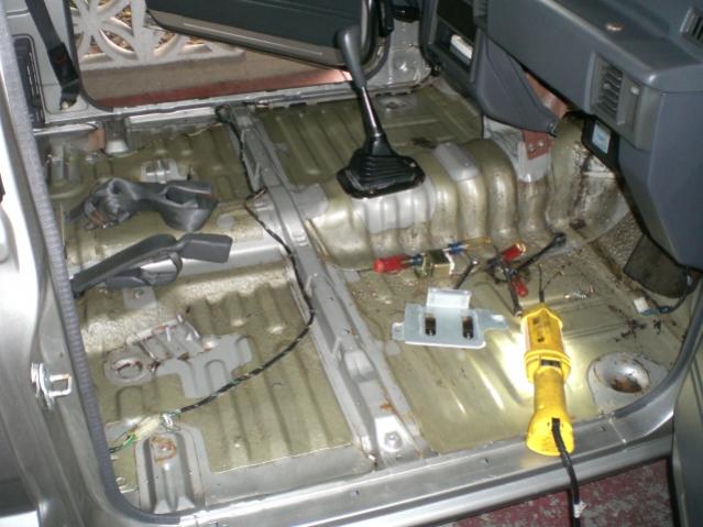

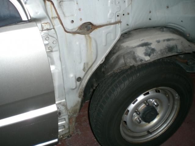

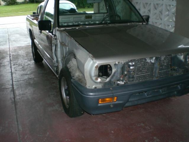

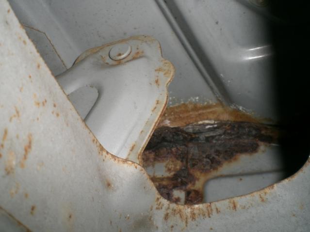

    Well made some progress today, I had to take the carpet out, so I cleaned underneath hung it out to dry and took out the glove box, heater motor and ecm to take a look up above. This side looks worse than the drivers...just take a look next to the hood hinge, I stuck the camera in the hole, well it's actually just the upper seam there, the hinge looks good. I'll cut the seam out of the lower cowl and weld in a patch...I'll remove that fender and take a look inside also. I do need an antenna, so now's the time, does anyone have one...hint,hint

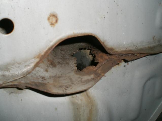

    Today I cut the rust out, will weld in a patch, a little POR 15 and some seam sealer, should be good to go...well this side anyway

    way to go! jump right on it and handle business

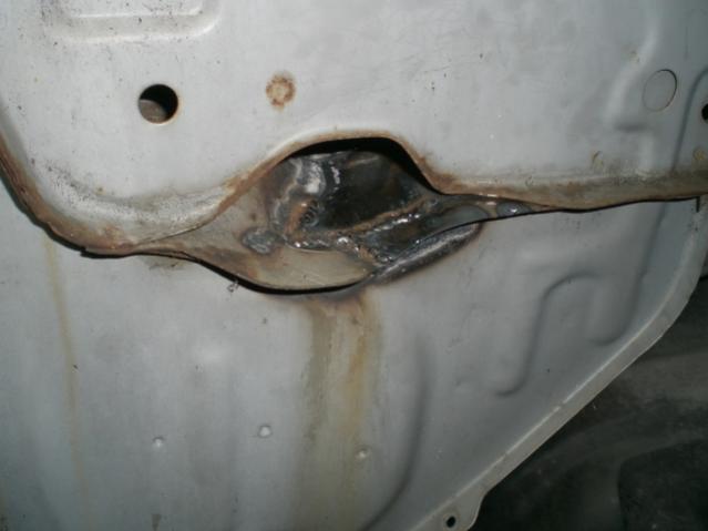

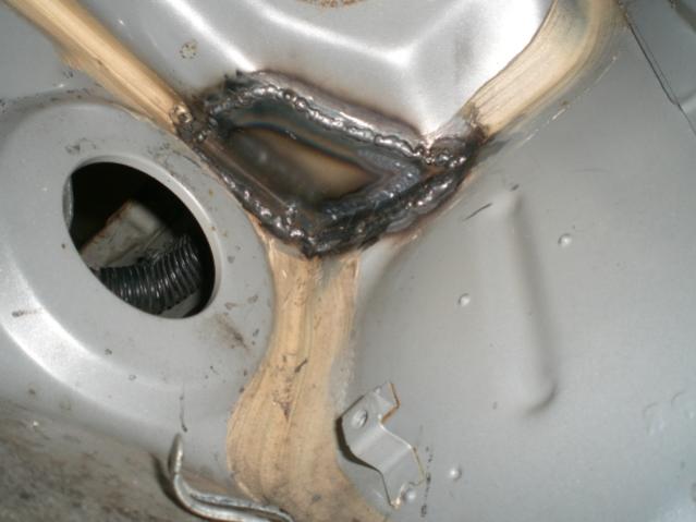

    today, I got the welding done on the passenger side
    Nice work, looks good as new.
