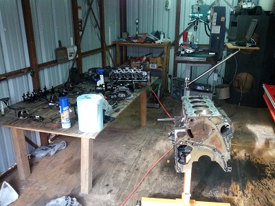

    IMG_20120824_182104.jpgIMG_20120826_180131.jpgIMG_20120826_180144.jpgIMG_20120826_180315.jpgIMG_20120826_180322.jpg
    Working on the motor now, I have it all striped down and ready to go the machine shop. As you can see from the pic, those cylinder walls dont look to good. .040 over should do the trick. Also going to put a new 4d56 head on and a new turbo. I wanna find a turbo that will last longer than the stock turbo, maybe a garrett t3. Im going to have the injector pump and injectors rebuilt to, do any of ya'll know what 4d55 performance did to his injector pump that enabled him to get 40+ mpg cuz I wanna do the same, lol. Planing on pulling trans and transfercase to put in new seals.
    Once i get all that sorted out I'll be pulling the body off the frame to have the frame blasted and I'll be repainting it. I'll be patching up the few rust spots and fixing all the dents then repainting the body my self. Redoing the interior with a custom dash that i wanna try making out of aluminum. custum aluminum door covers. Maybe a custom center console too. New carpet and I'm gonna have the seats reupholstered. All new weather stripping too.
    I also plan on putting jeep cherokee dana 30 front and dana35 rear axles with the jeep springs and shocks.
    Gonna be a long process but its gonna be awsome when its done.
