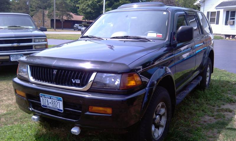

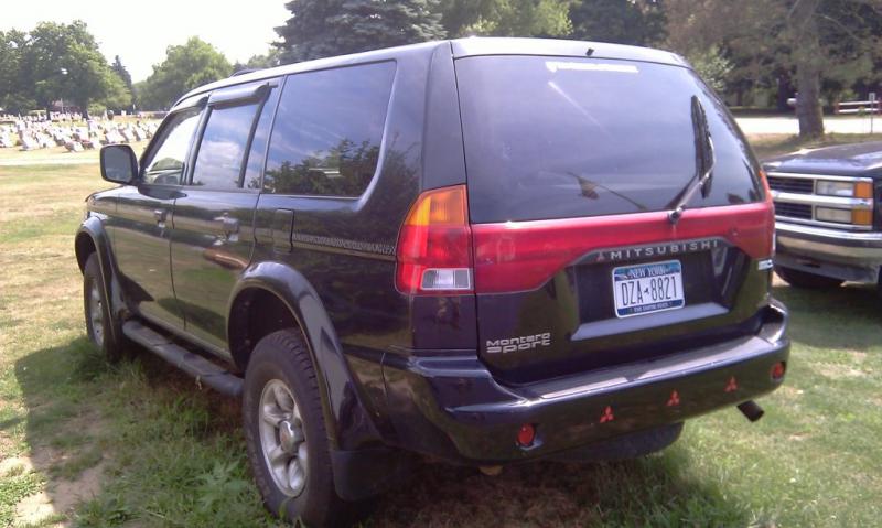

    Here are some pictures
    [image]http://i682.photobucket.com/albums/vv181/TwistedNoodle_1/IMAG1338.jpg[/image]
    [image]http://i682.photobucket.com/albums/vv181/TwistedNoodle_1/IMAG1337.jpg[/image]
    [image]http://i682.photobucket.com/albums/vv181/TwistedNoodle_1/IMAG1336.jpg[/image]
    [image]http://i682.photobucket.com/albums/vv181/TwistedNoodle_1/IMAG1335.jpg[/image]

    IMAG1338[1].jpgIMAG1335[1].jpgIMAG1337[1].jpg[ATTACH=CONFIG]3415[/ATTACH

    If its as clean as it looks id say the 700 + 500-1500 installed for a decent engine still makes it worth it
