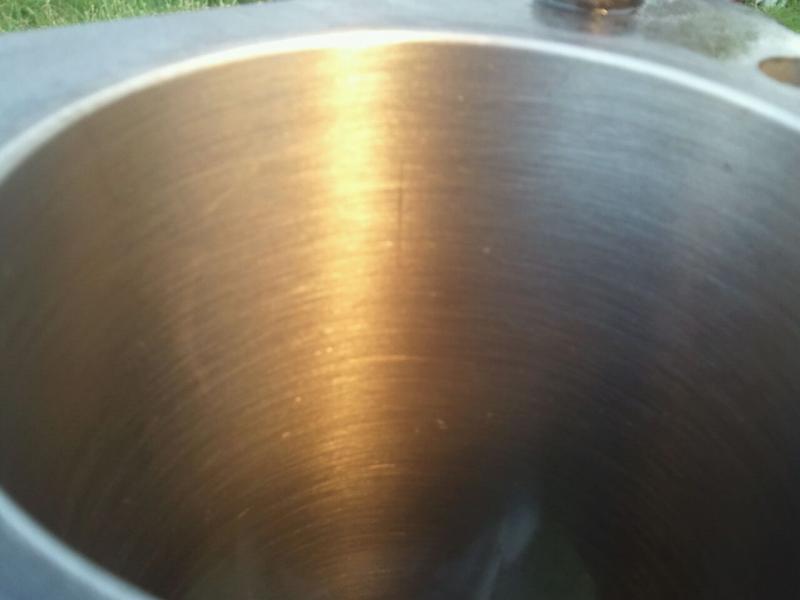

    I have an 86 Ram 50 with a 2.0L SOHC, I'm replacing the rings and shaft bearings and while honing the cylinder walls I noticed a scratch at the top portion of the #1 cylinder wall about an inch long. I cannot feel it with my fingertip, yet If I run my fingernail across it, I feel it.
    Is this something to be concerned with? What can be done about it?
    If its not deep the honing should take care of it.It was probably caused by one if the piston rings.

    If the honing doesnt take it out after a few passes then Id bore it and get new pistons.
    I second that - if the honing can't get it out the boring will.

    Here is the scratch after final honing.
    That's nothing, just make sure the piston ring split is in a different area on the wall and you should be fine.

    3,846
    How much taper is in the cylinder?
    Find me on FaceBook
    clicking HERE.
    07-28-2012
    11
    Sagle, Idaho.
    1986 Dodge Ram 50
    The cylinders have been bored once so I don't think there is much if any taper. I'm having this checked out though.
    3,846
    how many miles were on the cylinders? Taper is always worse at the bottom. But there is also a limit on how much you may have to spend, and I have no idea what your limit is. If it's cheep then slap her on the ass and send it on it's way. But a second look from a machine shop won't hurt. If there half way decent they won't charge you and give you there honest opinion.
