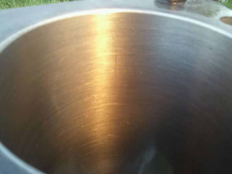

    I have an 86 Ram 50 with a 2.0L SOHC, I'm replacing the rings and shaft bearings and while honing the cylinder walls I noticed a scratch at the top portion of the #1 cylinder wall about an inch long. I cannot feel it with my fingertip, yet If I run my fingernail across it, I feel it.
    Is this something to be concerned with? What can be done about it?
    If its not deep the honing should take care of it.It was probably caused by one if the piston rings.

    If the honing doesnt take it out after a few passes then Id bore it and get new pistons.
    I second that - if the honing can't get it out the boring will.

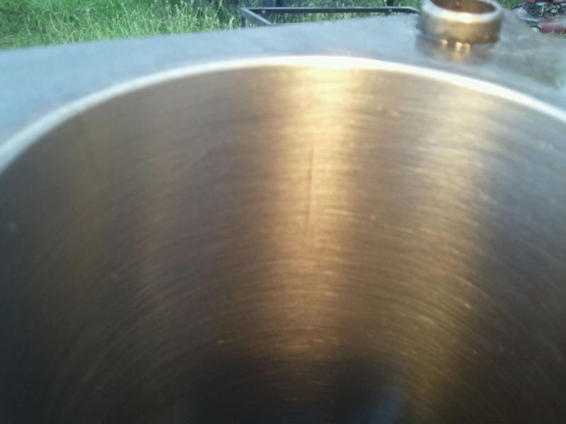

    Here is the scratch after final honing.
    That's nothing, just make sure the piston ring split is in a different area on the wall and you should be fine.

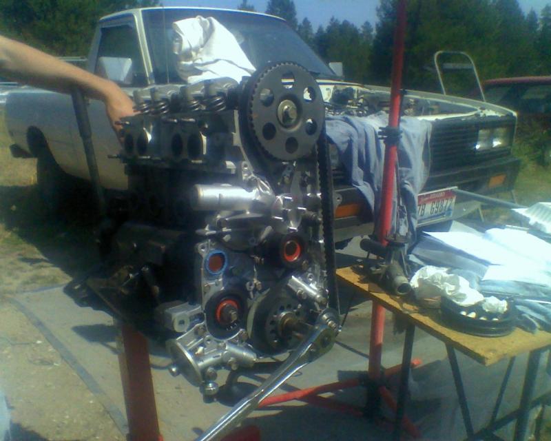

    G63B with timing belt.jpg It's been slow going, but I eliminated the Balance shafts and currently in the process of putting things together. the Transmission was overhauled and is in place. slowly and surely it's coming together.

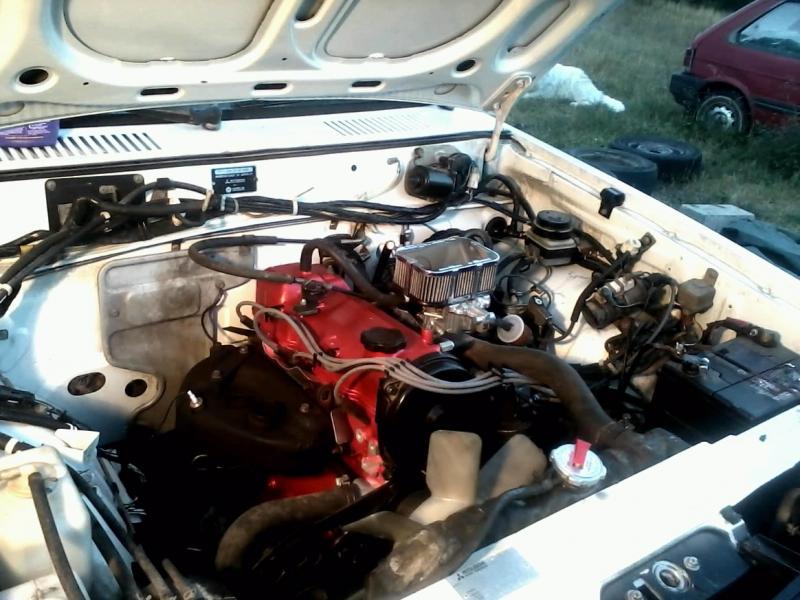

    s phone pic.jpg There it is. We got it installed Sunday before labor day and it seems to do well. Another Ram 50 survives the scrap yard.
