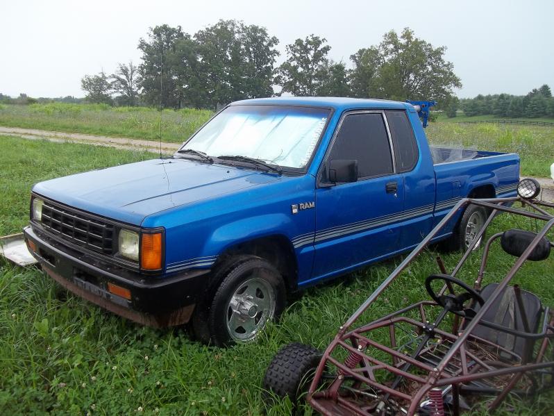

    06-27-2012
    47
    Alabama
    1991 Mitsubishi Mighty Max
    4G52
    here ya go

    Quote Originally Posted by baker4401 View Post
    my ram came with these 15's on them can any one tell me if they were offered from the factory or if they are aftermarket ??100_0654.jpg100_0652.jpg
    Those are the factory chrome 15's
