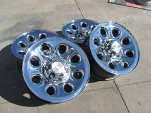

    yes they will.
    03-21-2011
    767
    WA
    Center bore is a bit small. Some modification to your hubs or spacers will help.
    Grind down the tabs and lip on your hubs or bore the centers of the wheels to 4" and they will fit.

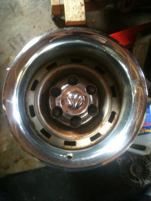

    I had my 15'x8" Chevy Cheyenne rims machined....the lip around the centre hole is all that is removed....not even a quarter of an inch is removed.....$15 per rim

    Chevy/GM Rallye Rims
    I had a set of 15"x8" Cheyenne rims, found a set of bow-tie centre caps, already had a set of 2 1/4" Chrysler 300 centre caps.....peeled the bow-tie off of the Chevy caps, drilled a 2" hole in the centre and popped my 300 caps in. I had my rim centre hole machined to eliminate the centre lip and voila....instant 15" rims that look awesome on the truck. The offset allows me to put 275 60's on them with lots of clearance.

    With these caps, I also picked up 24 Chevy lugnuts with the threaded tops....the caps black plastic lugnuts screw onto the metal ones securing the cap to your rims

    Steel rims are a piece of cake to modify....any shop with a late can do up a set fast...and CHEAP! I had my 15x8 Chevy Sierra rallyes done for $15 a piece....turned out amazing......and with the modified caps and trim rings, they really suit my '87 Ram50.
