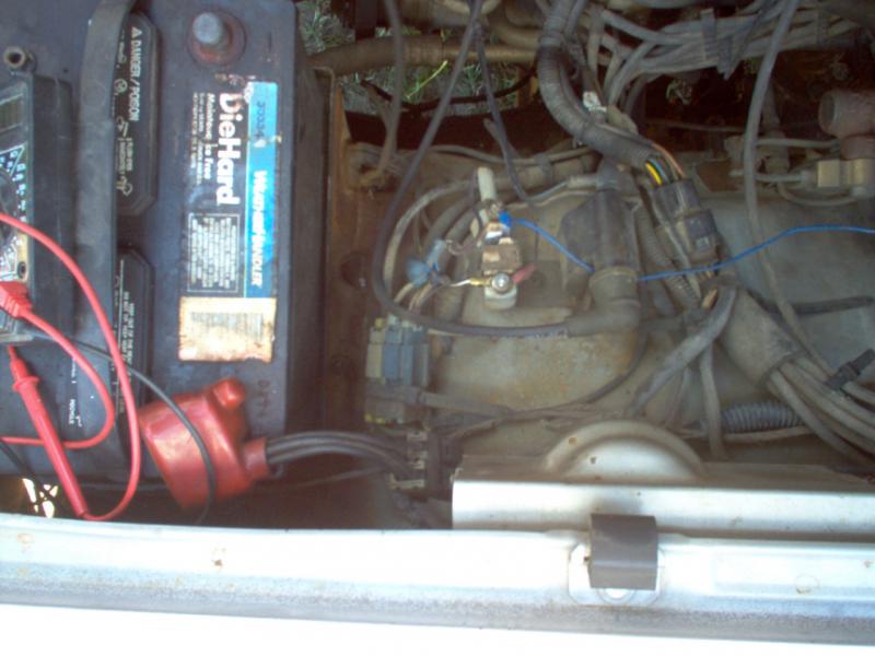

    if the dropping resistor is the same as the ballist resistor,it will be on your drivers side inner fender well,behind the battery.little whitish/grey looking creamic thing with a wire or two on it.Ours went out and the thing crumbled when we touched it.
    this is where ours was on the 88max we had a few years ago.
