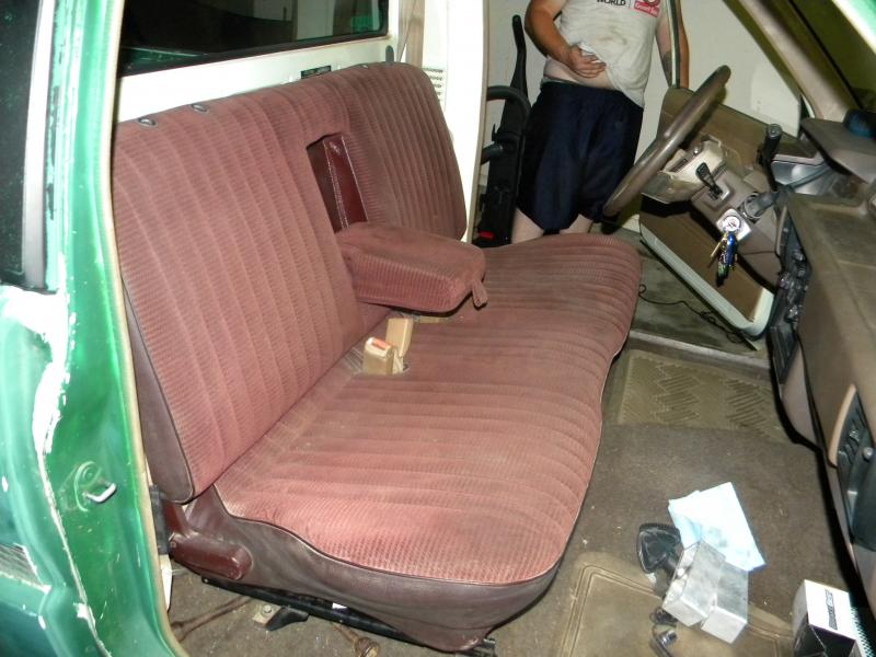

    just curious to see if anyone would know if a hardbody bench seat would fit in my 87 d50. i got it for free from a buddy of mine bc mine is starting to show its age.
    The width should be right - pull the old one and set the new one in and see how it lines up. You may have to swap seat tracks and/or drill new mounting holes to secure it. Geronimo's seats have been changed so many times I lost track in 32 years.

    i went ahead and pulled my old on and width was the same so i went ahead with it. the sliders on it were a little short so i lined up the back ones put the bolt back in and used it as a holder. on the front i lined everything up and welded it in place. once i got it back in and bolted up, it rode better then the stock one. sits a tad bit higher but past that it rides better. plus i have an arm rest now.
