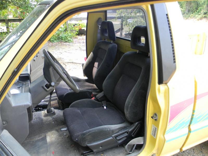

    Took out my broken,tail hurting bench seat and installed these Integra seats.Have to modify them a little but will work out fine.

    For reference,the bolt holes line up in front.
    Seats sit a tad low but i am 6'2 so they are perfect for me.
    inside rear mount will need a ne whole,outside rear mount will need an adapter
    of some kind since the rail mount on seat doesn't lay flat.Kinda like an L bracket
    and make new hole in floor.
    Did a 150 mile test drive today,seats rode great.No back ache like the wore out stock bench

    Can I just use the bench brackets? Will they work on the buckets?

    Quote Originally Posted by Sergio T View Post
    no.buckets have 8 holes,4 for each seat.bench has 4,2 on each side
    If you have 2 sets of bench seat brackets, then you can use the bench brackets, 1 set per seat.

    Integra seats sit lower on their factory brackets.I am 6'2 and a big guy so i like the extra room I have.With the factory bench brackets,seat height should be same as the factory seat.
