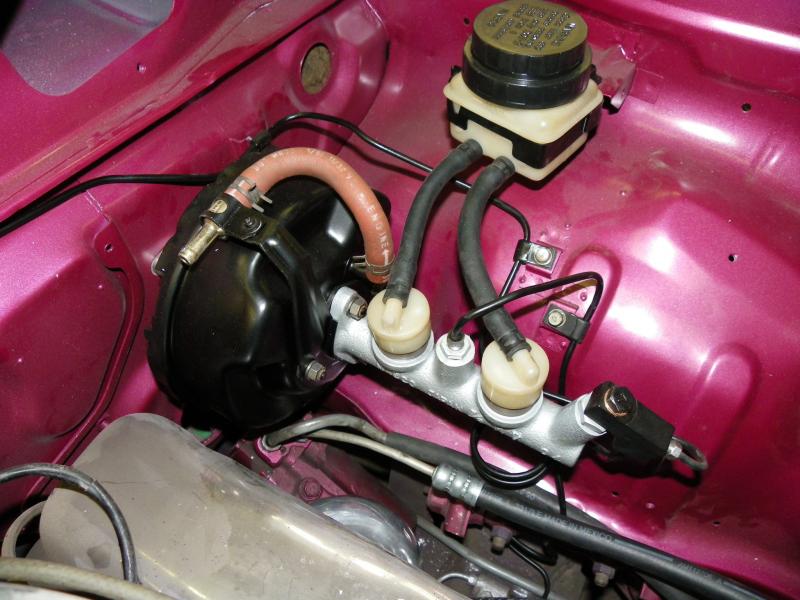

    Question- did Mitsu offer a m/c without a remote resevior? I saw one on another post here and wasn't sure if it was a Mitsu unit or something on another type truck. The factory m/c is a bit funky looking, which I can deal with...but I'll still have to sort out what line goes where and what the heck the little tiny line is between the two valves on it.

    I want to say the late model Mighty Max is that way.
    First gen's had a remote resevior and Sec gen's had it mounted on top of the M/C.
    The back brake line is in the middle of the M/C
    The front's go to a distribution block on the front of the M/C
    Yup second gens have the reservoir on top of the m/c. But our master cylinder bolts up to the booster differently from what i see in the pic
    The 2nd gens use both a different master and booster - change them as a pair and you'll be fine.

    Humm, and I bought the whole setup for a first gen already. OK, who has a picture of the second gen setup?
    3,812
    If you have a first gen, then use the first gen set up. Just the reservoir may be hard to find.

    Where can I find a diagram of line routing, and does anyone know the fitting sizes so I can buy new ones and run some new tubing?
    3,812
    As far as I know, there is no diagram in any manual. But if you look in the factory first gen manual we have it might have somthing to help you. As for the line size just take in the master cylinder with you to Napa and just size them up.
    We are lucky, we have a place that specializes in this stuff. Great place, crappy web site. http://www.ccbparts.com/
    Can you put up a picture of what you have to work with? It may be easer to find a truck at pick and pull, then just pull the lines or pocket the ends.

    I think you're thinking along the right lines there, camoit. I still haven't mounted the M/C, so I can carry it with me to a parts house and get the male fittings I need, figure the rest out at home.
    I've got the same set up as Fordubishi, and what I don't know is where that center line between the two cylinders on the M/C goes to and where or why there's two more fittings on the front of it. Seperate lines for each front wheel? That doesn't make sense...
    3,812
    Well if you look at Fordbushi's picture, you can see the 2 lines to the front wheels. You should have 3 lines that go to the master cylinder. 1 that goes to the rear and then T's off. And the 2 fronts that connect to the T on the master cylinder it's self.
    That's the correct routing for a first gen - If you really want the mount for the first gen reservoir I can cut one out of my first gen parts truck if its still good.
    In the Manuals section here on the site, download the Montero Manual, (FSM_1992-1995_ enginechassisbody.zip)they're basically the same. I checked the 1992 manual, section 35A page 24, Brake line routing, nice Pix!
