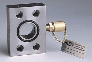

    here's the Boost Leak Check adapter.
    Here's the culprit, the Throttle Body Gasket, apparently it only handles about 25lbs.
    Now to figure out the Tranny leak. and get the gasket to hod more boost!
    Mill the body and put in a large O ring. That is what Cat does. Something like this.

    why is the gasket all black like it got burned??? Good idea with the o-ring camo.

    Intake temps have been hitting 150 degrees under boost. Camoit, basically what I'm doing, I'm putting in a 1/8 inch plate. It's a 70MM Eclipse TB on a Truck Manifold so it's not a perfect match gasket wise (my mistake) this plate will solve that problem. the TB and gaskets are at my Machinist so he can make the plate.
    To bad, Cat has O rings that can take the heat and darn near everything you can toss at them..
