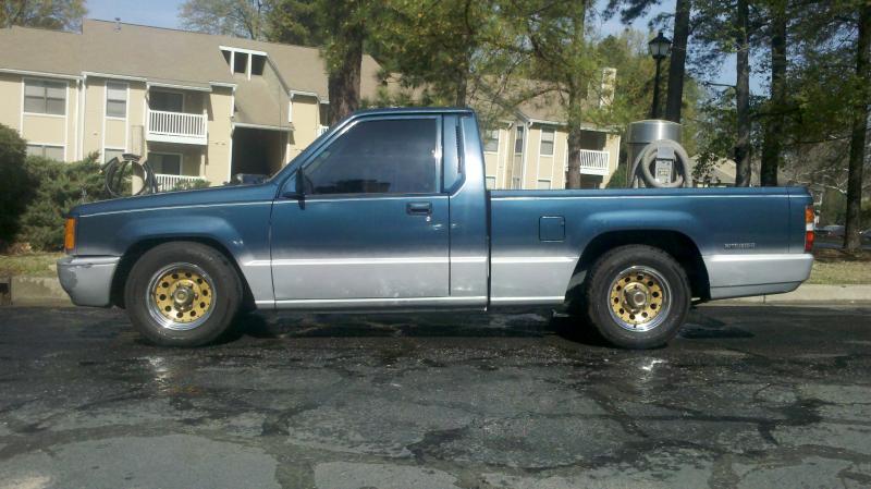

    Sneaker Freak
    Needed two tires anyway, so I finally found someone who could get the Kumhos I had to match up. Took the opportunity to put my other two gold wheels on the ground. Smooth ride and noticeable increase in grip - still OE setup. Very happy with the ride, but looking forward to the suspension upgrades... :-) I'll keep you posted.

    Pics w the Drop Kit On
    Very noticeable change in acceleration and braking. A little bouncy, but still a smooth ride - especially cruising at highway speeds. I'm very excited about how the truck is coming along...
