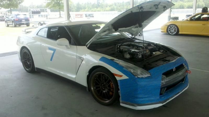

    A Day @ The Track - Video (GT-R)
    Here is the one I would love to get. Oh the things I would do to get one.
    Cam, This one's for you. Video still doesn't do it full justice. Awesome exhaust note. (Driver said he had a cutout switch to go from muffled, to direct out 3" open.) Enjoy!

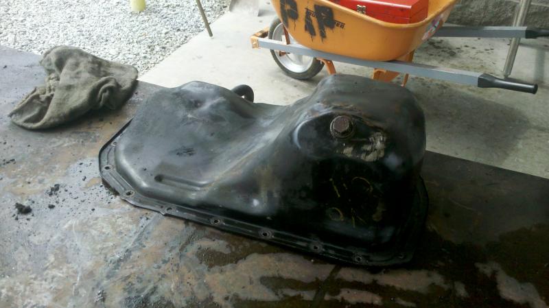

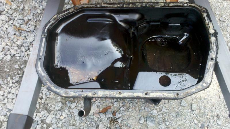

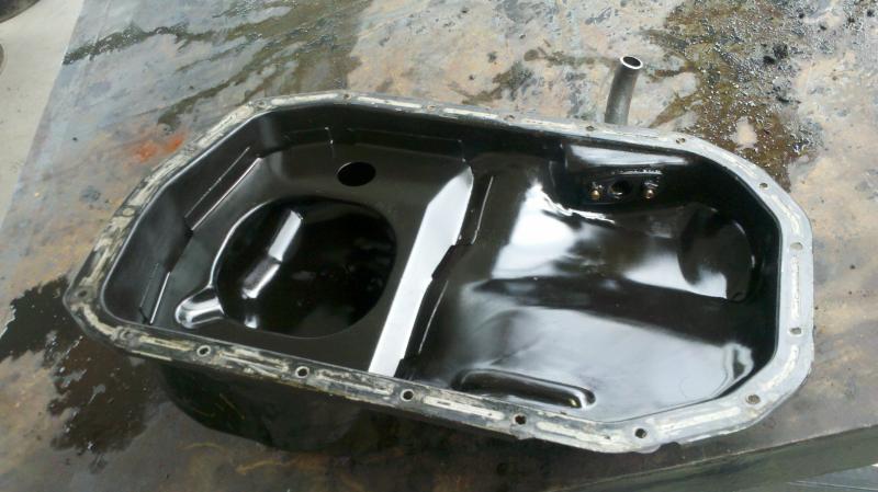

    Trip to the Yard for the Oil Pan

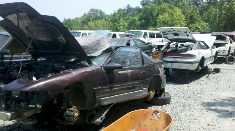

    Ok, back to the build. We talked about the oil pan for the Laser. Never did find a reasonably priced aluminum replacement, so I had to sniff out a tried and true OE. Gratefully there was an AWD Talon with just what I needed. (hated to see an AWD like that, like it was an awesome horse left for dead in the open plain to get picked apart by vultures...) Well, it is what it is, so I had to be the vulture this time. Pan had a nice pickup baffle already in (not sure if the OE Laser pan had that too - long time since it's been off), but that will help when I'm on the road course. I've decided to campaign the RS-T in NASA Pro Racing's "Performance Touring" Class -(final mods determine who you actually run against on track, as long as there within that base class). But a stock '90 RS-T is classed PTE.
    It was a milkshake that brought this Talon to the yard... Water/Oil mix in the pan when I pulled the plug. Good sign that it still held fluid. I pulled the pan, and the bolts, and kept the cut oil return line. All threads good, plug good, even filled it with water and let it sit for a while to ensure no cracks before I bought. #allgood
    So hopefully, that will put the day the Laser is on the road, that much closer. Thanks for "tuning" in!

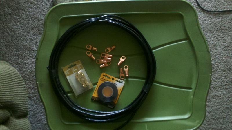

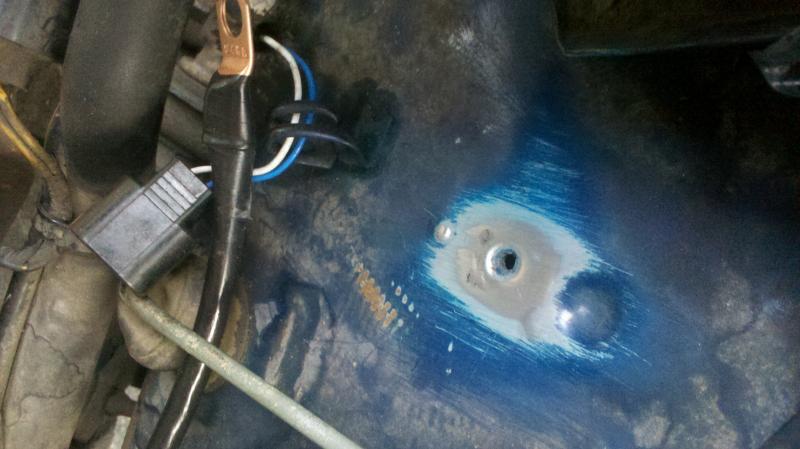

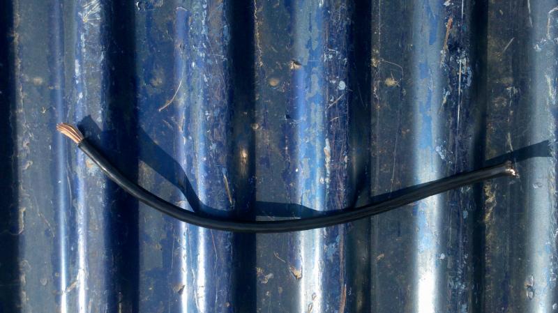

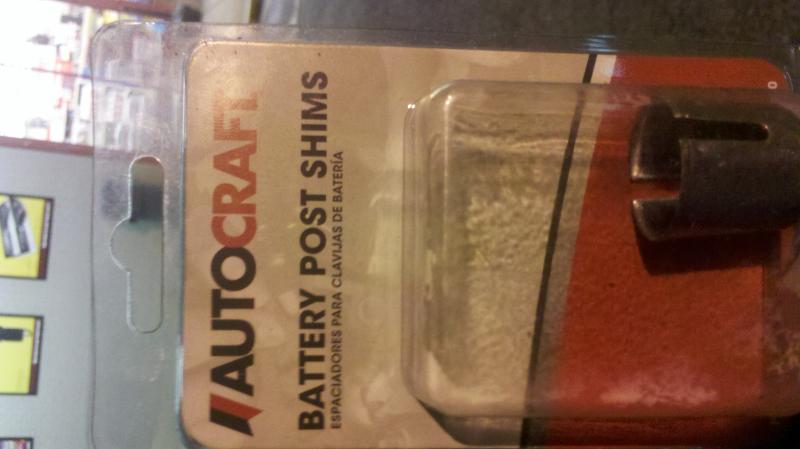

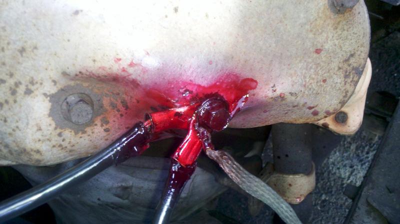

    Homemade Ground Wire Kit

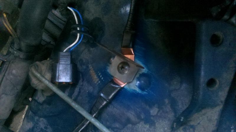

    You know how you can buy the ground wire kit from Hyper Ground? Well, if you're on a budget, but want to improve performance (for real) make your own. You need 4GA wire, copper or gold plated ring type end connectors, electrical tape, a compatible battery terminal and some time.
    It's actually pretty easy, and you save a decent bit of money off the $100-$115 retail price tag. Pick your mounting points ahead of time, cut your wire to length, put connectors on each end and hook it all up. *IMPORTANT* Daisy chain from the battery to your first point, to your next point, to your next point - instead of making one wire from the battery to each point. I decided points based on some crap I read on the net. But i found out from an audio installer, that if you want to be more scientific about choosing points, get your multimeter and check resistance between the neg terminal and the potential point. If the number is like .00045 or something super small like that (or super small like the motor in a Honda), then you're good. It's as simple as that. If you pick different points, you get different results, and they have been proven time and again on the dyno. If you dyno each time you change points, you can get a specific read on how it affects your power and torque curve. My daisy chain looks like this - Battery to Coil to Distributor to Exhaust Manifold to Wheel Well(Body) to MAF Sensor. (Honestly I haven't checked the function of the MAF wire. I copied somebody who said it worked for them.) I'm looking forward to a new Dyno Run to see the true effect. I'll definitely repost when I get the results.
    *NOTE* There is no way I can tell you how much HP and TQ this mod will gain for YOUR truck. Depends on your truck and your chosen mounting points. But it DEFINITELY does work. Don't listen to those nimrods on the net that say there's no way these few wires will help performance. THEY WORK!!
    Thanks for stopping by. More to come... Stay "Tuned"!

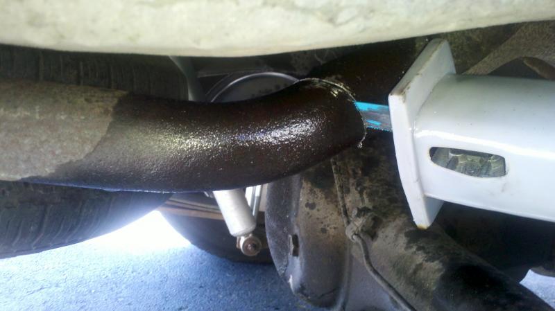

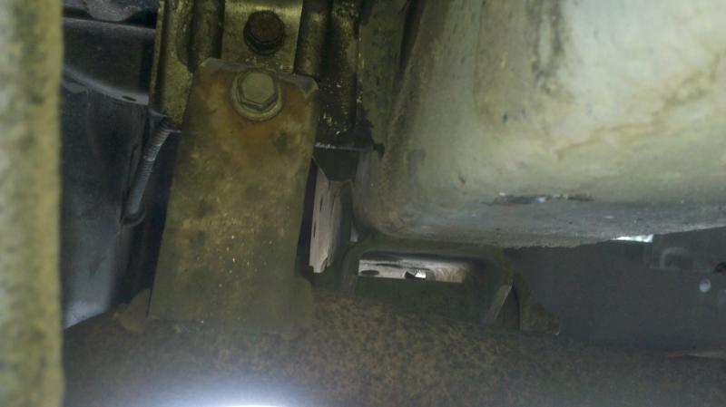

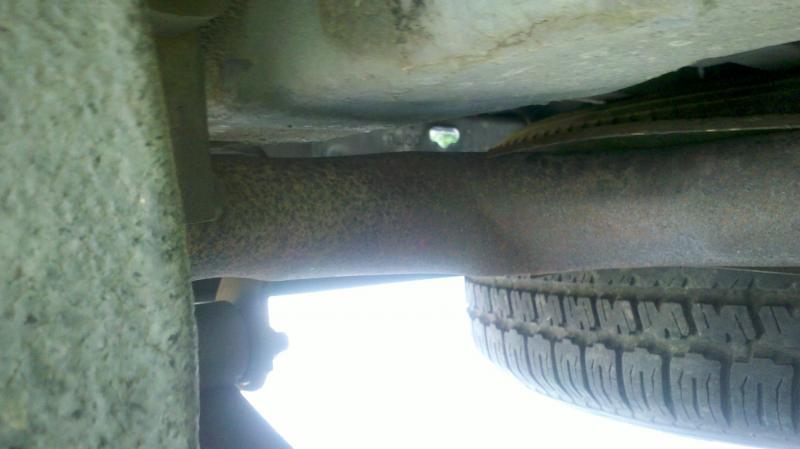

    Don't Get Pinched!

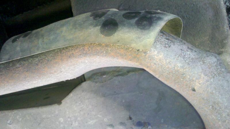

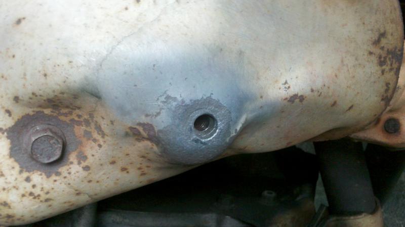

    OK, so I know our stock exhaust is already a little anemic, but MAN! There's no way a proper Mighty 50 engine can breathe through the nasty "last bend" in the tailpipe... (maybe it was just my truck), but it was hardcore. See...
    So, if you've got a nasty bend like this, here's a low-buck way to beat the system...
    You'll need:
    1 Reciprocating saw with a metal-cutting blade
    1 Can Lubricating Spray (no judgement on where you might get this from) I used PB Blast
    1 12mm socket and Rachet
    That's it. Take the passenger rear tire off (make sure to support with jack stands), slice the pipe above the bend and free up some flow! (for the newbs) Make sure to spray the lube as you cut to save your blade and keep your cut as smooth as possible. You can cut yours wherever you want, but I tried to catch a place in the pipe that was as open as possible and points toward the ground as much as possible. That way it won't blow directly on the spare, it still uses the heat shield at the top and is easy to get to with the saw.
    Here's why you need the socket and ratchet... If you want to keep a stock appearance so you don't have the "fuzz" wondering why you don't have a tailpipe , attach the pipe to the bottom hole of the bracket that the doughnut was on before. It bolts right up and looks stock. Voila...Magic!
    *NOTE* Do not expect this action to gain you 20WHP!! But it may get you 2 or 3 and help you smooth out your powerband. It definitely has made a difference for me. Try it out and see.
    More to come. Thanks for "Tuning In"!

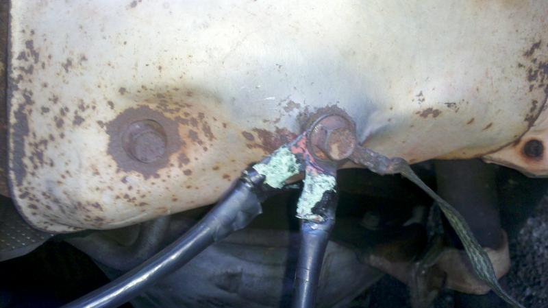

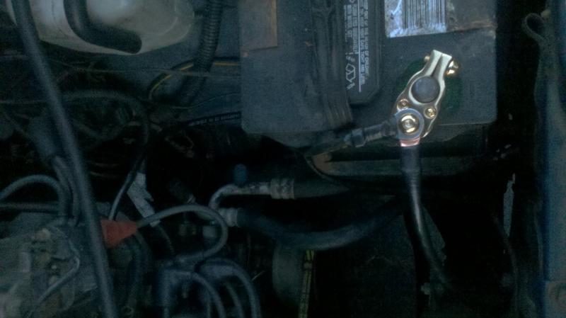

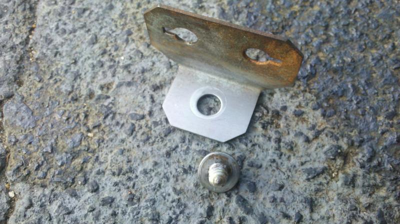

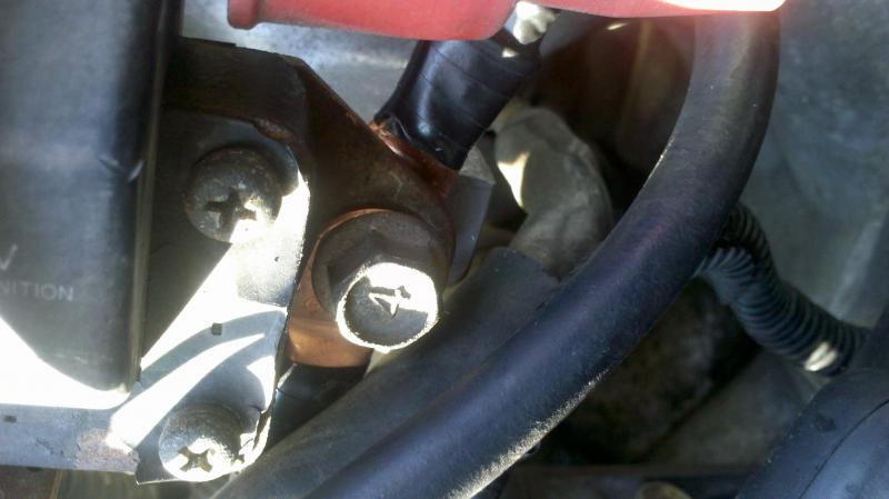

    Update on the Homemade Ground Wires
    Soooo, the wire ends I hooked to the Exhaust Manifold Heat Shield started corroding - especially after the electrical tape at the very end of the connector started melting from the heat...
    So I got a stiff wire brush and some battery terminal sealer from Wally World and cleaned it all up. Hopefully it holds, I'll let you know...

    Daisy chaining the ground is only good while the connections stay tight - if they loosen up you are done. A better way for those on the cheap would be to get a grounding buss bar from a circuitbreaker panel - you can buy them separately. Then run a wire to the negative on the battery after grounding each point to the bar. Not every point needs a 4 gauge wire either - if your main ground cable from the battery is clean and tightly grounded at each point, the auxiliary grounds are extra insurance. Adding grounds are always a good idea, but they need to be neat and away from heat.
    No disrespect Penny, but any electrical connection that's loose is gonna be no good... even if you use the grounding bar... #justsaying
    But tell me my friend, why do you feel a bar is better? Even less resistance? Easier installation? Looks? It's science, so there's more than one way to do everything. I definitely want to know your perspective on this.
  17. #67
    I was just giving another way to ground to a common point without spending big bucks. The grounding bar is simply a means to attach a lot of wires together to a common point, which then goes to the negative terminal of the battery. I was in no way inferring that your method was wrong or problematic - just another way of doing it. I am running Phoenix Contact grounding connectors - they attach to a Din rail and is grounded to the body and I also have a wire run to the battery. These are industrial connectors and can take up to a 4gauge wire in the ug 4 version I am using. I will take pics and post them on here to show the way I did it. Please accept my apology if I offended you. I also am not thrilled with the daisy chain method the factory used for their grounding on the body, chassis, and block - it causes problems on a regular basis and requires yearly maintainance to keep it totally connected i.e. low resistance.
