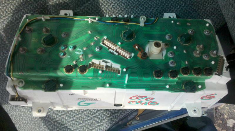

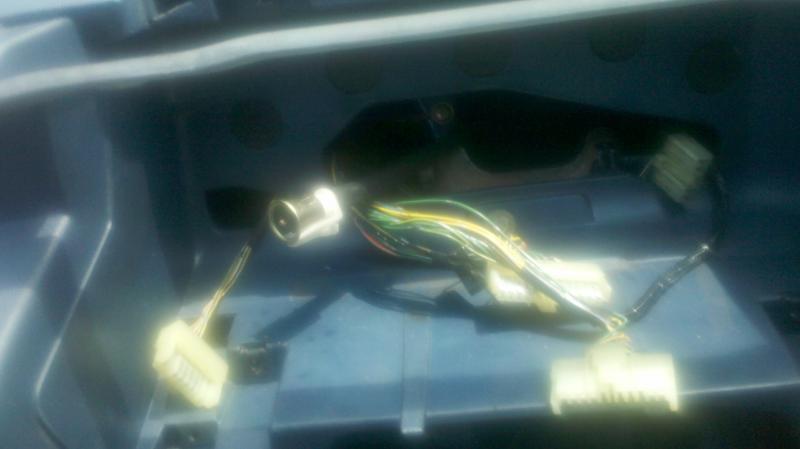

    Finally! The Tach Cluster...#Nice
    Gratefully, I was finally able to find a tach cluster salvage for a reasonable price. I installed it in the parking lot of the yard, to make sure it worked, (because I had to drive about an hour to get it), and it popped right in - good to go! I had to use scotch brite to get some of the rust off of the metal connector that was sticking out, but other that that, it was easy. Reading the instructions that talked about re-routing the speedo cable, it took me a sec to realize the best way to do that.
    When I first moved the cable, I tried to put it UNDER the metal bracket. That made the cable too short. There was a round hole going THROUGH the metal bracket that made the cable just the right length and angle.
    The sender (for the gauge) that I got from Advance looked HUGE by comparison to the online pics, but it threaded in and works fine.
    My truck got 15K mi younger with the install (LOL) so I have to find out how to roll the ODO forward so it will match, and we'll be solid. Anybody have any tips?
    I'm grateful for the progress. I've got to re-check the timing and reset the idle speed and go from there.
    I'm not exactly sure what I'm going to do next, but I'll definitely keep you posted.
    Thanks for checking me out.
    Stay "Tuned"!
    2012-04-25_11-32-51_328.jpg2012-04-25_11-33-02_211.jpg2012-04-25_12-13-15_556.jpg2012-04-25_12-13-39_969.jpg2012-04-25_12-34-07_197.jpg2012-04-25_12-55-16_864.jpg
    259
    Savannah, GA
    for rolling it forward i've heard of people hooking up a dremel to the speedo cable socket (I think) and letting it run till it gets to the right mileage, OR you could pull the cluster apart and move the numbers manually (which is what I'd do).
    Or swap the speedos between the clusters if they will come out without too much trouble. A drill works better to spin an odometer up - too easy to overrev the thing and break it with a dremel. Use a corded drill and lock it on to run.

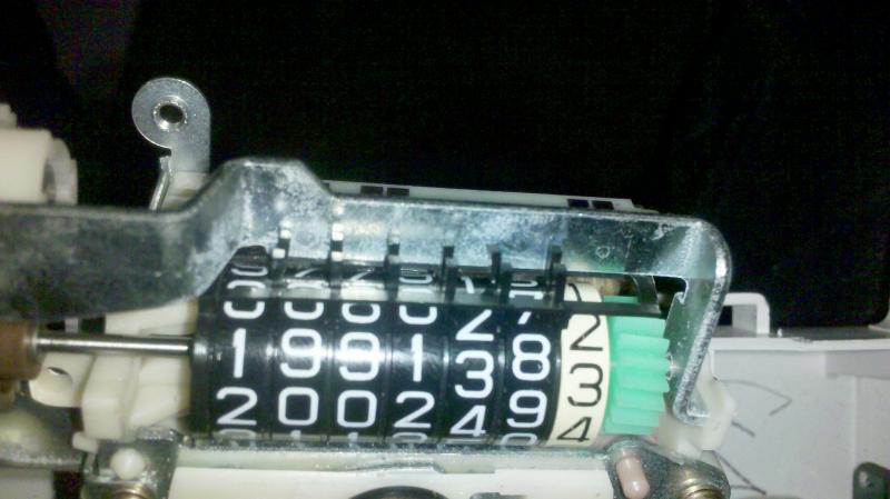

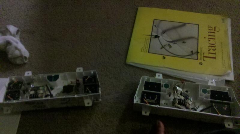

    Narrowly Avoided Tach Gauge Disaster... #closeone
    Ok, so first I tried to use the "drill in the speedo plug" method... clearly it would have taken a thousand years to add the number of miles I needed my ODO to show... Because I didn't want my grandchildren to be the first people to enjoy the new gauges, I decided to take the gauges apart and fix things that way... #really?!
    Long story short, I got to the point where I had taken both clusters apart to swap odos, I had taken the tach cluster odometer itself out and was trying to turn the numbers to match what I needed. I felt like I was in an Indiana Jones movie or I was trying to decipher an ancient stone mason's key... It was like a Rubix Cube gone bad...
    What's more, when I finally figured out how to set the numbers, and I got the odometer numbers back in the odometer housing, I missed one detail that made the numbers point down a little in the bezel, and I almost lost the "baby-small" retainer clip that holds the numbers in the housing. Gratefully my friend was here and eventually found it. (I was already going to the truck to try to swap the odo from the original cluster.) Seeing the old odo showed me how to align the new one though, had to take to small clip off again, but i learned from my mistakes and kept it close this time. (*note* friends don't let friends take apart small things on carpet)
    When I put everything back together this time, the numbers lined up, everything was properly adjusted and we were finally good to go. I put the gauges back in the truck, and when I was able to test drive, the numbers roll over as the should. (*I'm glad they didn't roll backwards, or have bigger numbers roll before smaller numbers)
    So, now the gauges are in and the numbers are true and I can put this chapter of the build to rest...#whew!
