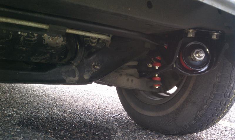

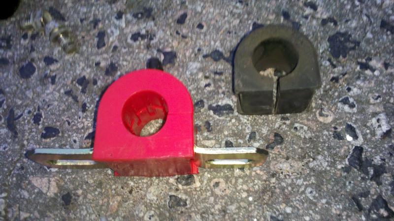

    It's been a couple of weeks now since I got my sway bar bushings installed. Energy Suspension Red. Had to use 45* grease nipples to clear strut rods, and had to grind the bracket wing edges down a bit to fit, but they make a noticeable difference in how neutral Max is through turns.

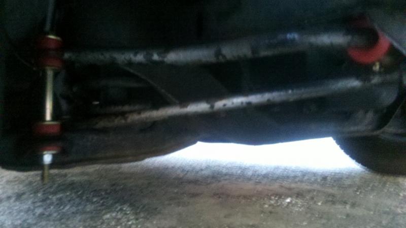

    I just installed the Energy Suspension Bushings as well. Have been worried about the sway bar link bolt that sticks down too far. It looks exactly like your picture. Any knowledge on this being correct?

    Quote Originally Posted by Cobra View Post
    Cut it or flip it over.
    Mine were pointed down and would rub on the inside of the rims while turning so I just flipped them the other way now the thread points up and the bolt head is flush with the lower control arm mount.

    I did all the front and rear bushings from Energy Suspensions in red.
    this shows where to trim the bushing bracket (I used bolt cutters, then smoothed the edges with a wire wheel)

    That's what mine looked like when I pulled them out. I did strut rod bushings also.
