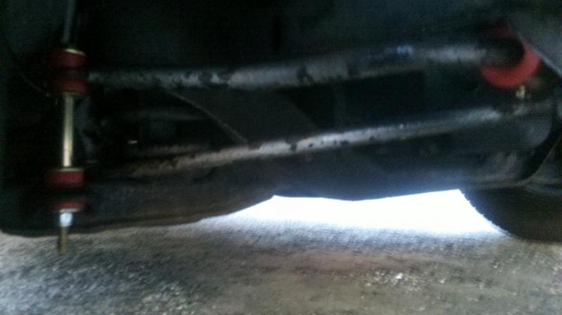

    It's been a couple of weeks now since I got my sway bar bushings installed. Energy Suspension Red. Had to use 45* grease nipples to clear strut rods, and had to grind the bracket wing edges down a bit to fit, but they make a noticeable difference in how neutral Max is through turns.
    Shout out to Kestner's Auto Repair on Broad River in Columbia. They did the installation (funny story) and engineered the mods needed to install the parts. Most importantly they did the job quickly and for a great price.
    I ordered the other bushings (Lower Control Arm, Leaf Spring, Strut Rod, Body Mount and Tie Rod End Boots), shocks, springs and blocks and hope to have it all installed within the next couple of weeks.

    I just installed the Energy Suspension Bushings as well. Have been worried about the sway bar link bolt that sticks down too far. It looks exactly like your picture. Any knowledge on this being correct?

    Cut it or flip it over.
    831
    Mine were pointed down and would rub on the inside of the rims while turning so I just flipped them the other way now the thread points up and the bolt head is flush with the lower control arm mount.

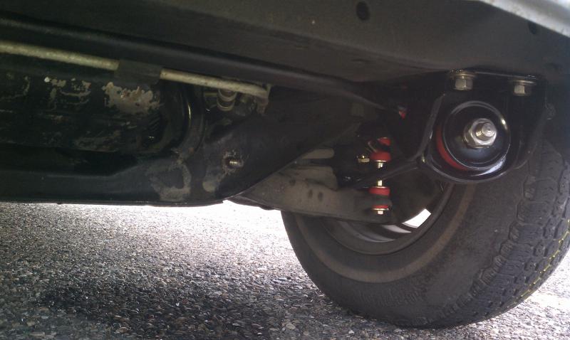

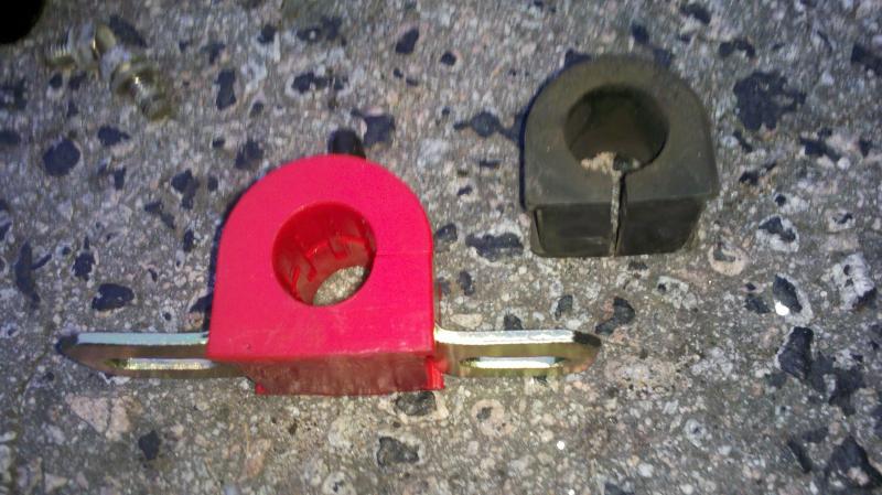

    I did all the front and rear bushings from Energy Suspensions in red.
    this shows where to trim the bushing bracket (I used bolt cutters, then smoothed the edges with a wire wheel)
    And I did the lower control arm bushings without removing the arms
    they needed to be done

    That's what mine looked like when I pulled them out. I did strut rod bushings also.

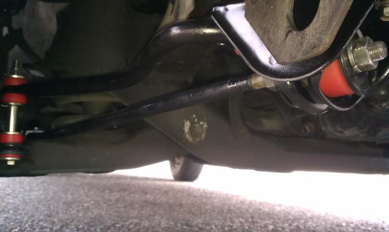

    Ok so here is the lowdown on part number for energy suspension from there tech support for our trucks. ENJOY!!!!
    1ea. 5.5101rx- SWAY BAR W/ END LINK SET(RED) - You will need to modify the sway bars brackets as pictured above and cut the round tube on the end links about a 1/4" to make up the difference for the extra lip on the bushings over the stock oem bushings.
    2PK. 9.13101R- TIE ROD END DUST COVERS(RED)- NO MODIFICATION
    1EA. 5.7102RX- STRUT ROD BUSHING SET(RED)- NO MODIFICATION
    1EA. 5.3102RX- CONTROL ARM BUSHING SET(RED)- NO MODIFICATION
    1EA. 5.2103RX- REAR LEAFSPRING BUSHING SET(RED)- NO MODOFICATION
    THis is what mine looks like after i did it this weekend!

    How exactly did you remove LCA bushings without taking spring off? I'm planning on replacing mine this weekend and wanted kinda of a step by step.
    I can see in the pic that you put a jack stand under the arm but did you have to disconnect anything else first? I can't tell if you removed lower ball joint? Any help will be appreciated as I already have the bushings and want to install without gambling with the spring compressor

    I did mine with the spring compressor, you can see the compressed spring in the pictures.
    And I didn't do any modification to the sway bar end links, everything fit together fine.
