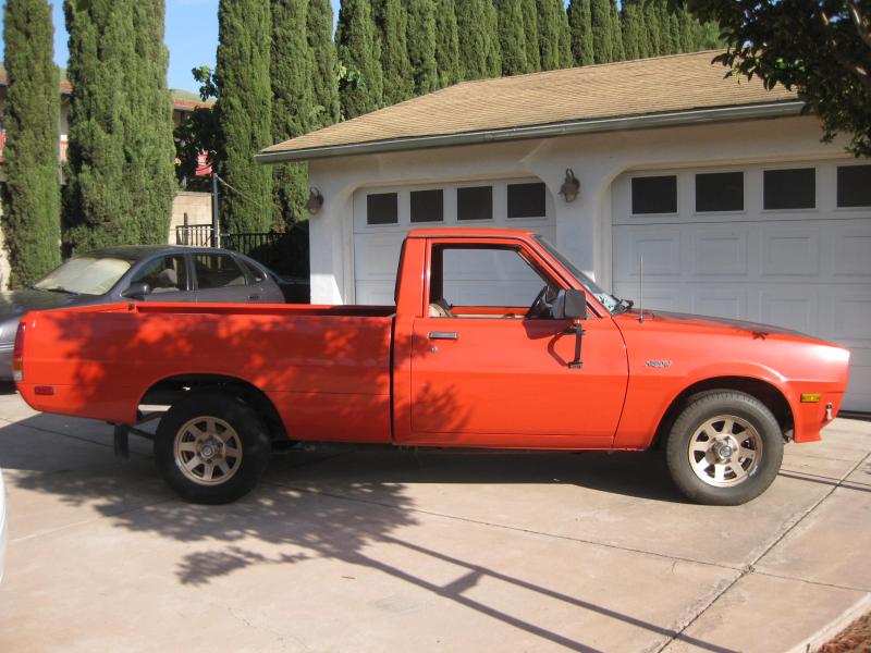

    Perhaps Scarlett could hang out with "INKA" ( i cannot think of a fitting name...so it "INKA" for now).IMG_0011.jpg

    IMG_0014.jpgPup Gold.jpgAww man my truck looks small compared to your....let see if I can get this right.

    ...let see if I can get this right.[/QUOTE]
    uhhhh maybe not.....goodnite
    You did it right, if you click on the picture it opens up bigger. Its actually better for the sitr and the thread page that way technically.
    Nice truck you have there, looks to be in dang good condition.

    Awww gee thanks......I got lucky ten years ago....now if only I can get me some stock wheels with orig chrome hub caps and beauty rings. Also would like to install bucket seats....I should have picked up the stuff when it was readily available in the wrecking yards back then. Now I cannot find any on the yards around my area (SF Bay Area in CA).
