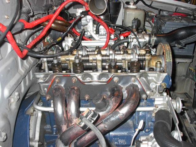

    You could still have a broken Rocker or bent valves. Been there, You should also change the balance shaft Belt too.
    Notice my #1 exhaust
    and that was at idle when it snapped.

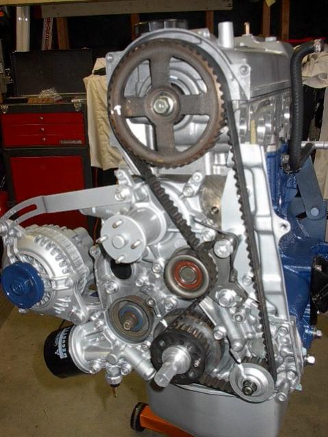

    Here are your timing marks
    And make sure you get the Balance Shaft on the drivers side in the correct position, the weighted side goes up. it's in the Manual.
