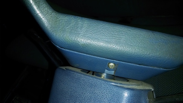

    So yesterday afternoon I decided to fix the horn. The first thing I did was check the wiring diagram. The D50 doesn’t use a horn relay, the horn has power anytime the key is on and the horn pad on the steering wheel is used to complete the circuit to ground. With no relay that left the wiring being shorted or the switch in the pad being bad. I figured the most likely culrprit was the horn pad, so I took that off first.
    To get the pad off the first step is turn the steering wheel upside down and removing the screw on the bottom.
    With the screw out, you press in on the bottom of the pad and rotate the bottom away from the steering wheel slightly, then pull the pad toward you to release the clips that hold the top of the steering wheel. Unplug the wire and the pad is free.
