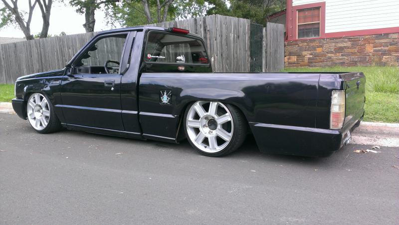

18" Caddy Alloys on 215/35-18 tires
Looks good.
I have blank center caps, I just don't always run with them. Trying to keep them clean.
