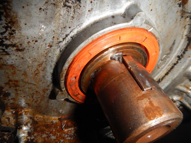

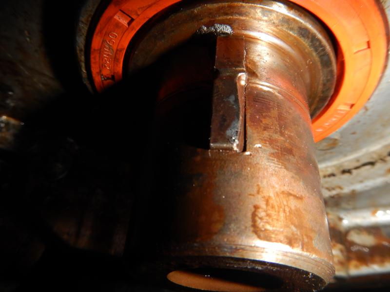

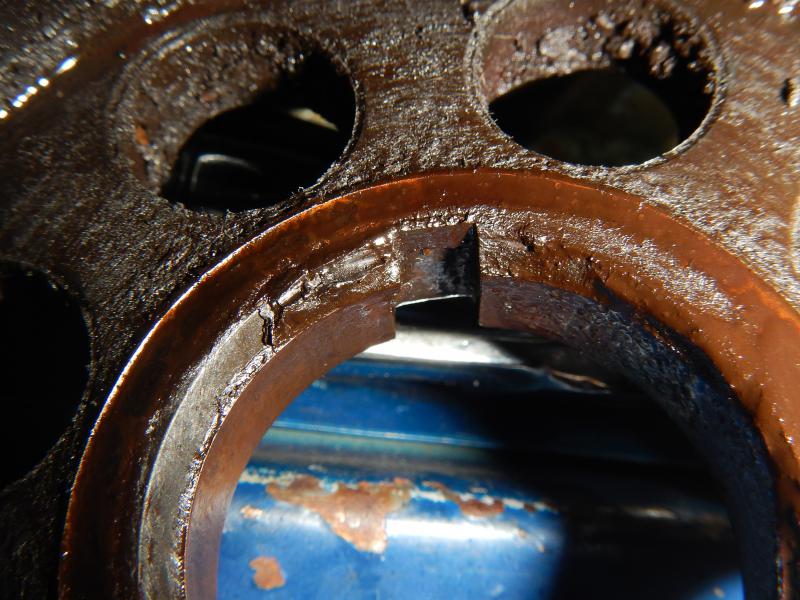

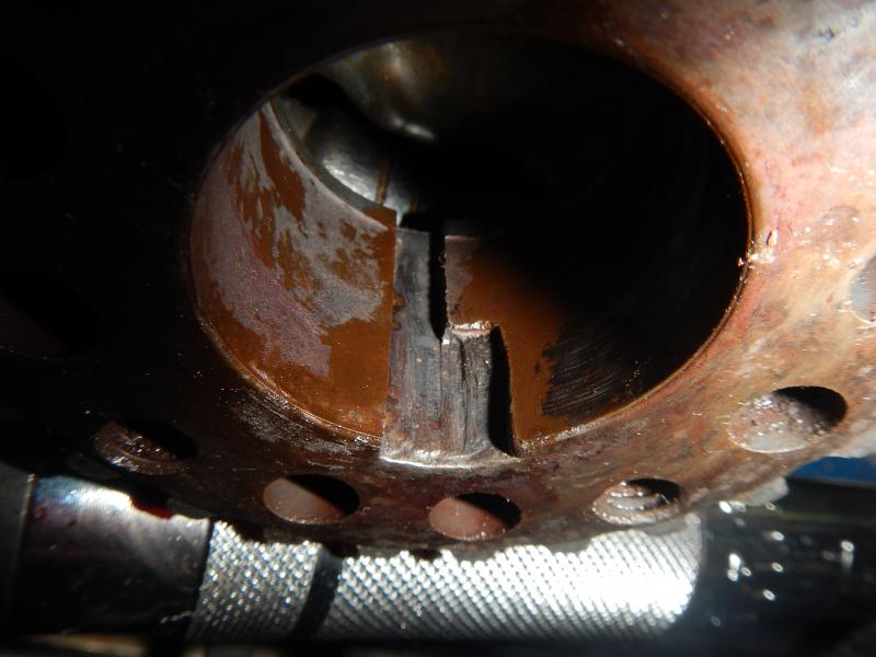

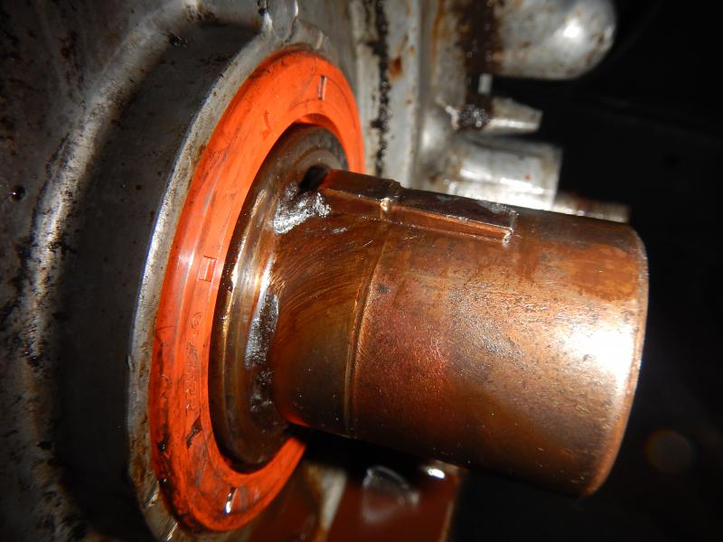

Ok long story short noticed one day my truck was very weak it basically had no power and I had no idea what was wrong with it. Did a compression test and got low readings across the board 75-80 PSI. Also notice a little bit of engine oil in the rad. Popped the head off head gasket was blown. So here is the next problem I run into. I noticed while cleaning the crank sprocket they the area were the woodruff rides was missing a chunk (also realized this is why my truck was acting weird timing was thrown off and why compression was low on all cylinders). Also noticed the the woodruff key is also missing a chunk. Posted some pictures of the woodruff key, crank sprocket, and balance shaft sprocket. Wanted to know if anyone had these items for sale or if anyone knows were I can find this stuff. Also the woodruff key looks like it can be removed but unsure. Any help would be great.
Attachment 11977Attachment 11978Attachment 11979Attachment 11980Attachment 11981
