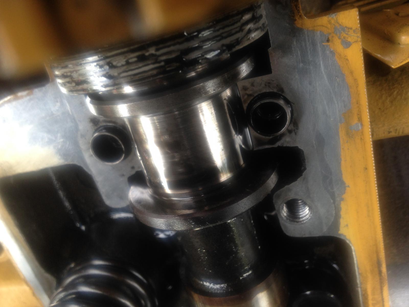

Cam sprocket is off time by 8 teeth. Injection pump is on time. I go to manual turn the engine 360 degrees. I hit a hard spot.

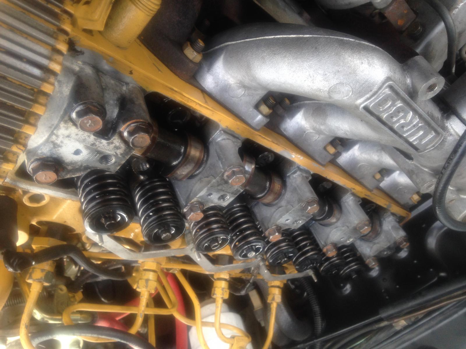

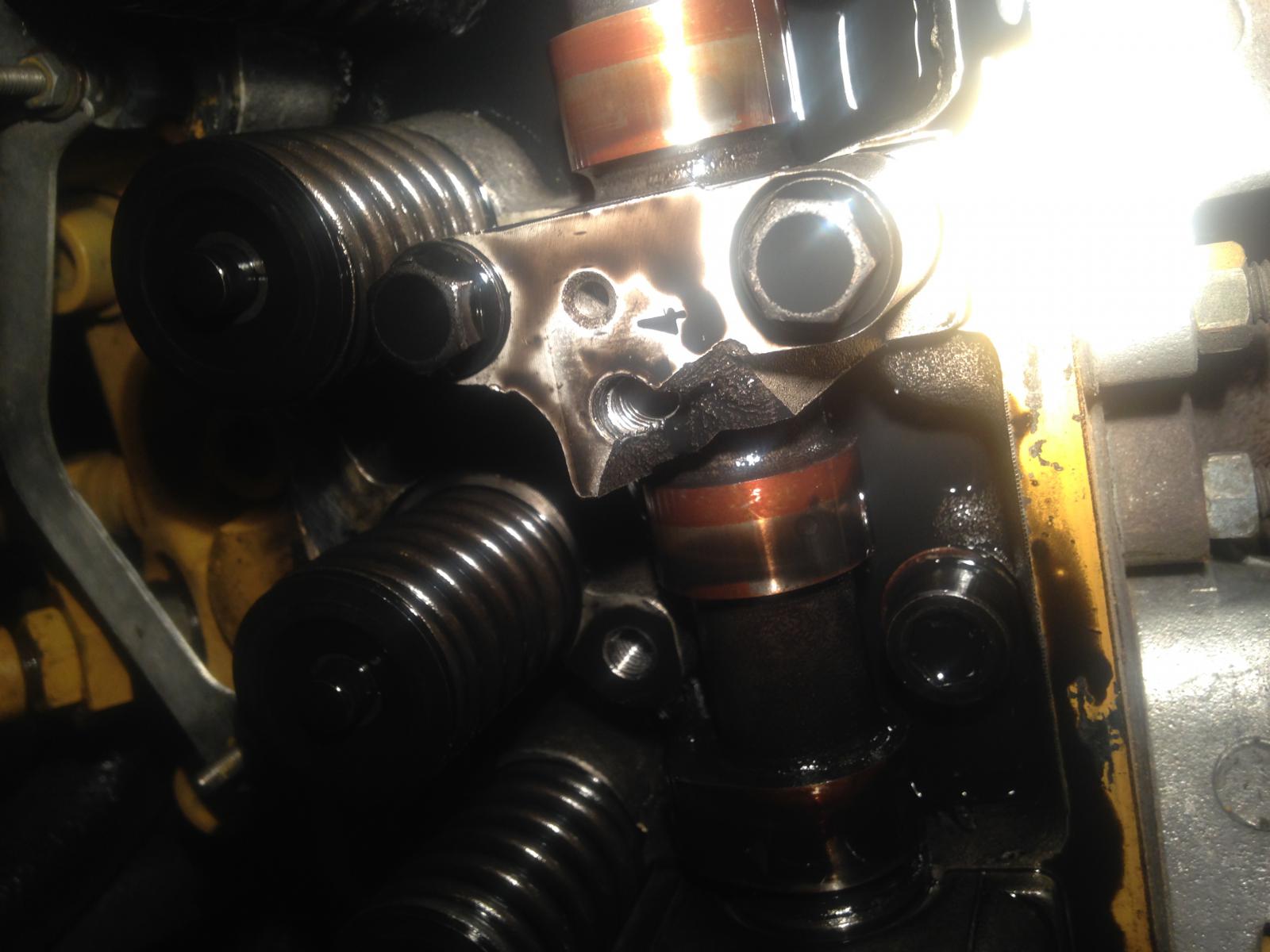

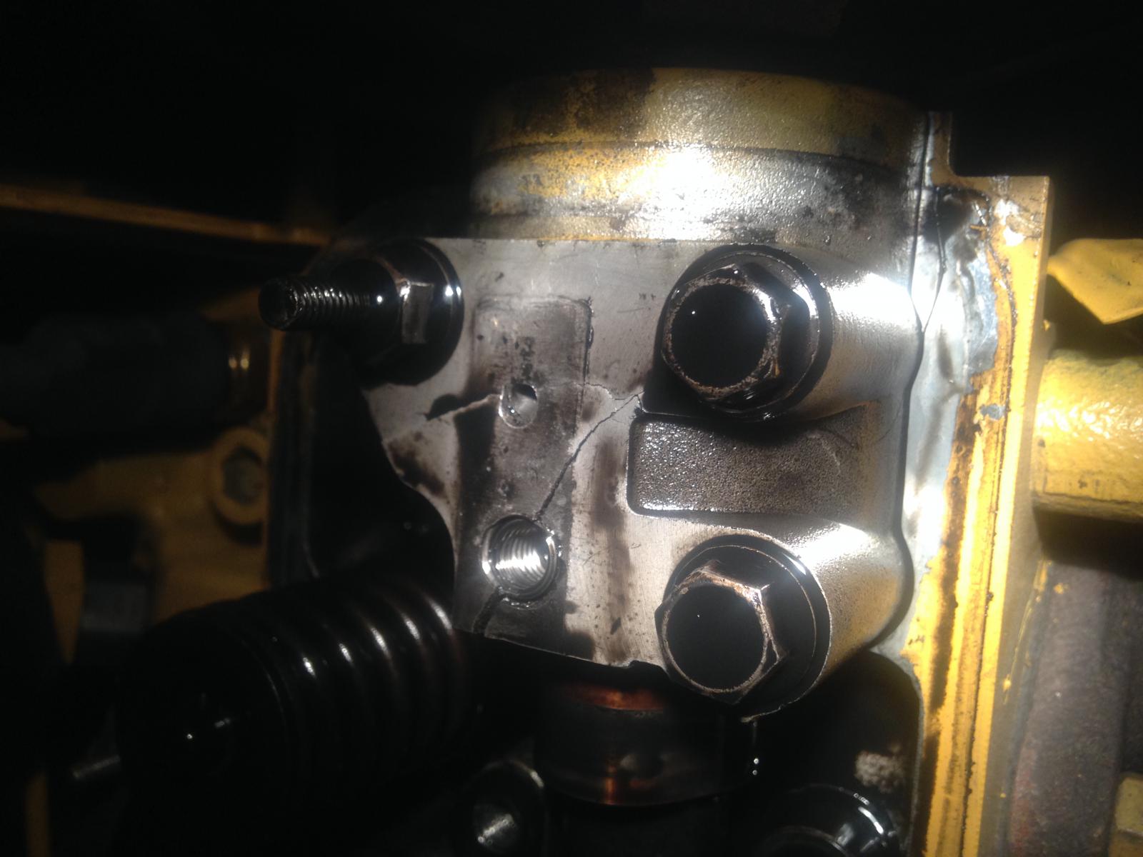

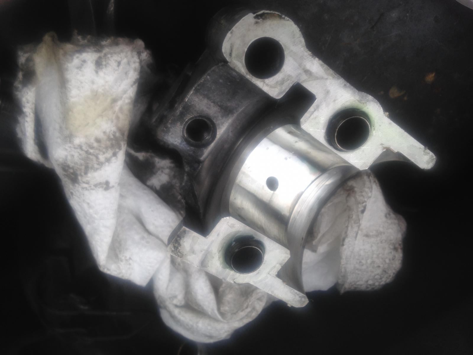

I then remove the valve cover and begin to inspect. Cam cap 1 (very front with three bolts) and 4 (1 before the back) are cracked around the threaded portion for mounting the rocker arms.

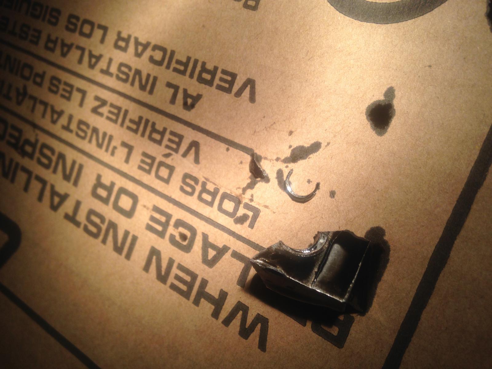

i remove the rocker arms by loosening the adjusters screws, then the mounting bolts, and remove a chunk of cap #4. I try to rotate the engine, it cycles and turns smooth.

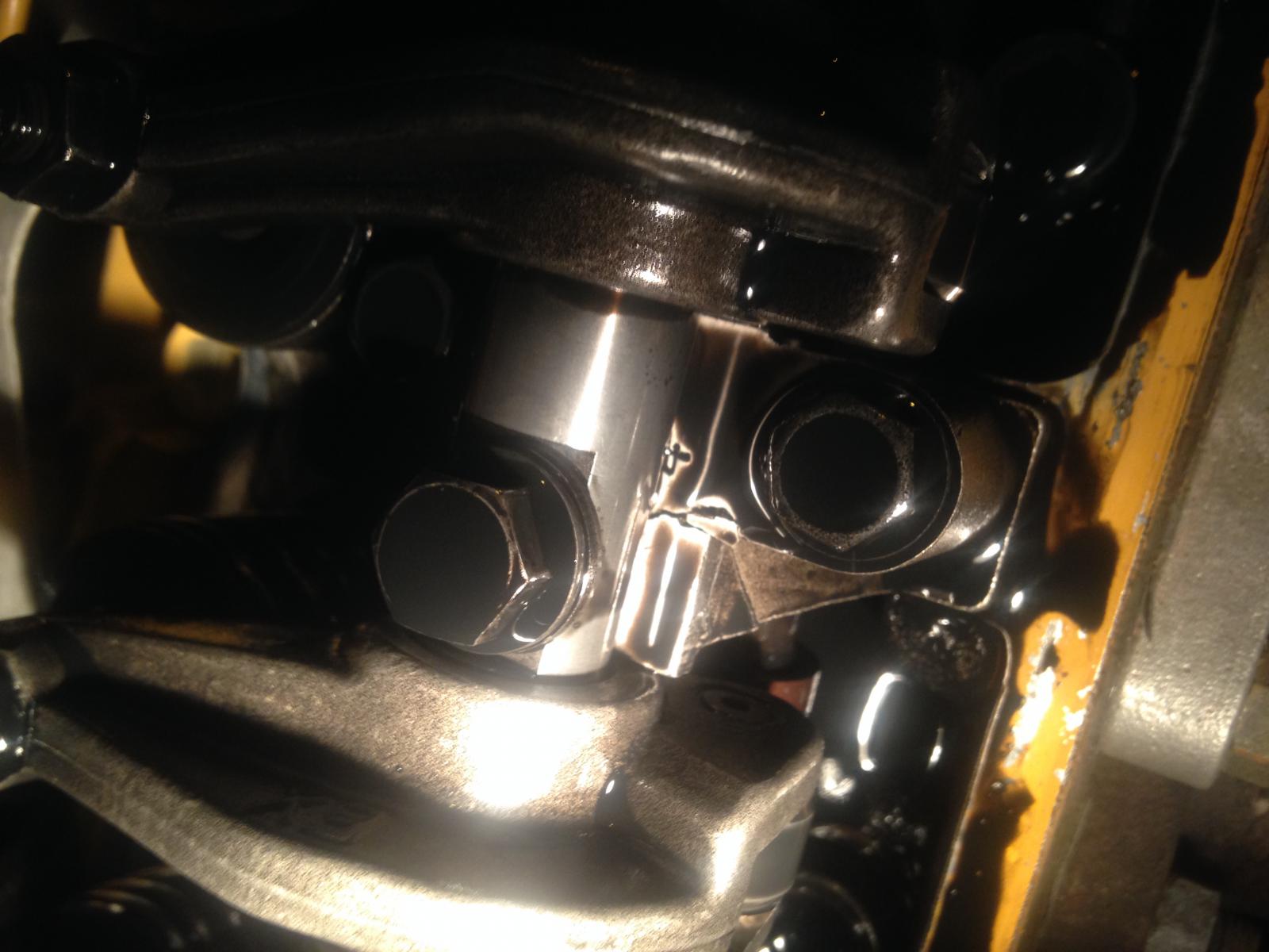

i got the caps (note: I already had the rocker arm from this truck in spare parts, my buddy had pulled it preemptively before selling me the truck) Saturday and pulled off all of the old ones. When doing so I found the likely source of the breakdown. Cap #2 had been stripped on the rocker arm mount creating play. The caps we pulled all had the hollow dowl on the caps, and all of them had been left in the engine from caps I pulled. I used needle nose vice grips and carefully twisty pulled them out.
i then lubed up each cap and put them on in order, setting them with a rubber mallet then prepping the bolts with anti-seize lube and hand tightening them to snug. Then set my torque wrench to 14ft lbs and cranked them down to specs.

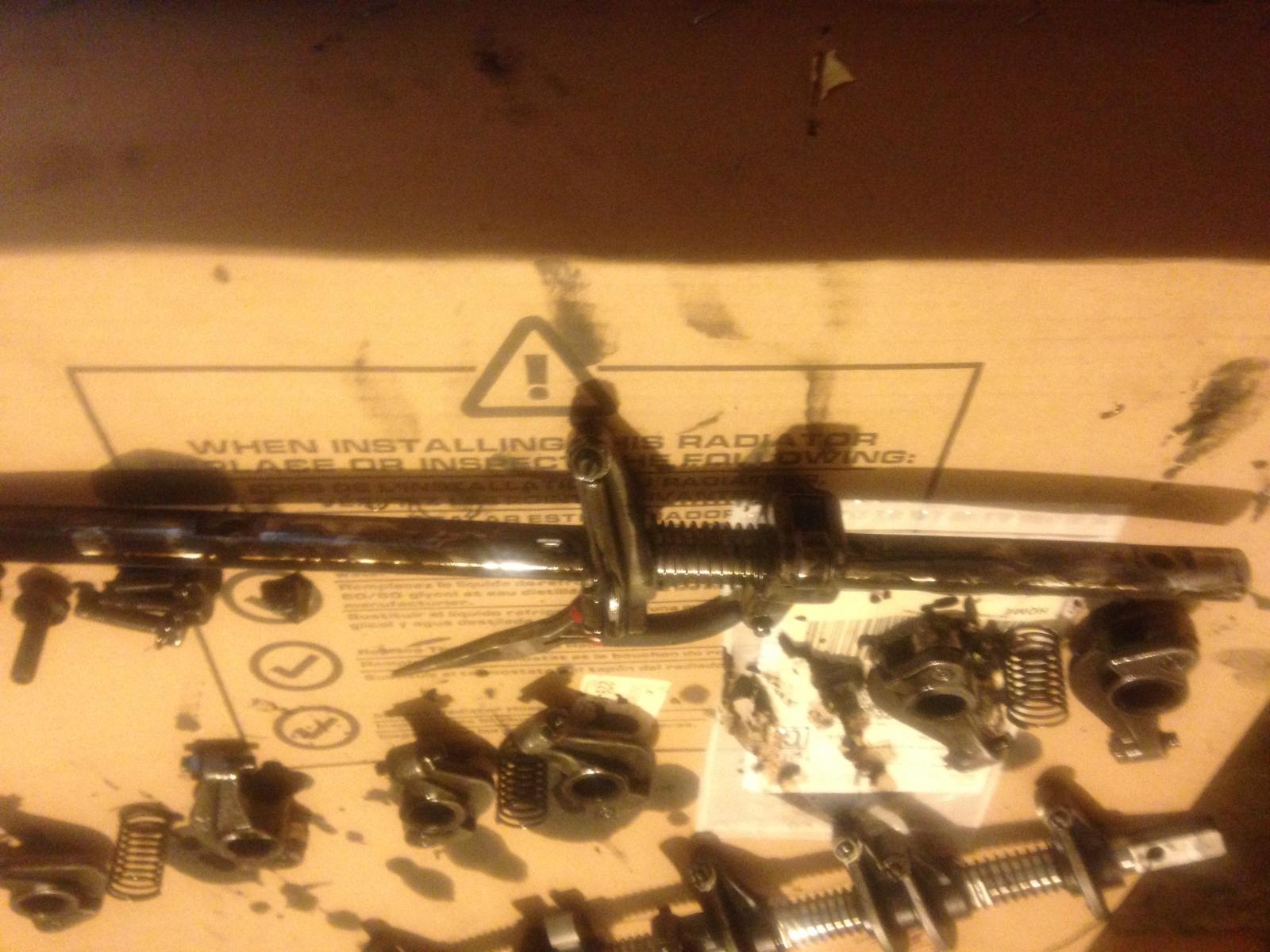

The one I pulled off the truck seemed fine till I got to the middle two rockers. Major resistance in either direction when attempting to remove them. My suspicions were confirmed, the incident had bent it. I put the rockers and springs back on in order and wrapped the bent shaft in paper towels for parts storage.

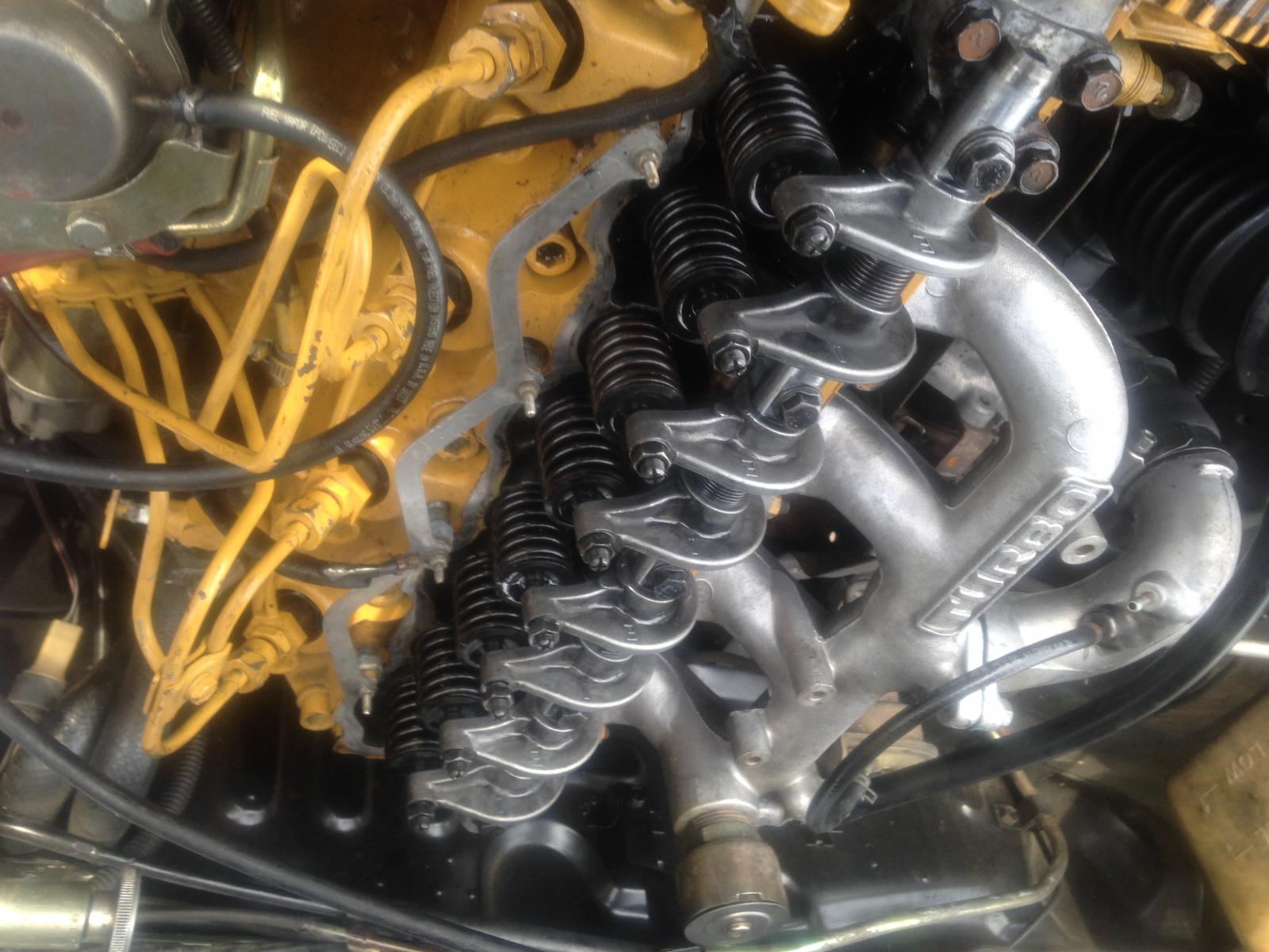

The other shaft and rockers seemed to be in great shape, I cleaned them well with brake cleaner and began to live the shaft and arms and place them back on in order.
I took it out to the truck and set in place and worked my wa down positioning the arms and setting the shaft. I had to back off the set screws as I went to get a perfectly flat connection. I used anti seize on the mounting bolts and hand tightened to snug. I then set the torque wrench to 26ft lbs and tightened to specs.
