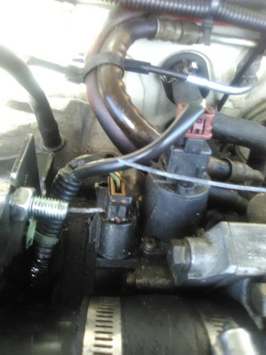

Issue solved found a loom of wires that run to the tps and ignition control module grounding out on one of this metal wire hangers. Seemed it had rubbed it's rubber coating off and made its way into a couple of wires. But here's a photo anyway.Attachment 21771Attachment 21771
Hopefully that is the end of that issue. I have to ask - what is that broken cable in the foreground of the pic? Cruise control, kickdown...?
Not a broken cable I think what you are seeing is another one of those bendy metal wire tie things with the glare if the sun
