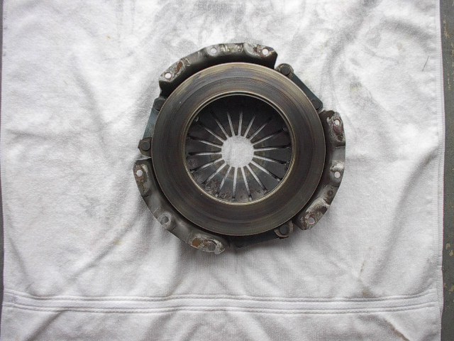

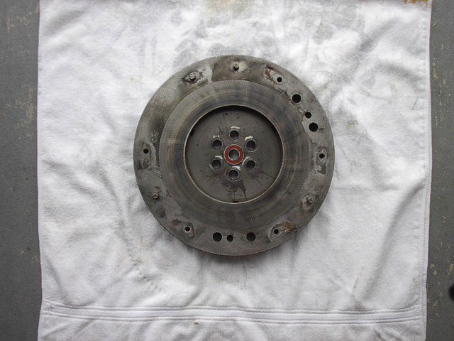

Will clutch replacing require flywheel grinding?
you should have the flywheel surfaced, look for burned/hot spots.

Attachment 20283
Attachment 20284
It's normally the done thing as it's all apart already. Most clutch places will do it for free if you buy the rest from them
Friend of mine has had 2 flywheels overheat and crack through the crank mounting bolts. Scary...
