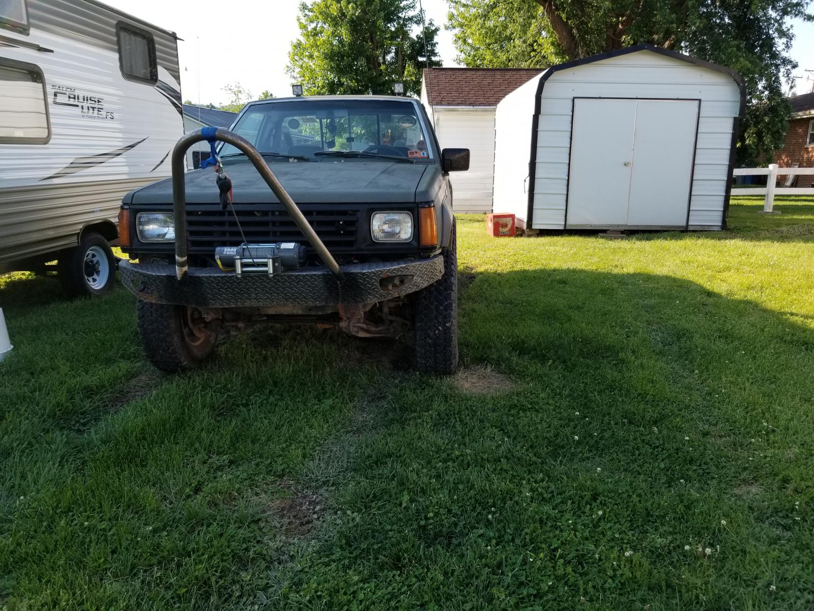

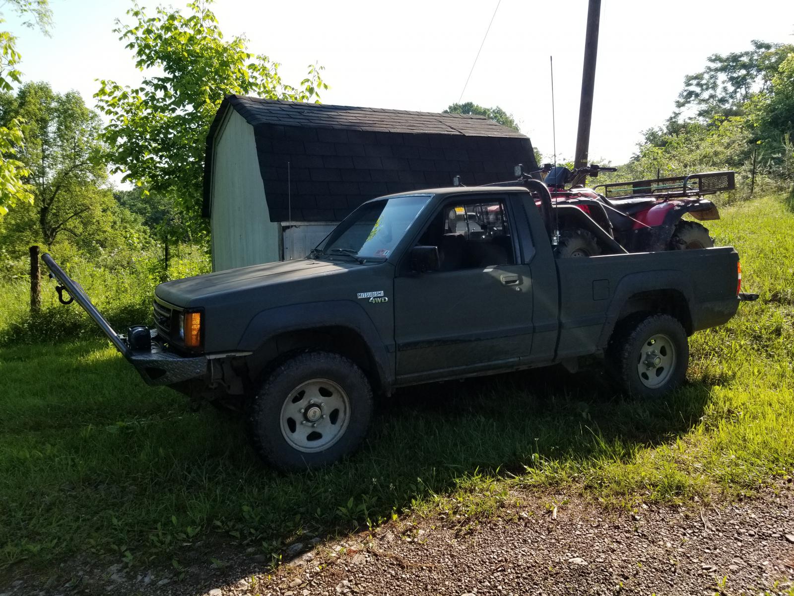

Gave the ole junker a workout today. Hauled a 4 wheeler to the farm and added some wheel spacers.

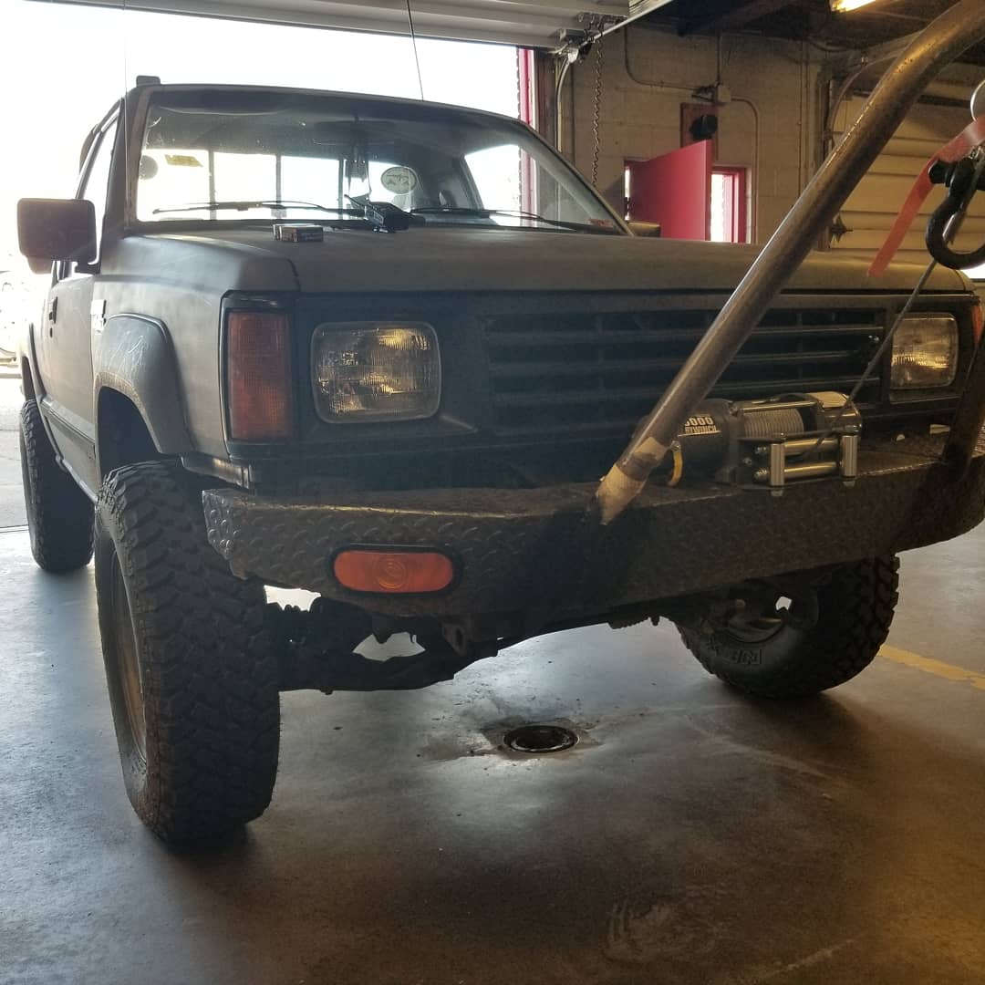

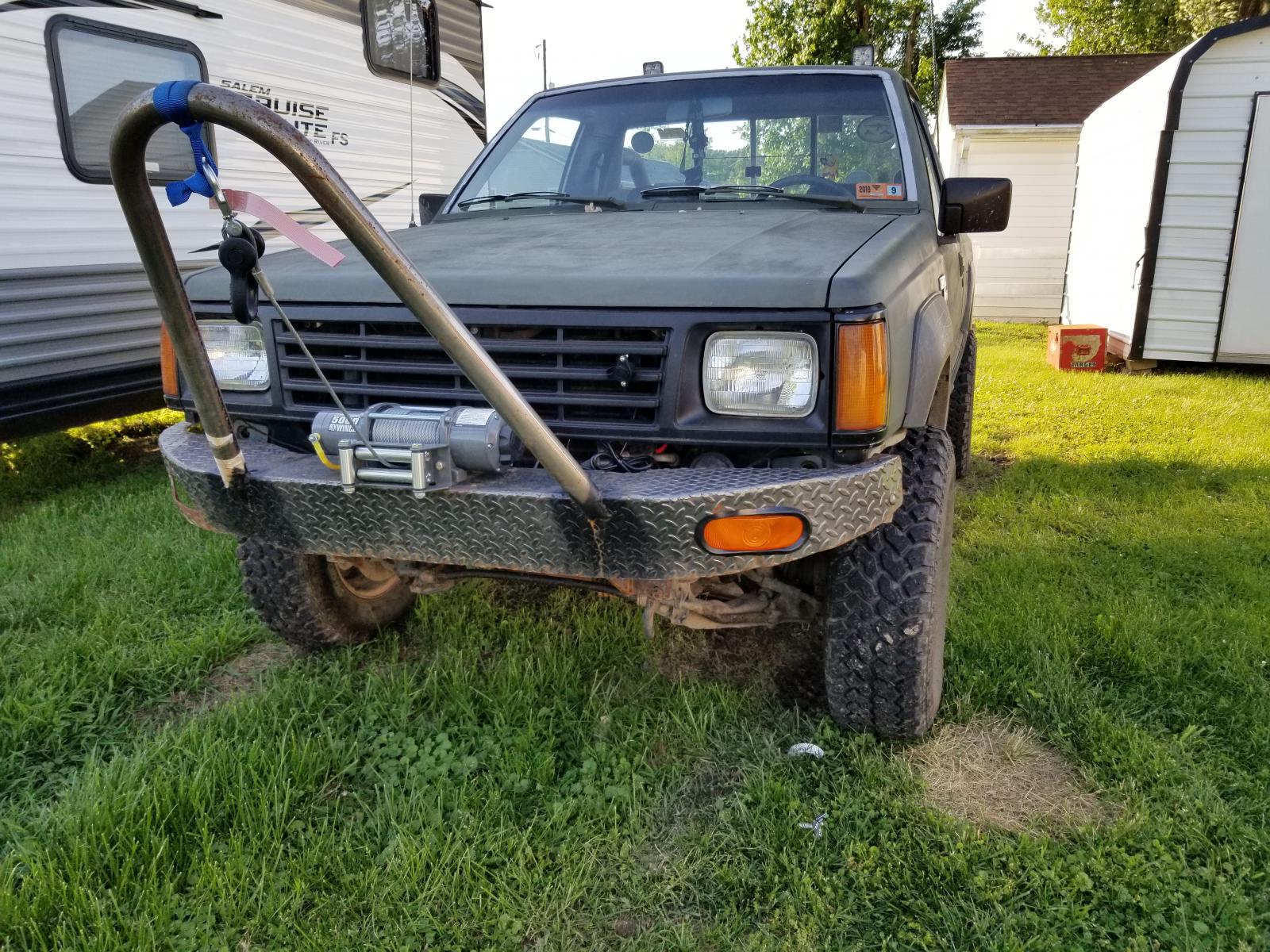

Been running with no front turn signals for a while figured I better get legal before I recieved a driving award.

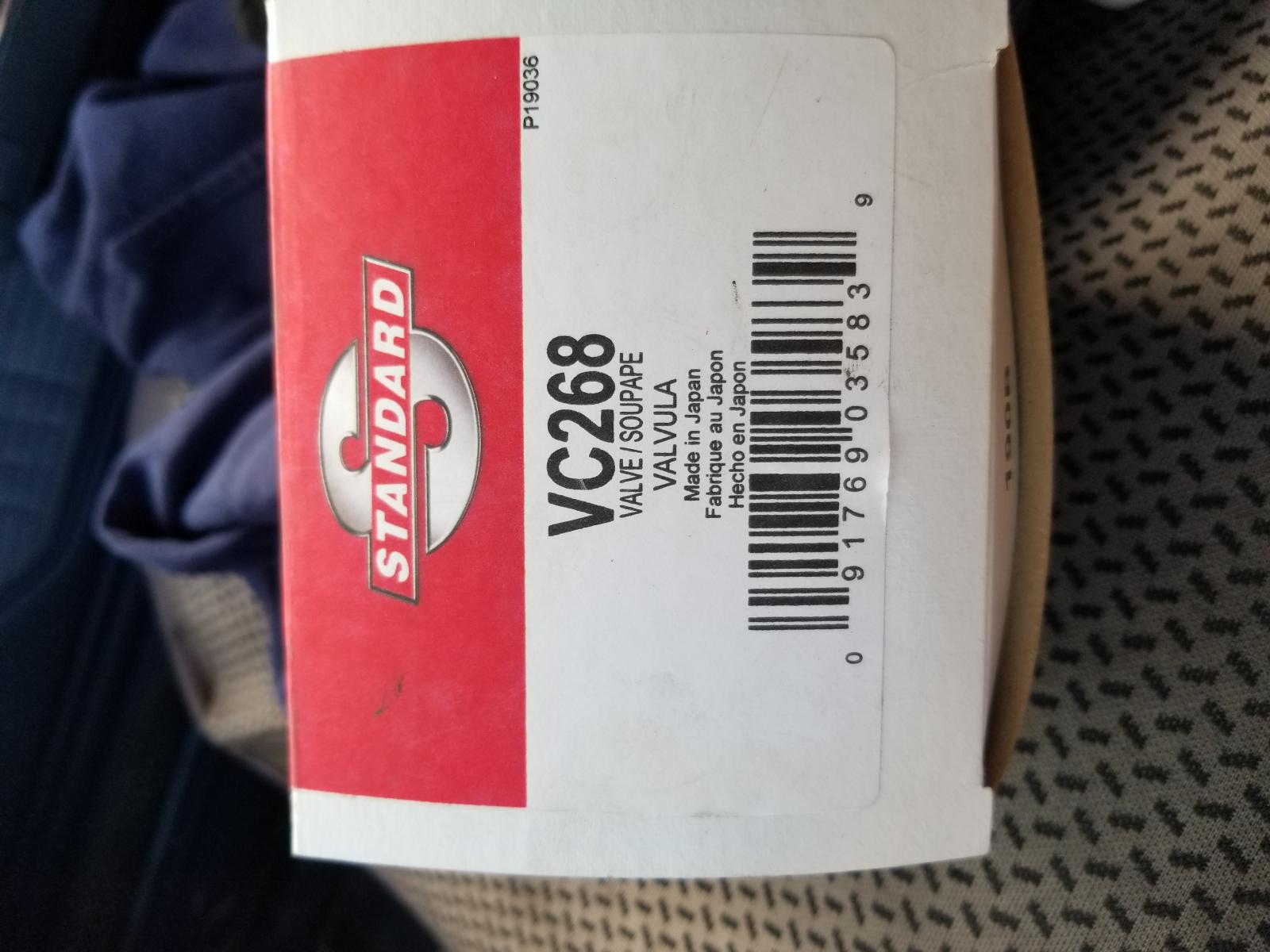

Finally got around to swapping out the vacuum advance valve so far it seems to have helped. I can run it up to 3-4k rpm and not lean out and feels like it has more power. I still might change a few jets in the carb to help with around 4500 rpm it gets lean.

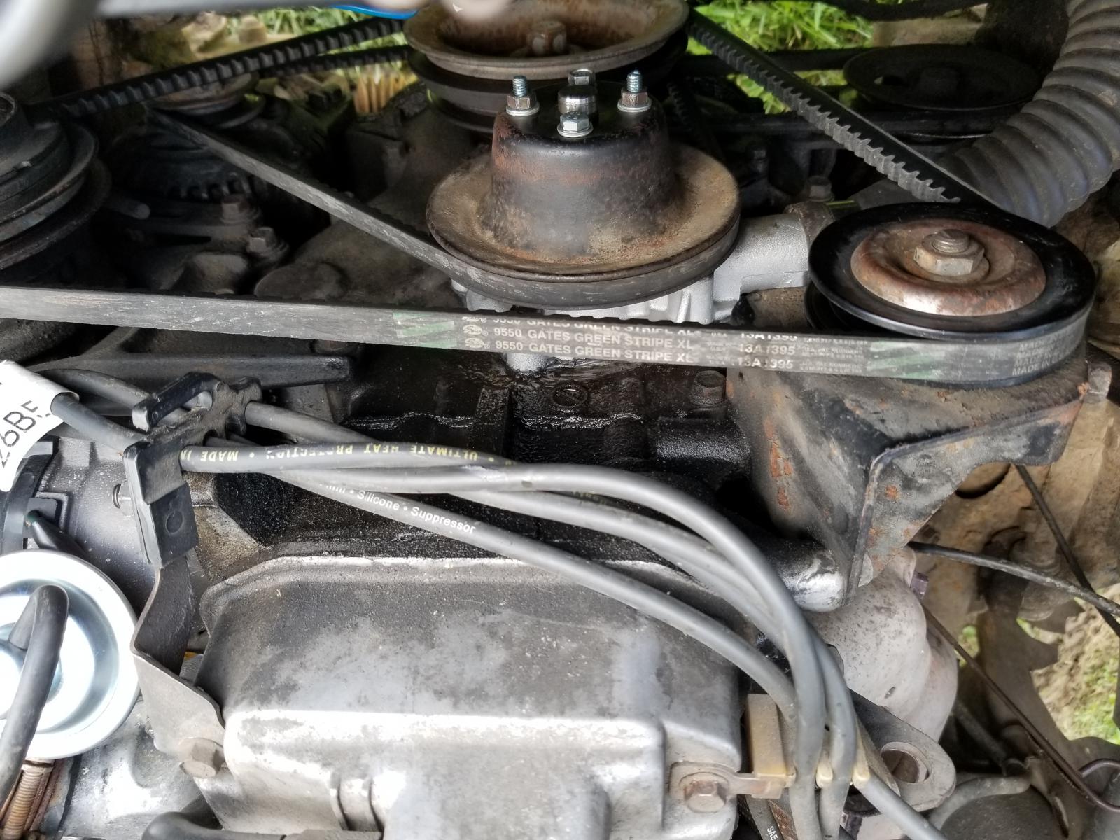

Finally got around to the water pump as well. Old pump seemed ok. I tried to get the impeller to spin on the shaft but it wouldn't budge but I went ahead and installed the new one. Took it slow out a back road it never got excessively hot. So fingers crossed it will stay cool now.

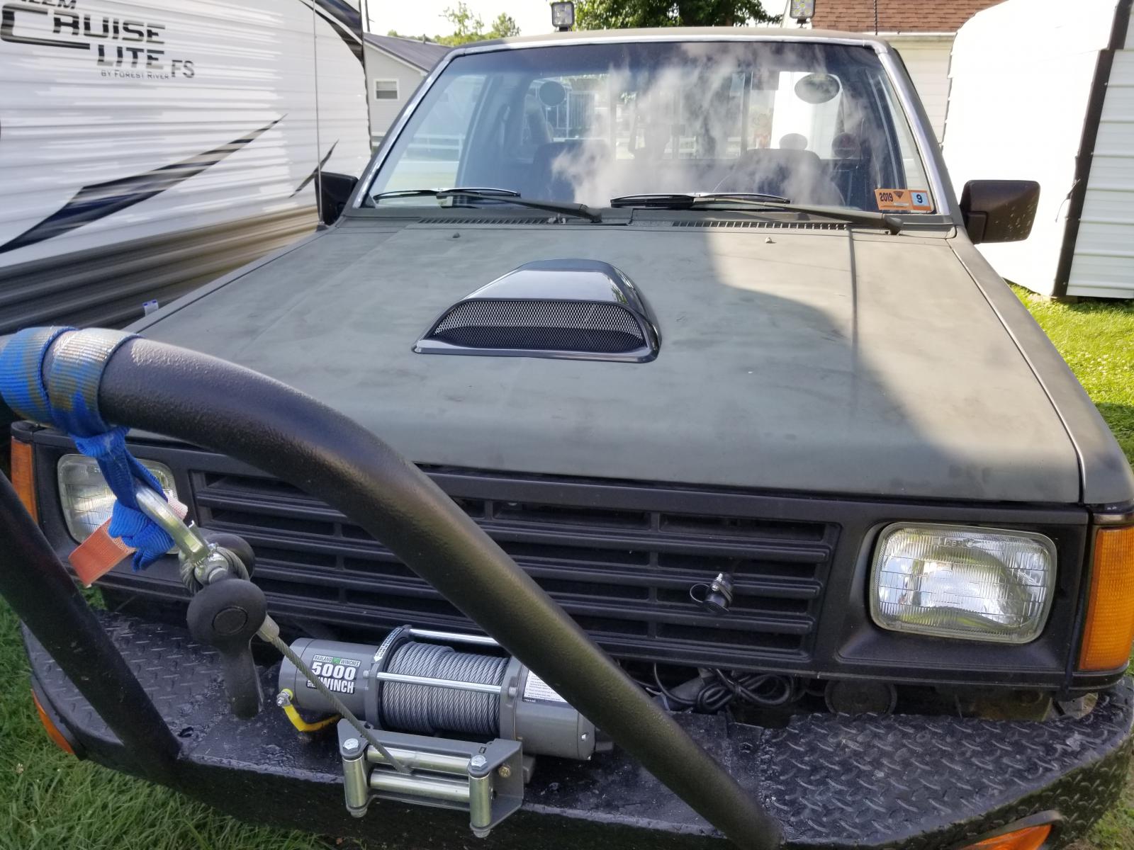

Cheapo hood scoops are cool right? Either way the deed is done holes and all.
I was thinking about doing something similar but having it reversed so it acts like a vent rather than a scoop over the exhaust side of the engine to reduce heat soak. The problem is the lack of spare parts for Gen 1's. Chopping up a decent hood is blasphemy...
