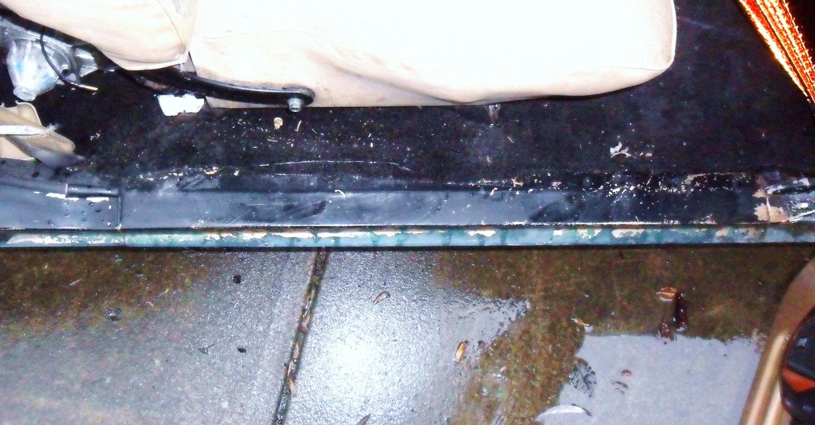

Is there supposed to be a thresh hold on the rocker to make sure water drains out and not in from the bottom of the door? I think the wet floor is from the door drains draining inward.
There should be drain holes somewhere in the forward area of the rocker sills (notorious for rotting out). Might need to poke around or even attempt to flush out the drain channels if you can.

Mine are smooth. I figure the intent is that the water drain out by gravity. See pic It was just an idea in hopes of solving the wet floor problem.

There's a plastic threshold that should be on there. It works with the door seal, so that's part of the problem...unless the 85's didn't have them. I'm no expert on first generations.
If it has rubber floor covering, there are no thresholds - my 86 custom doesn't have them, and it has rubber floor cover.

If the plastic threshold you guys are referring to is the scuff trim that sits across the top of the rocker sill, not all of the gen 1's had them. My truck had all the plastic cab trim in it from factory but the donor wreck I bought doesn't have the plastic trim, a tacho, the digital clock, centre console or the tilt adjust steering column in it. Looks like the base models got vinyl door trims, rubber floor mats and a whole lot of not much else.

I know I posted the info on here but apparently I did not post it in this thread. I had the windshield done with the new rubber and I cleaned out the bottom of both fenders which is apparently where the stuff that gets into the cowl goes. Once that drain path is plugged up water sits until it finds a path into the cab. So it's a couple of 10mm bolts at the bottom of the fender by the door and a couple to release it from the wheel well protector to pull it out enough to bang the gunk out. Since I did both no water in the cab. I got rid of the carpet and liner I had in there as it was wet.
