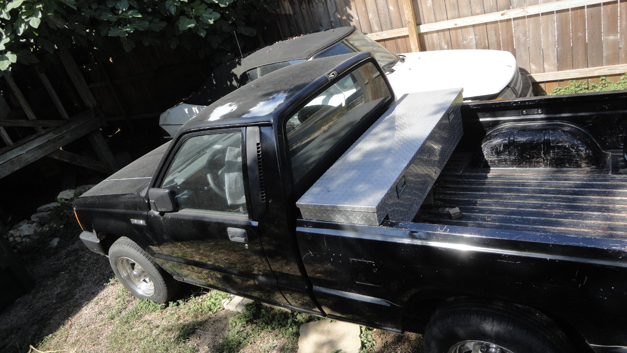

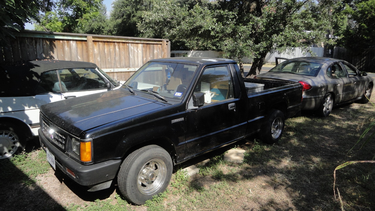

My new (old) 1992 Mitsubushi Mighty Max
Hello to all folks on these forums.

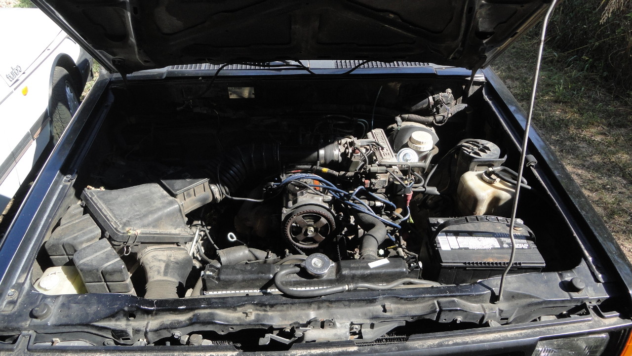

I found a 1992 Mitsubishi Mighty Max, 2.4 4 cylinder 5 speed manual trans late last year. Seemed to run pretty strong when I got it and drove it for 150 miles from where I bought it to where I live. About 20 or so miles before I got home the "Maintenance Soon" light came on, not the "Check Engine" light. Parked at a packing lot and checked what I could at that time, not finding anything I started the motor back up without any new issues and drove home.
Few days there after and some other checks further, still not being able to find anything. I started the truck and neither lights came one, aside from them lighting up to show they still work. Drove her to work and back, I did toss in injector cleaner on the way home which seemed to have caused something just before hitting the high way and soon there after then engine seemed to run fine again and took me home without issues.
Went to pick up my son from work in the weekend and she barely started, it being down hill to where he works went all right but after that climbing back up hill was a mess and felt like she would not make more then 300 RPM and stuttering horribly. There not being a tacko on these truck I have no idea what the RPMs really where, just that is was very bumpy getting back up hill on a smooth road.
Now about 8 months later my little truck is still parked in the back of the drive way still not really running.

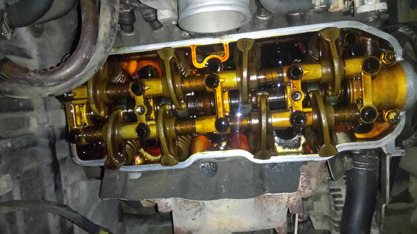

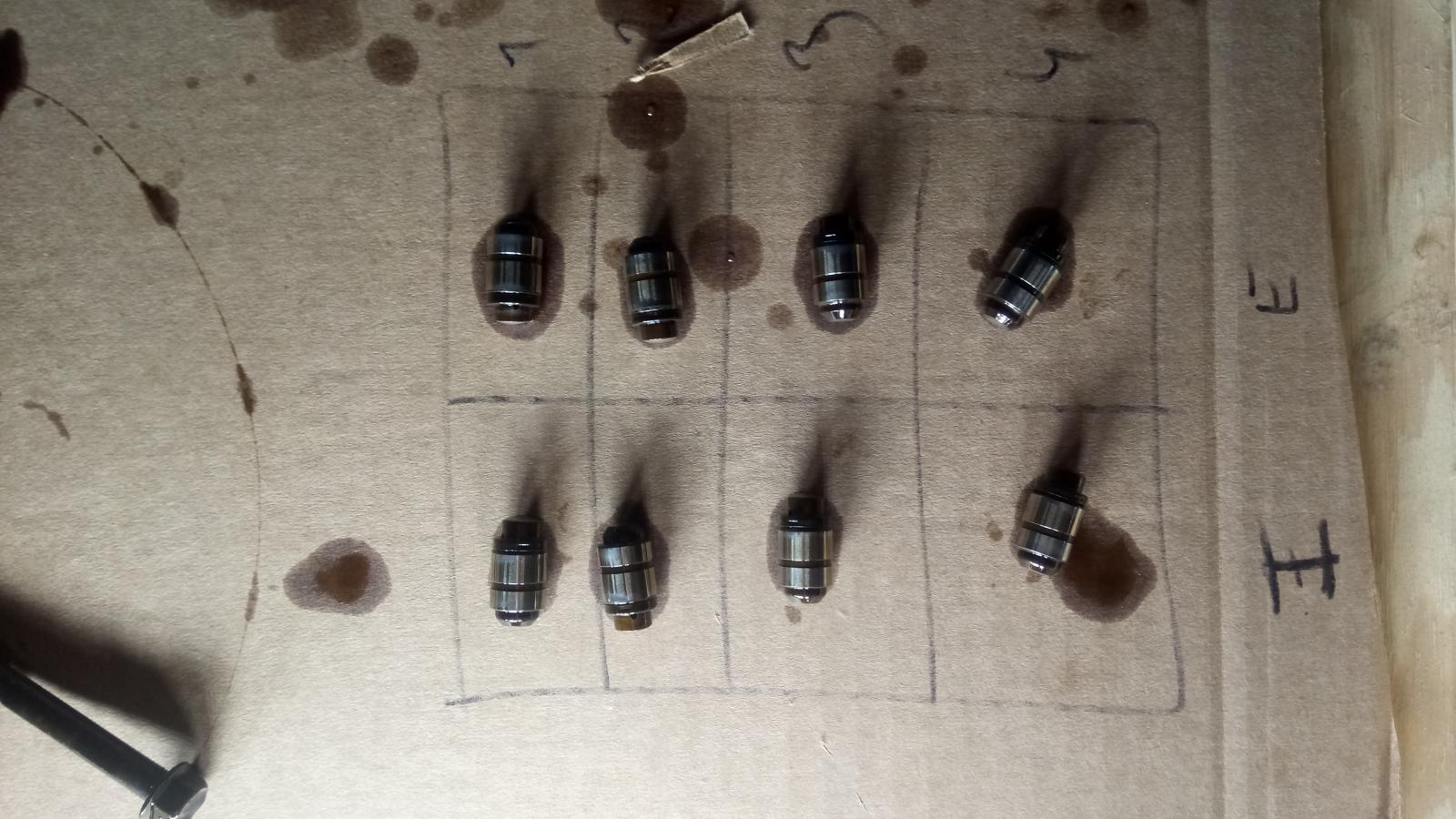

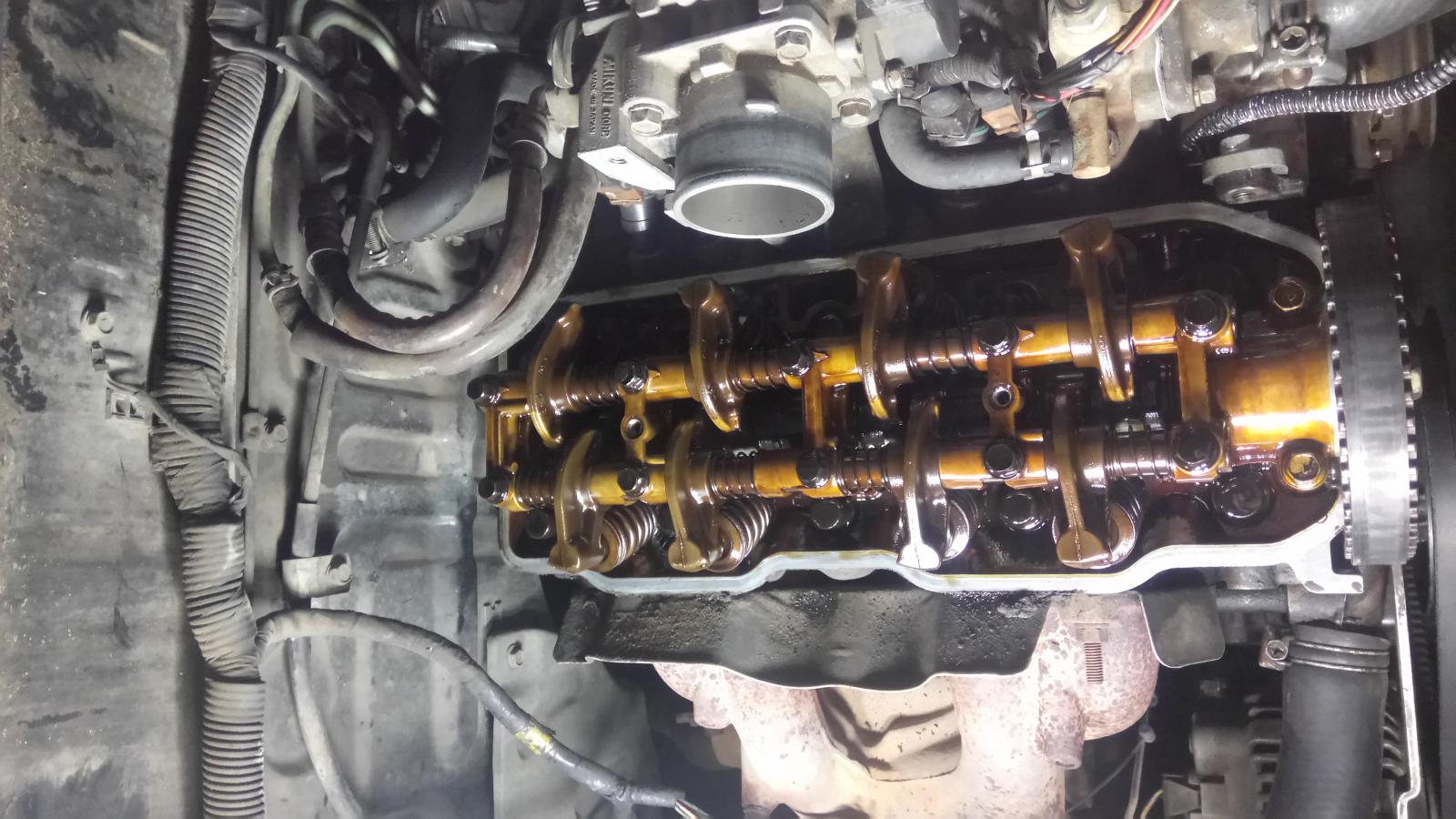

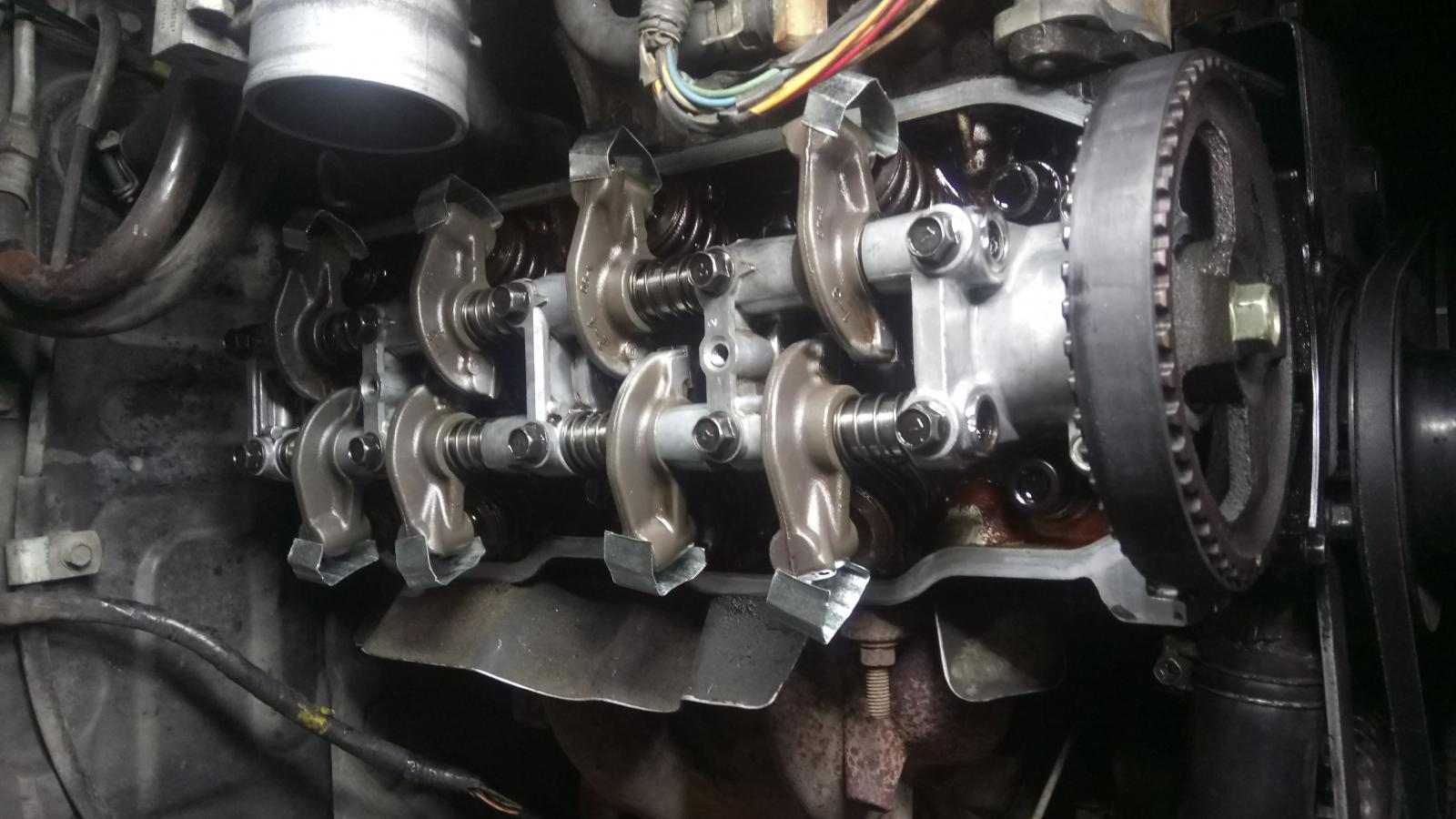

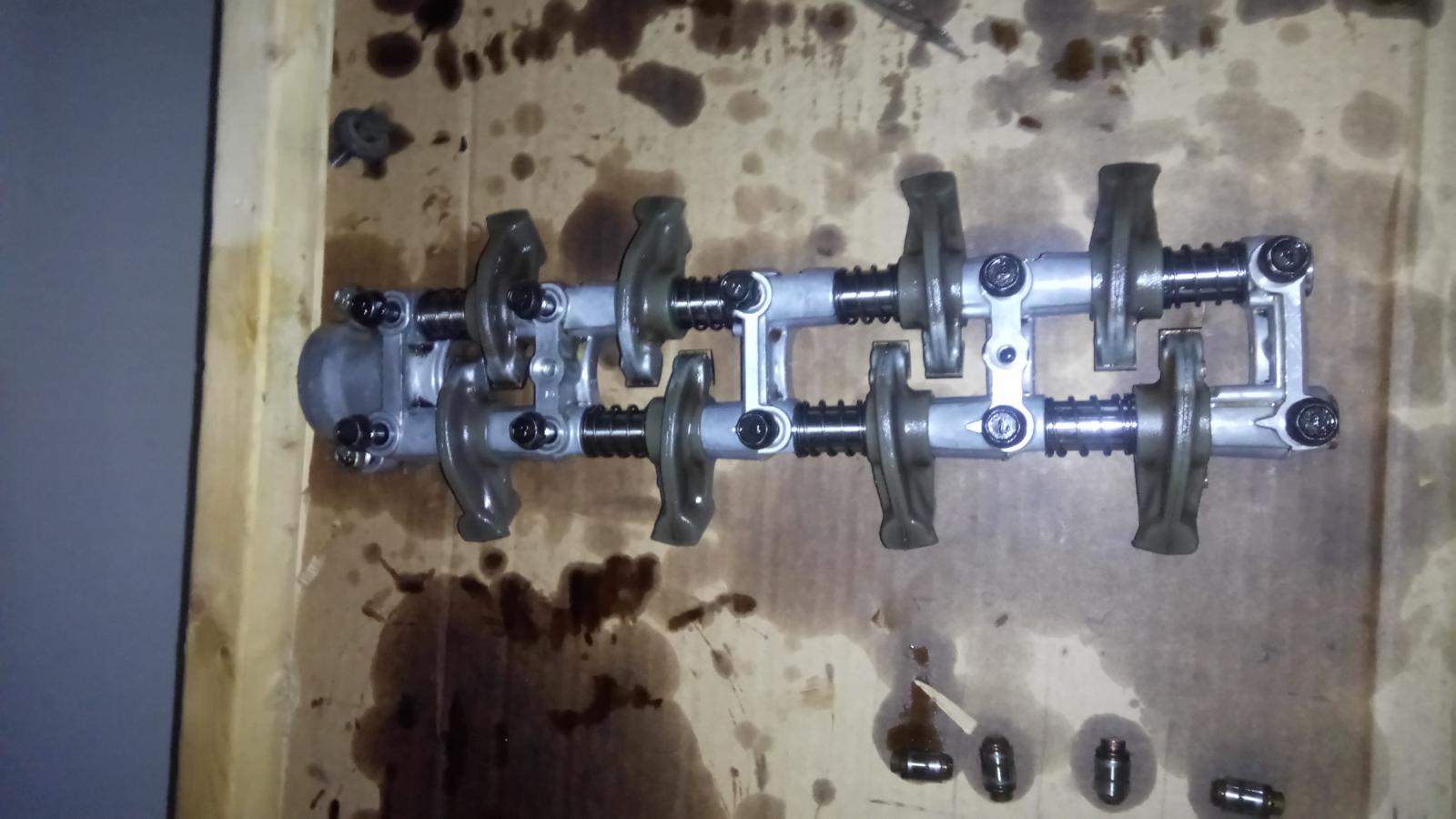

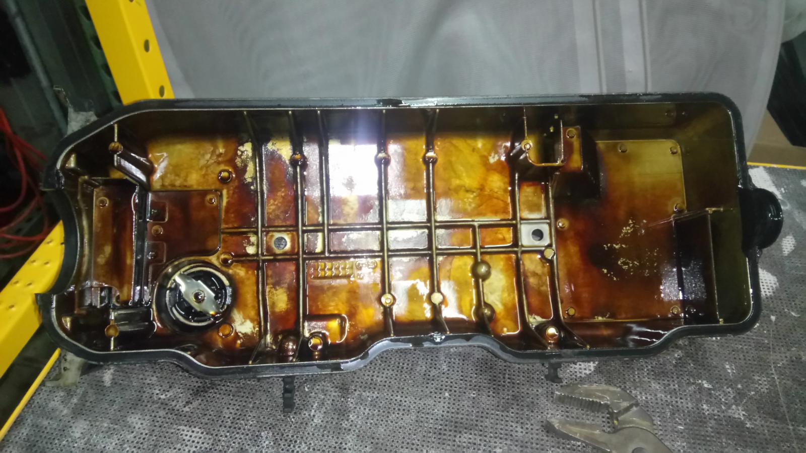

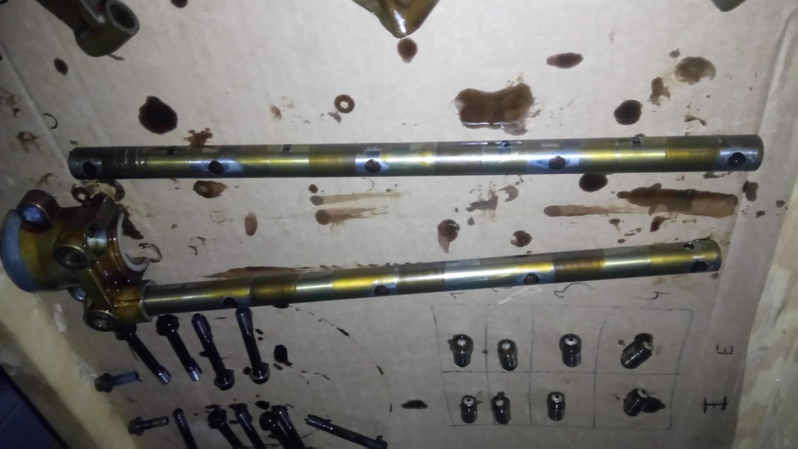

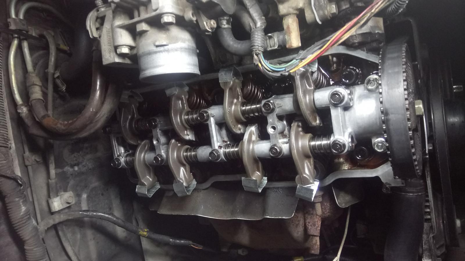

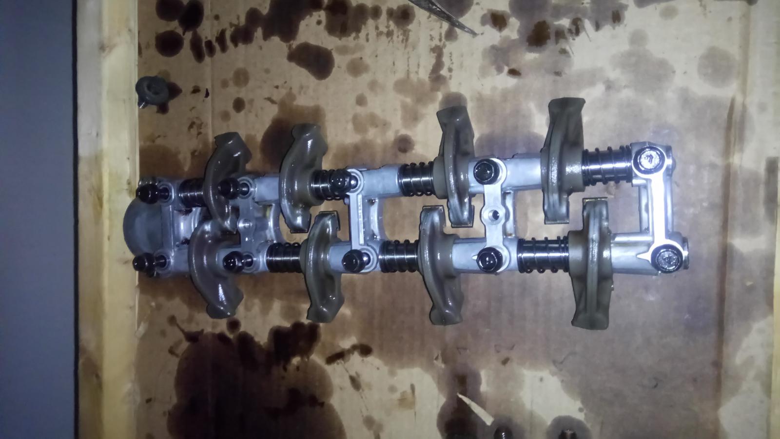

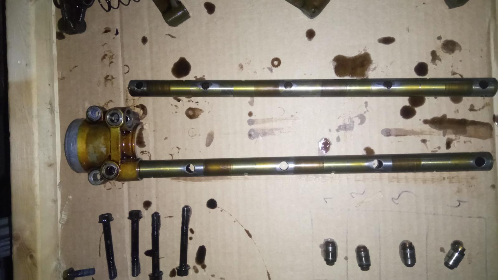

Lash adjusters checking and valve area cleaning
Hello Folks,
I am still alive and going, my little truck is still taking me places too. I was able to find some time somewhere in the past month or so to take the valve cover off. The lash adjusters are causing knocking sounds so I figured I need to check that.
Not too difficult of a task to do. Putting it back together without anything to hold the adjusters though, .....
Its got a nice oil coating stuck to the case, some of it may also have been from the engine overhearing when I ripped the belt.
Some of them adjusters are definatly worn, order for a whole new set is placed ( came in now but has not yet been installed ). At the time though, I cleaned the whole top and items around it that I had easy access to and was able to remove. Its all nice and shiny again now.
Some pictures to show the before's and afters.
Enjoy :D
