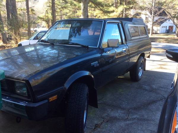

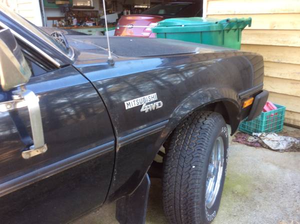

Here she is...Attachment 13017Attachment 13018Attachment 13019
Garage kept from new. 2 owners (2nd owner barely drove it.)
Needs a little engine TLC, but I'm up for it!:)

Welcome to the forum.
Very nice truck
Welcome and consider yourself very fortunate! How an where'd you find it?
Welcome fellow Georgian.
Great looking little 4wd.
Attachment 13157I found it in Atlanta on craigslist. Garage kept from new. Lots of tasteful upgrdes including a 2" reciever with electric trailer brakes, K&N filter, HD shocks, Superwinch locking hubs, HD swaybar, boot connecting cab and cap, etc... The truck is pretty much pristine with 108,000 miles. New in last 1000 miles: rebuilt transmission, rebuilt injection pump, clutch kit, tires, all fluids, brakes including master cylinder and more. Crazy.
The guy I got it from broke all 4 exhaust rockers by cranking on the cam bolt with an extended breaker bar while it was in gear. When it went, He heard ping ping ping ping. Everything looks good (except the rockers are broken). I'm thinking of buying this complete head (since the cam looks tired as well) http://www.ebay.com/itm/160699153873...%3AMEBIDX%3AIT
Any advice is welcome!

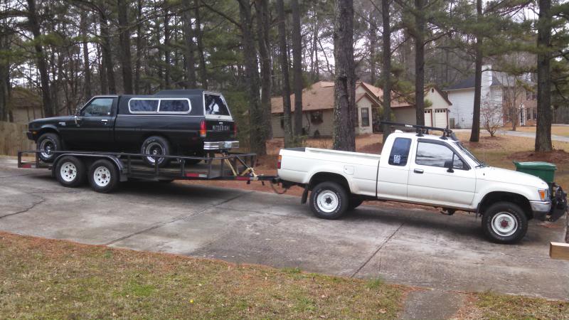

My other truck is a 1994 Toyota 4X4 extended cab with a Mercedes OM617 Turbo Diesel wedged in it. I towed the Mighty Max home with it on my tandem axle trailer. Great rig! 124HP and 170 ftlb of torque. Gets around 30mpg hwy and 26 around town.
