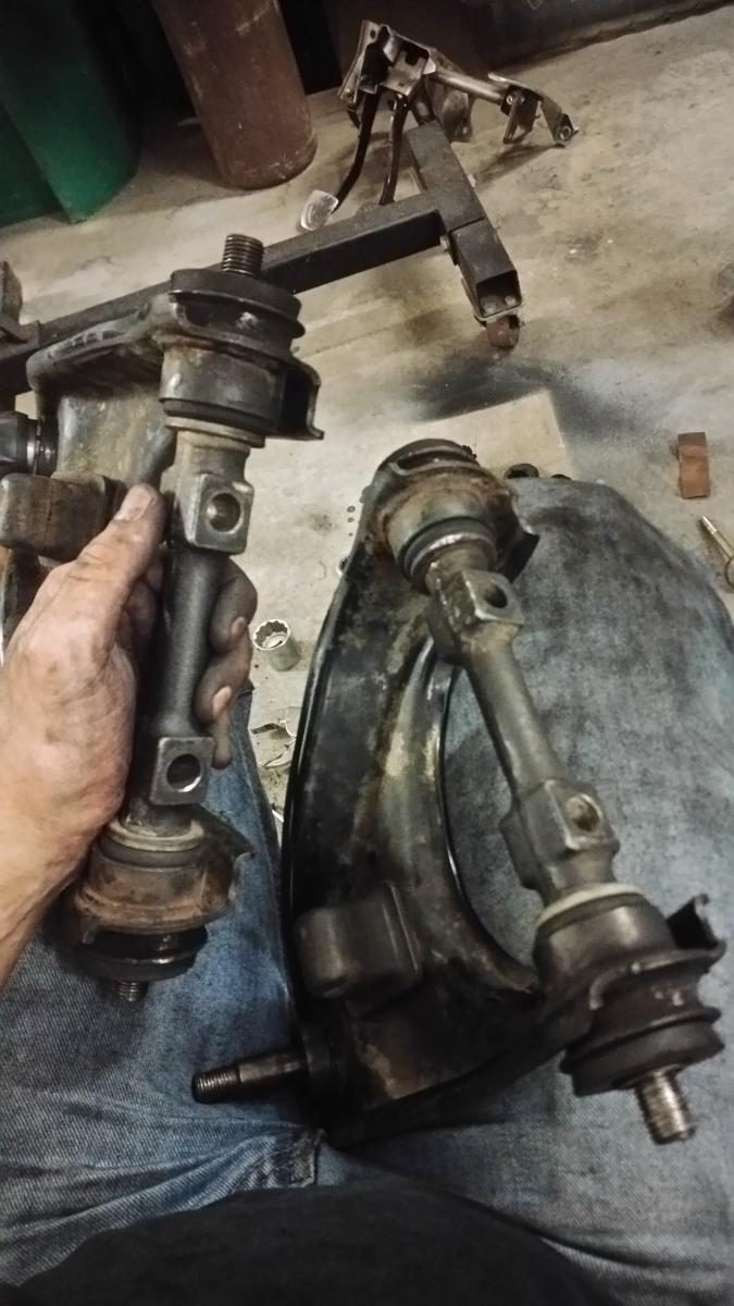

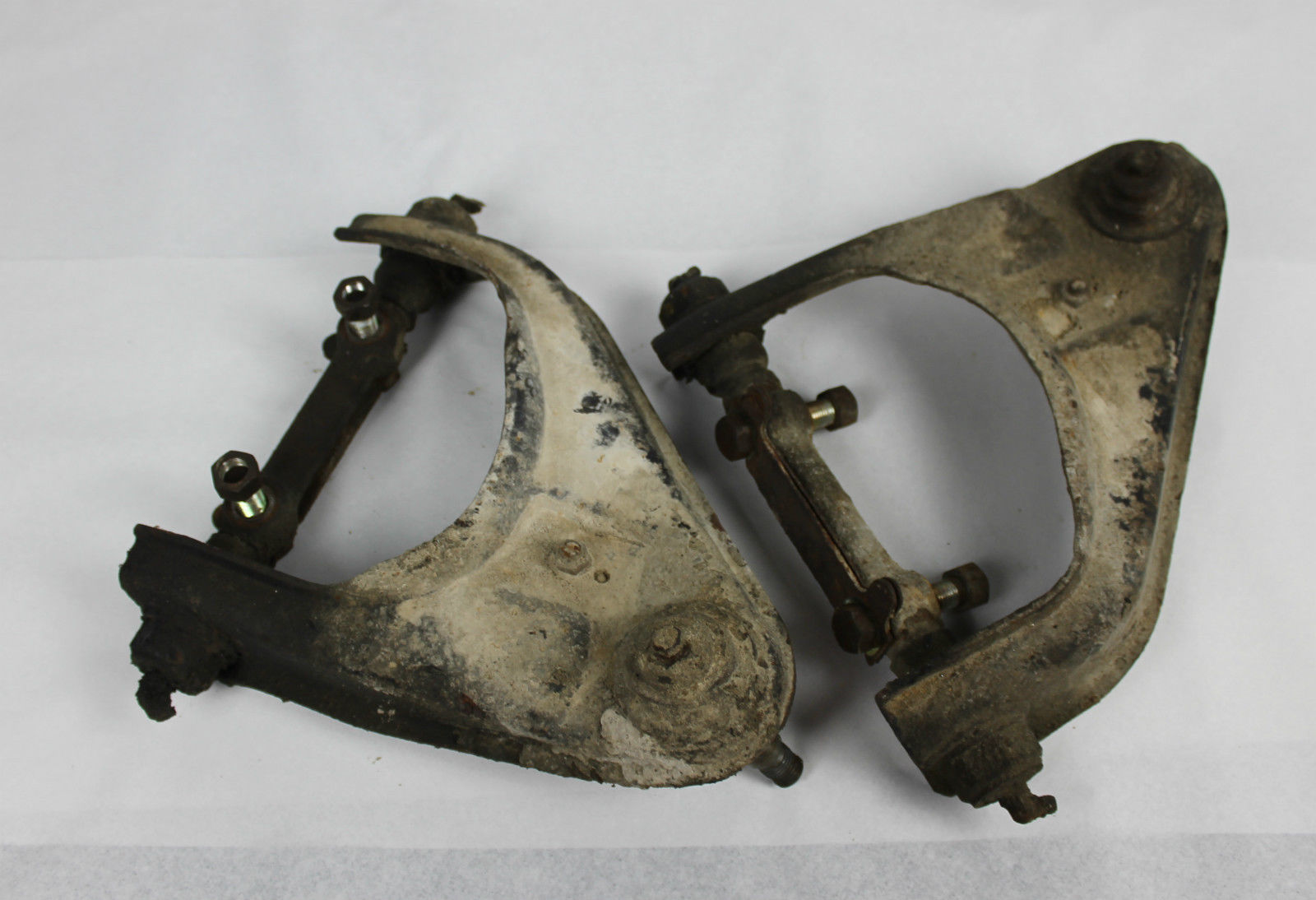

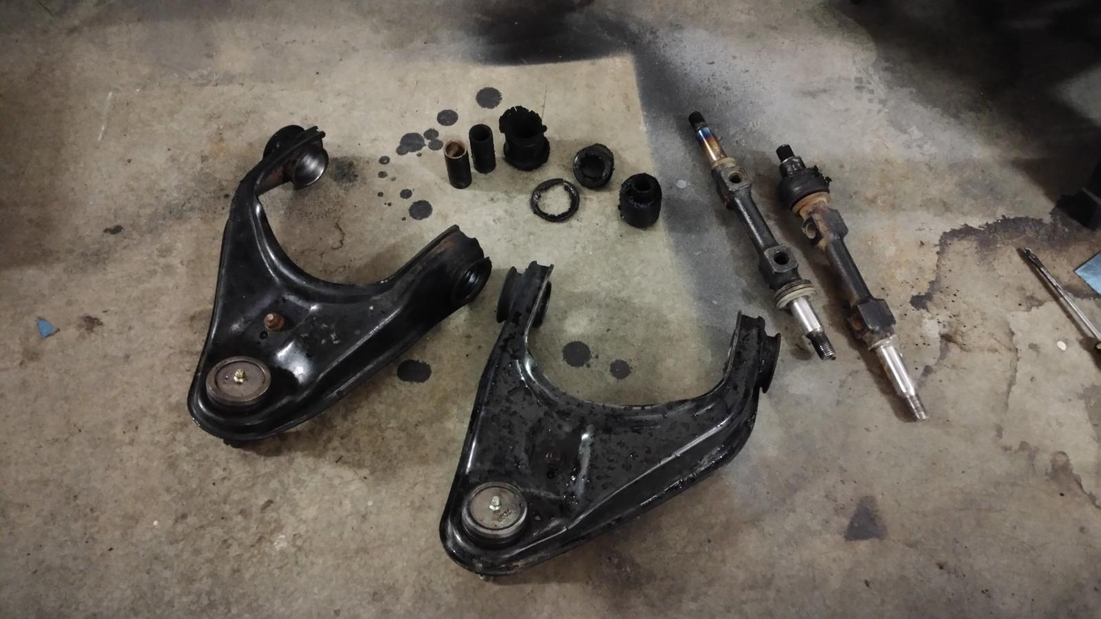

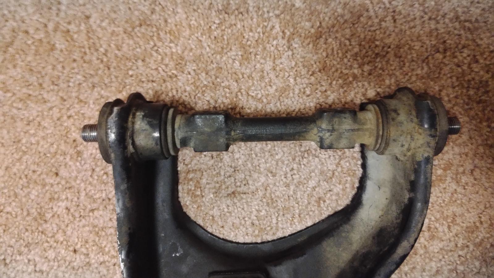

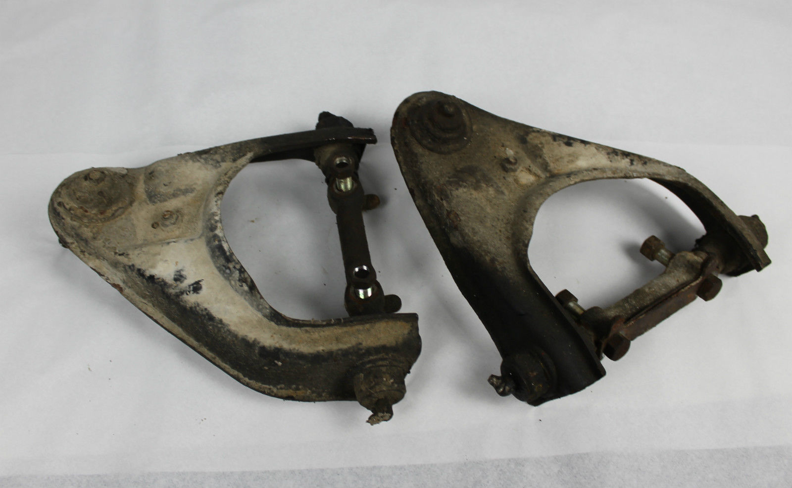

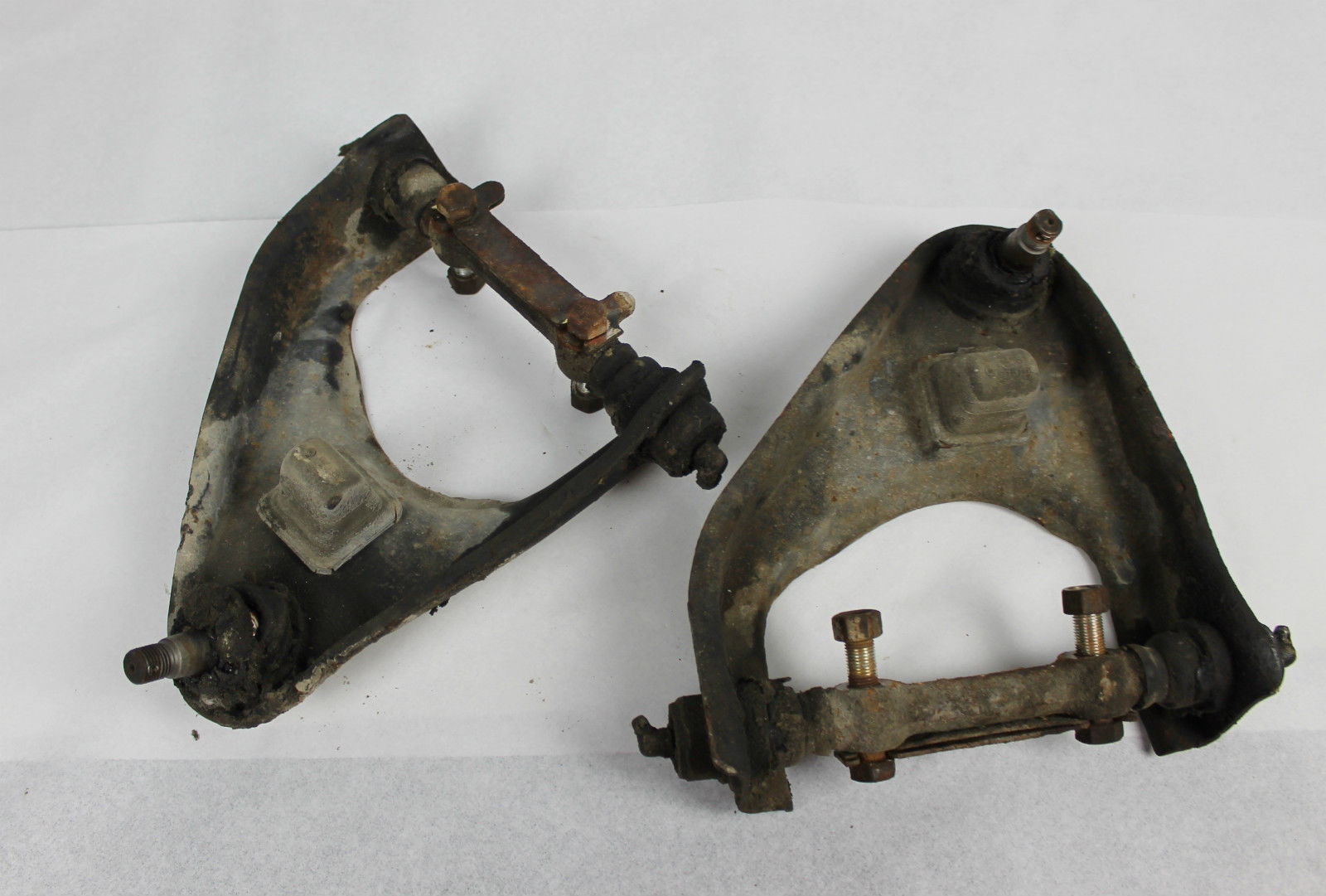

They are definitely different. So I found these on ebay, notice they have the right style:
Attachment 19291
Attachment 19292
Attachment 19293
Vs mine:
Attachment 19294
Attachment 19295
You can clearly see that the inner part of where the shaft goes through is longer and the outer part appears to be bigger and has a lip on it. Well that was a waste of new upper ball joints...
guess ill just have to bite the bullet and go with these puppies http://www.rockauto.com/en/moreinfo....206997&jsn=915
Wait!!!! My dumbass never even bothered to look! there is a model number printed right on the bushing! and viola! http://www.ebay.com/itm/MITSUBISHI-L...gAAOSwrnNXPtsn granted these are the only ones on ebay, amazon, or any parts store website but its still way cheaper than new control arms especially considering the waste of the new ball joints.
I had a feeling they were pressed in. No mean feat getting them out but it shouldn't be that hard finding urethane bushes to do the job. Does the Monty sport us the same control arms the mighty max? Might take some lateral thinking to get a match. I'll be in the market for a full front end rebuild so I'll need to do research...
Well according to my research the bushings I found are for a l200 but man they are hard to find. And I can't find any from a reputable source anywhere on the internet. Honestly I would just buy the whole control arm assembly with new ball joints. Which I would have done if i didn't already buy the new ball joints and pressed them in. Be sure to upgrade to those dual caliper pistons geezer101!
I can get pressed in urethane bushes here but it'll cost me $$$. We have 2 companies that make them - Whiteline and Nolathane. But they ain't cheap so I'm doing the cross reference thing, There are rubber bushes sourced from Thailand for the L200, Strada and Animal but I'd still prefer the upgrade. And as for brakes, well I'd LOVE to get the twin pistons but I'm not looking forward to buying new wheels to clear them unless I come across a bargain set. I have a new pair of hell lowered springs and a cut set from my donor wreck so at least I have that covered.
yeah I'm already having to take into consideration the fact that I still wont have wheels on it when the front is together. I'm going to have to buy some cheap steelies or something to roll it around.
I found just the bushings online, I believe rock auto maybe. But I think I had to look at an earlier year or maybe it was 4x4 to find the right bushings. Mine look just like your stock arms.
The shafts/bushings are a pain to press out/in.

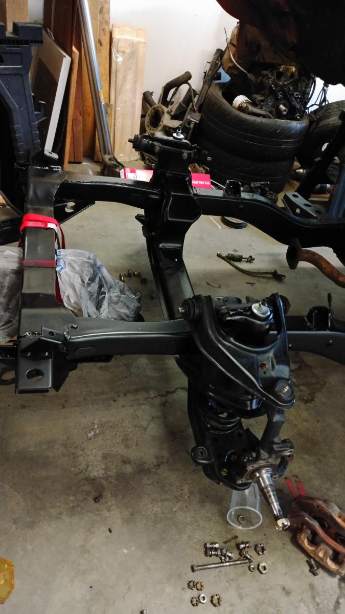

Attachment 19311

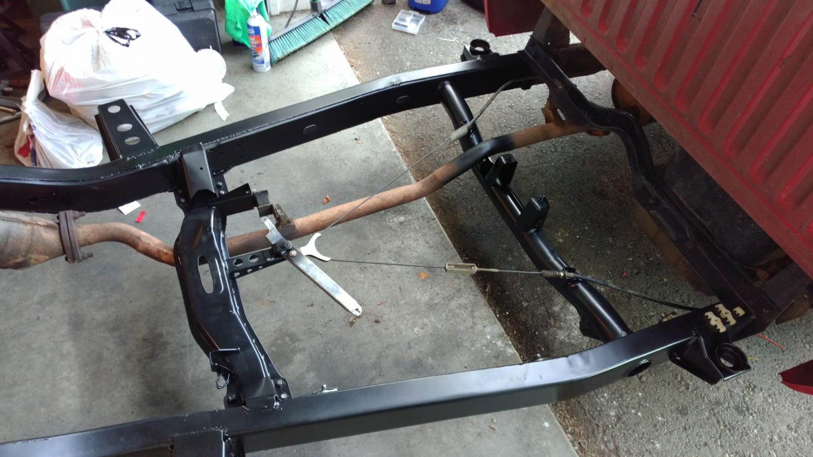

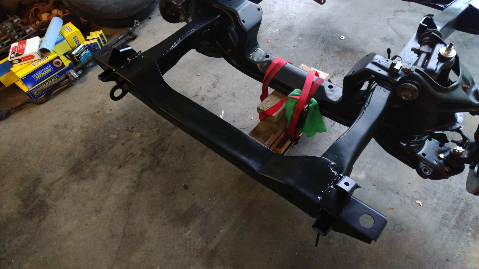

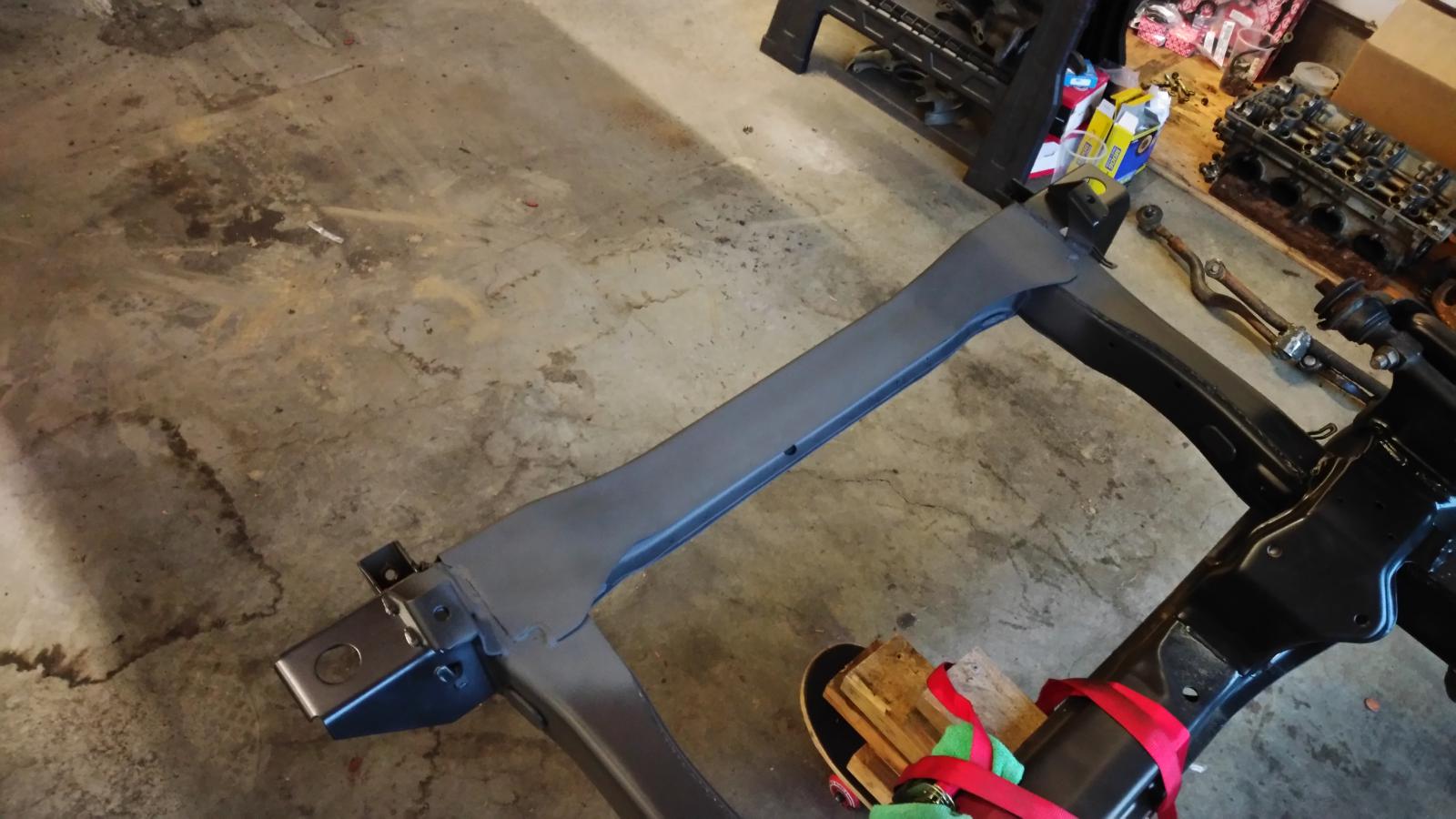

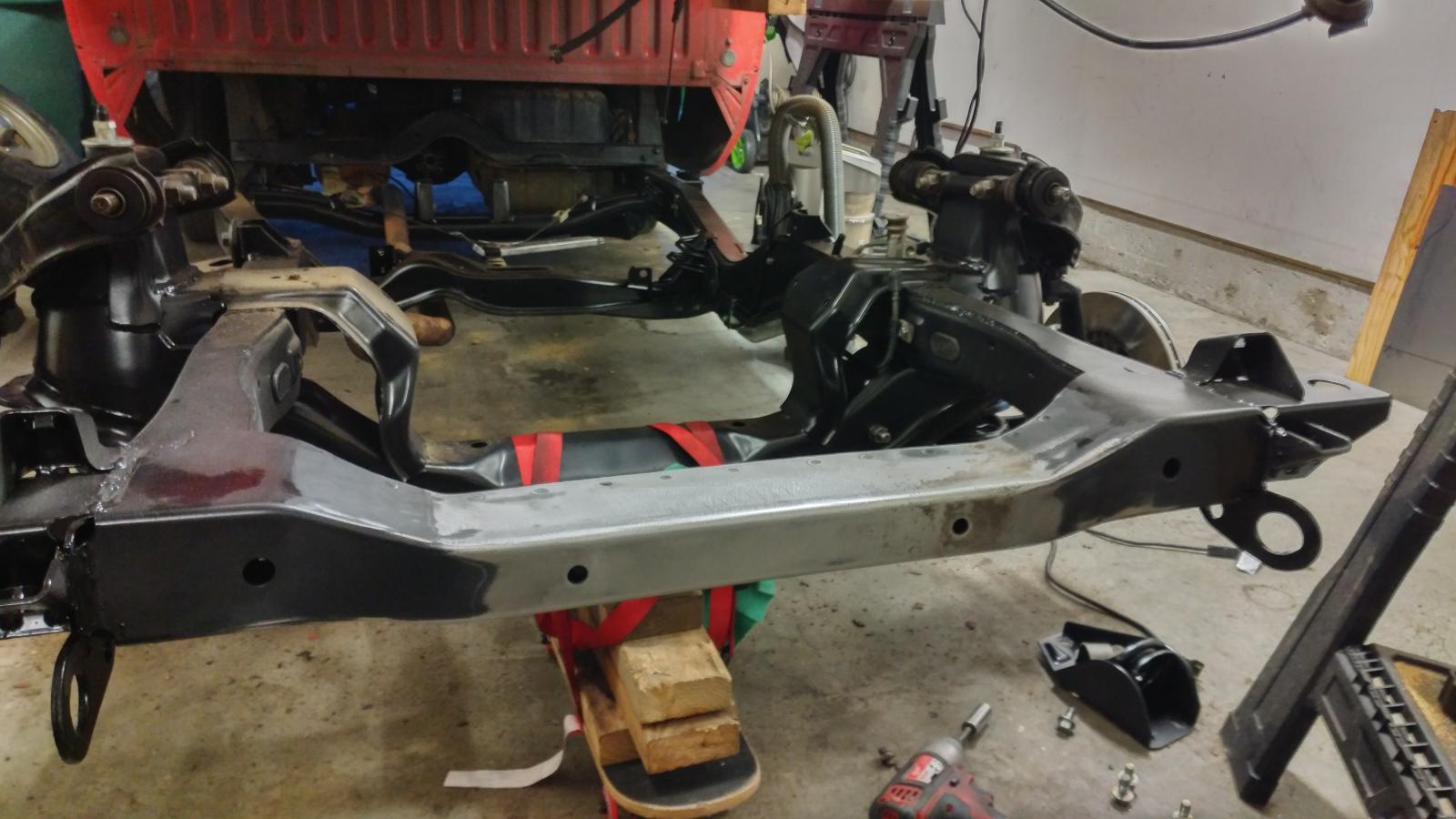

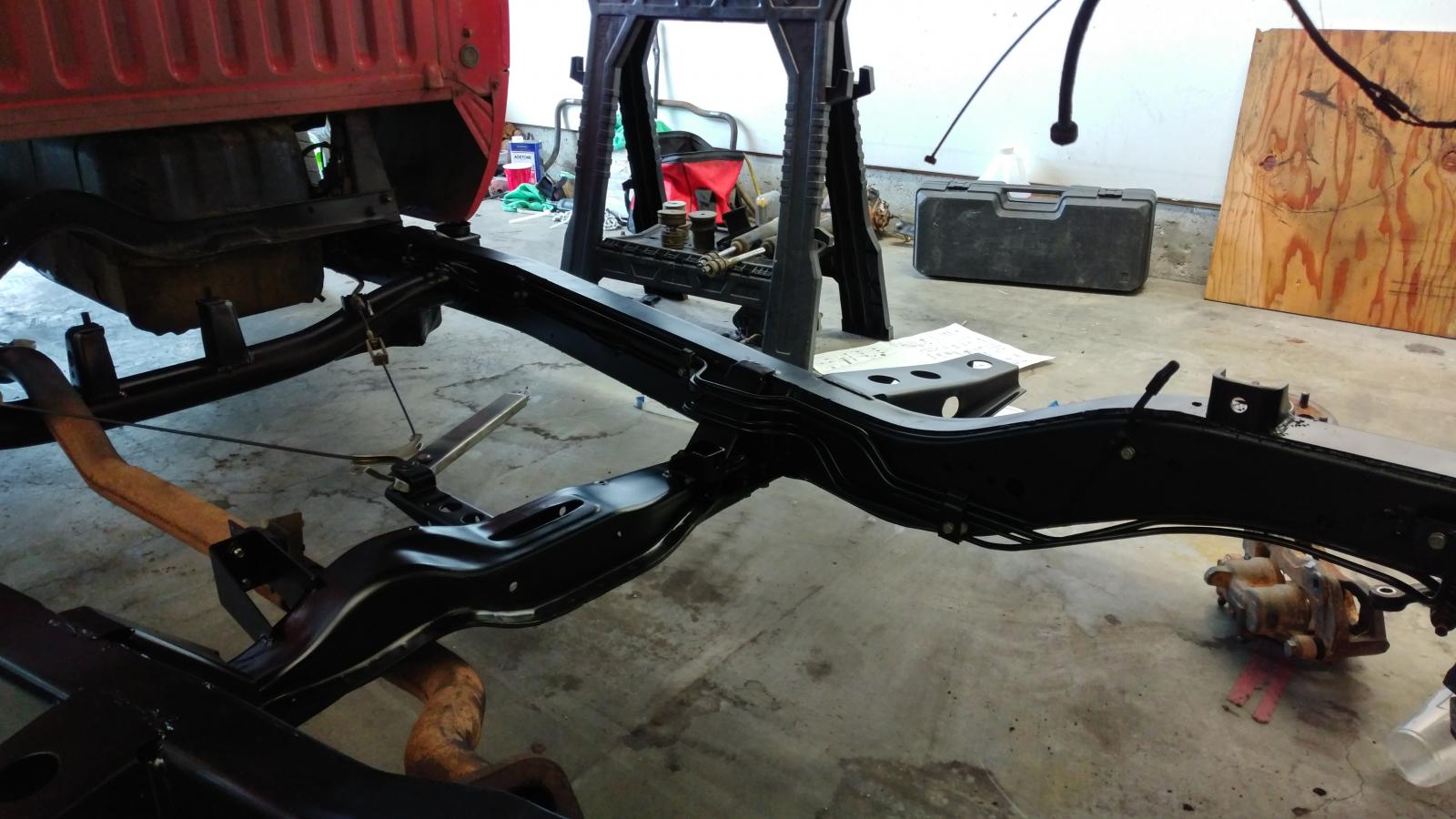

Got some parts of the chassis done today and hooked the e-brake back up.
Attachment 19314
I'm not sure how you're supposed to align the crossmember for the tranny but I just measured from one piece of the chassis to the other and divided that in half to find the center and aligned the crossmember as close as I could get it. Also couldn't find the torque specs for the crossmember so I just went with 50 ft-lbs on the 12 bolts.

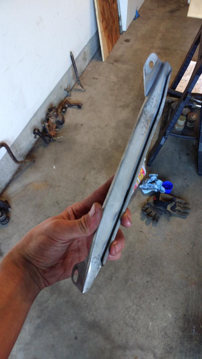

Does anyone know what this piece supports? I know it came off the chassis somewhere but I honestly cannot remember where it goes.

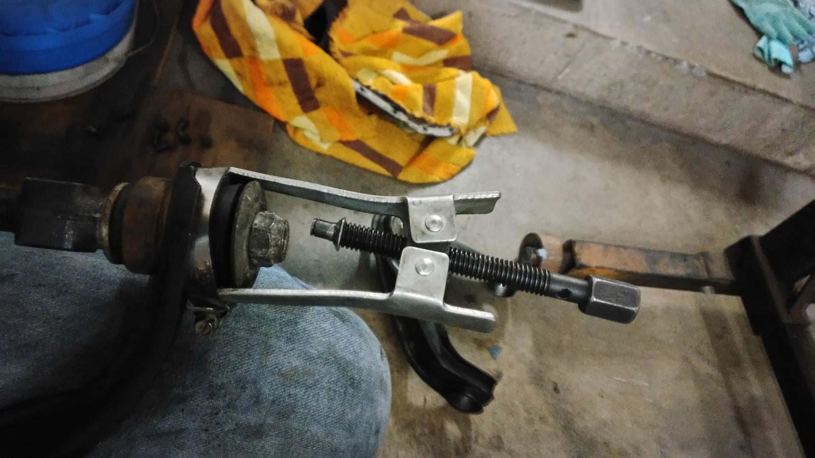

Got the old bushings out cause the new ones finally arrived from Portugal!
Attachment 19378
Attachment 19379
And right in the freezer they went...
Attachment 19380
Once the bushings are installed the front suspension can go back together finally...

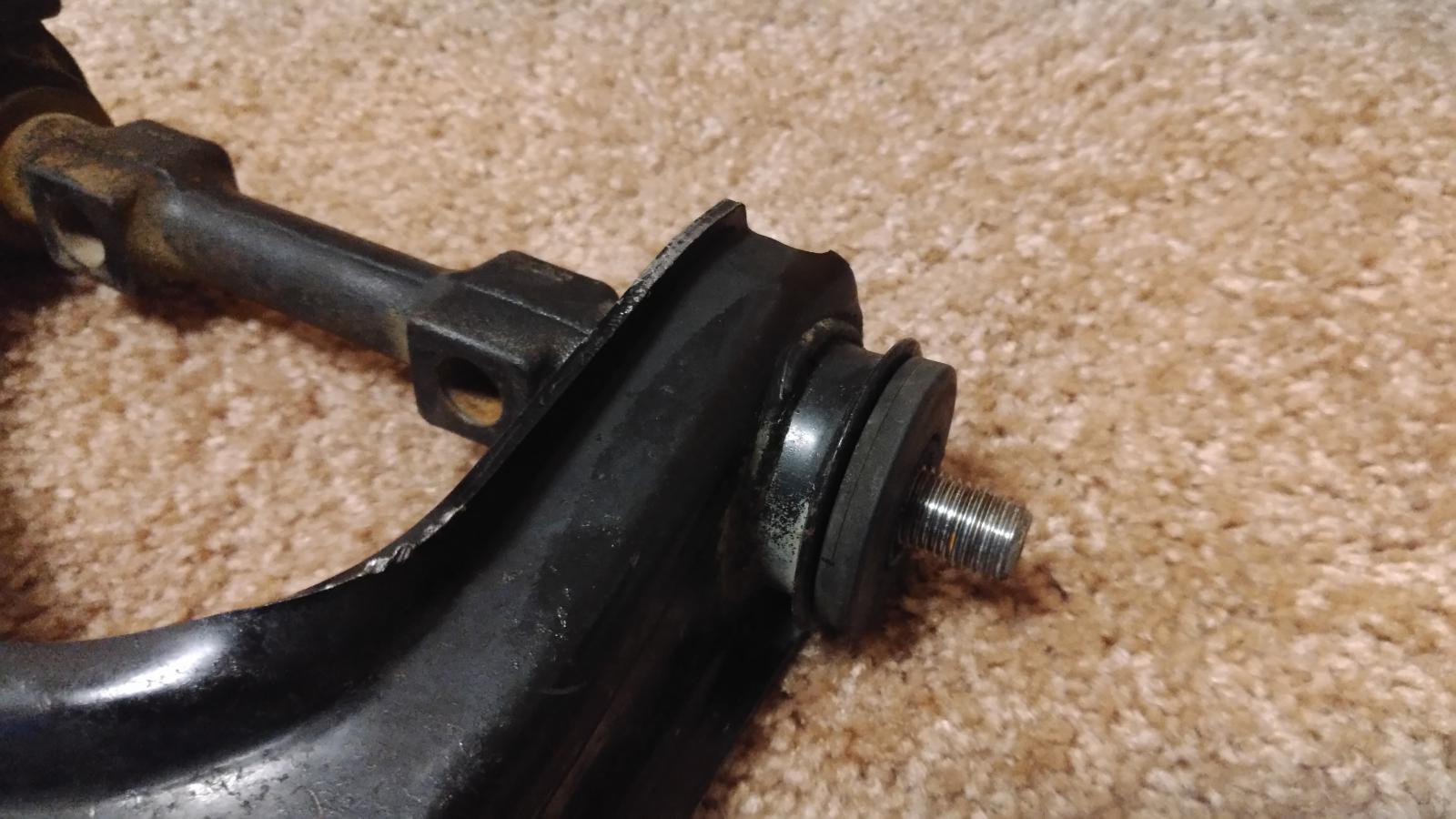

I didn't mean to double post Geezer but I wasn't getting an answer on my thread here and I know the general maintenance area gets more love ;) But man these bushings are a pain next time I will definitely just buy the control arm preassembled. the bushings are kinda crooked that I initially pressed in I hope they will settle :(
Attachment 19383
but I think my idea for pressing the other bushing in turned out pretty good :))
Attachment 19384
There was some hiccups though :bang:
Attachment 19385
Attachment 19386
this bastard was rusted on there... was not fun getting it off, I guess ill keep a eye on this control arm for a while and replace it if SHTF again.

As far as those bushings go they will just have to do for now. gonna have to learn my lesson the hard way and just buy the whole control arm assembly down the road when they do. I'm not about to take everything apart again and spend all night trying to get them to seat in there. Worst case it should still be quite a bit of road time before they completely fail. But on the bright side, the chassis has 80% of a front suspension and fuel lines again!

Sorry about the ill communication. The deflector/channel/thingy goes on the underside of the frame in the front wheel well (where it slopes away from the control arms. You should be able to see a threaded hole in the frame directly under the bolts for the steering idler arm mount. The other end bolts to the inside of the frame further down.
I wish I had the opportunity to get my frame and suspension assemblies looking as good as yours Chyrio. Maybe it'll inspire me to keep my truck off the road for even longer :rolleyes:
That piece goes on the under side of the frame(drivers side) right where it slopes down behind the control arm there where the fuel/brake lines are, you can see the spot in the last pi that's really dark.

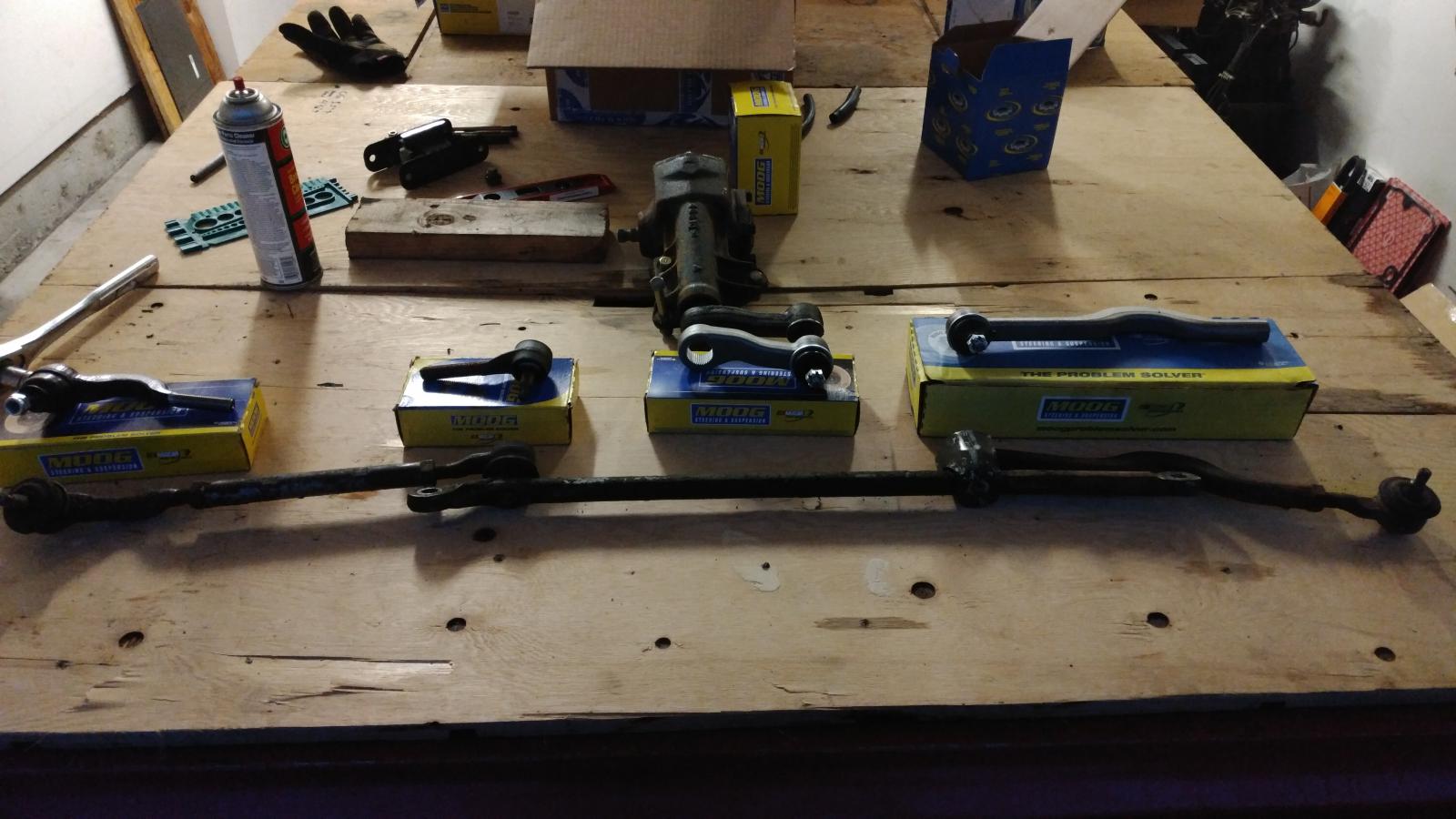

Made some more progress today on the truck.

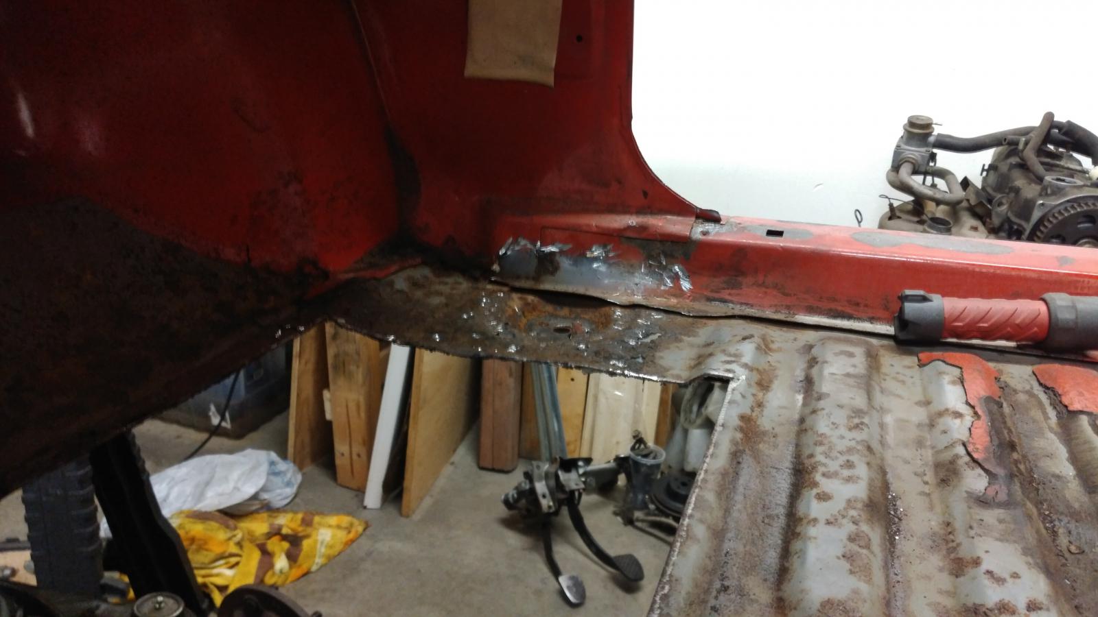

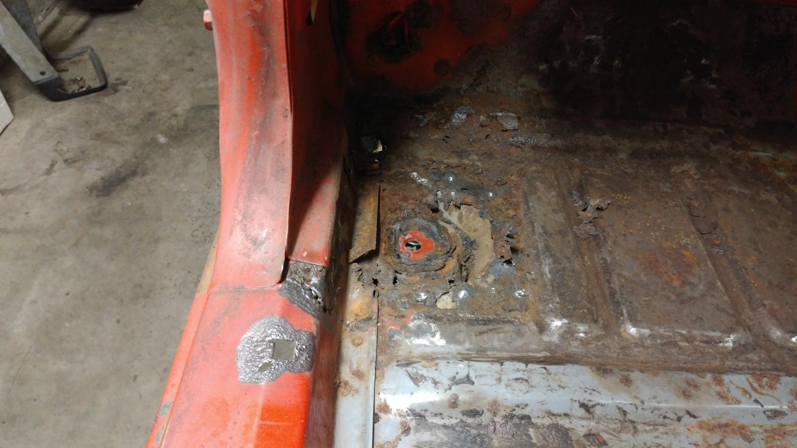

First of all my buddy and I decided to replace the rocker panels if we can and just patch the floor where it needs it. Figure that's the easiest way to repair most of the rust. I'm gonna grab them from here https://www.parts.com/index.cfm?fuse...subishi-Mighty Max-Base-L4-2.0- Liter-GAS
We removed those pieces that support the cab from the passenger and driver side footwell and boy am I glad I did :P see for your self
Attachment 19394
Attachment 19395
Probably going to make some kind of sturdier mount and either add some drain holes of some kind or get rid of the bowl design completely.
Next up I started piecing together the steering and realized I forgot to order a ball joint :bang: so that's going to have to wait a little while longer unfortunately

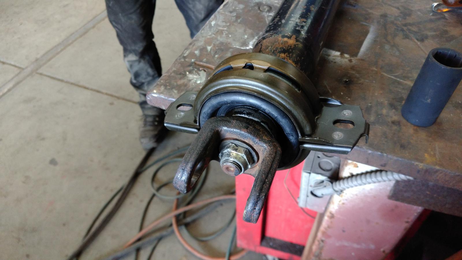

The other day I went to my buddies shop and replaced the carrier bearing on the driveshaft. So happy I had the driveshaft out of the truck and already taken apart for that.;)
Attachment 19396
I am assuming there is not a specific way the fork on the bearing side needs to go back on? I forgot to mark It before I took it off :shakehead:
Glad I decided to replace it though this thing was shot

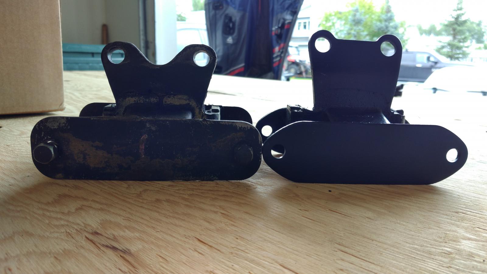

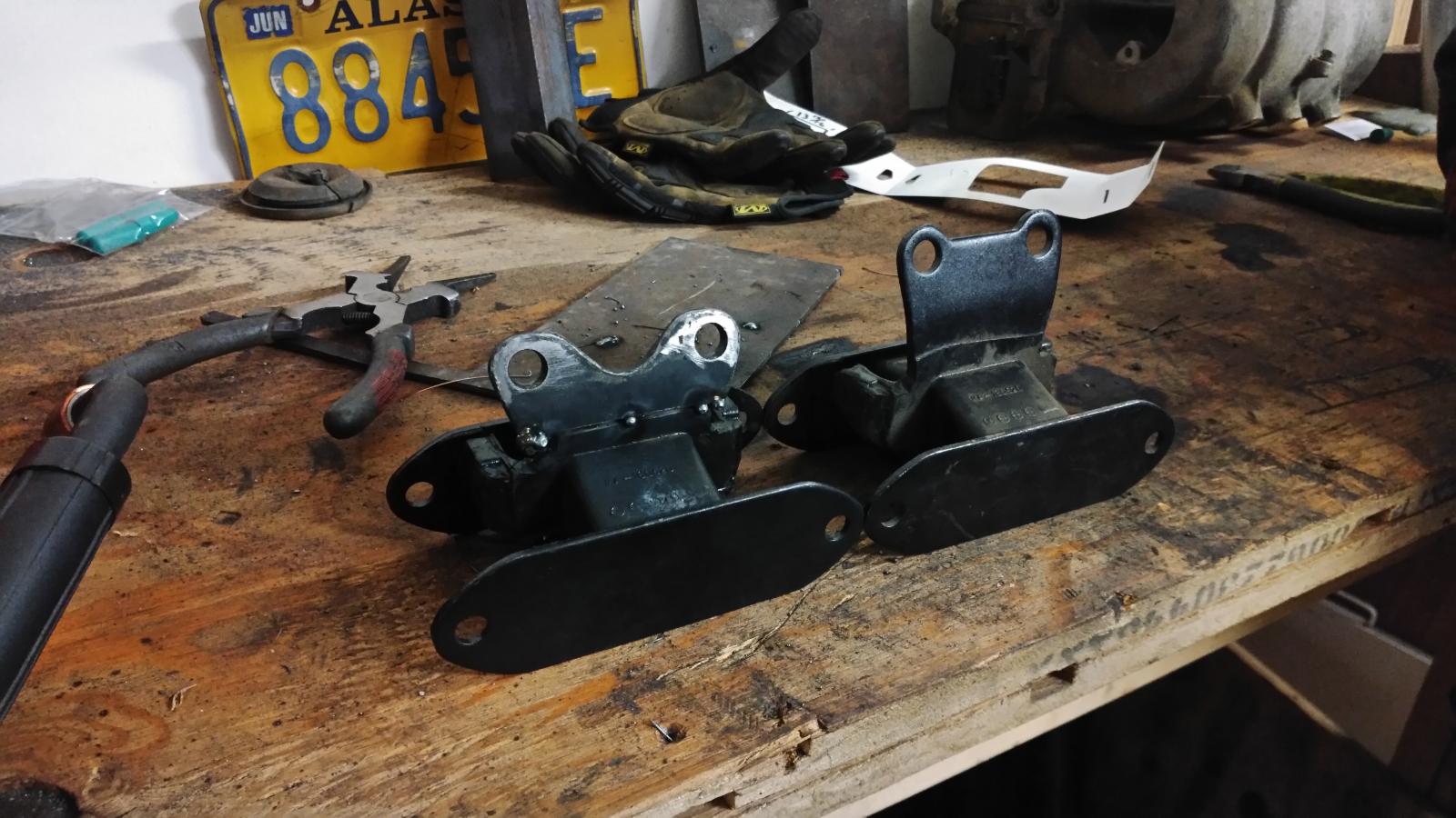

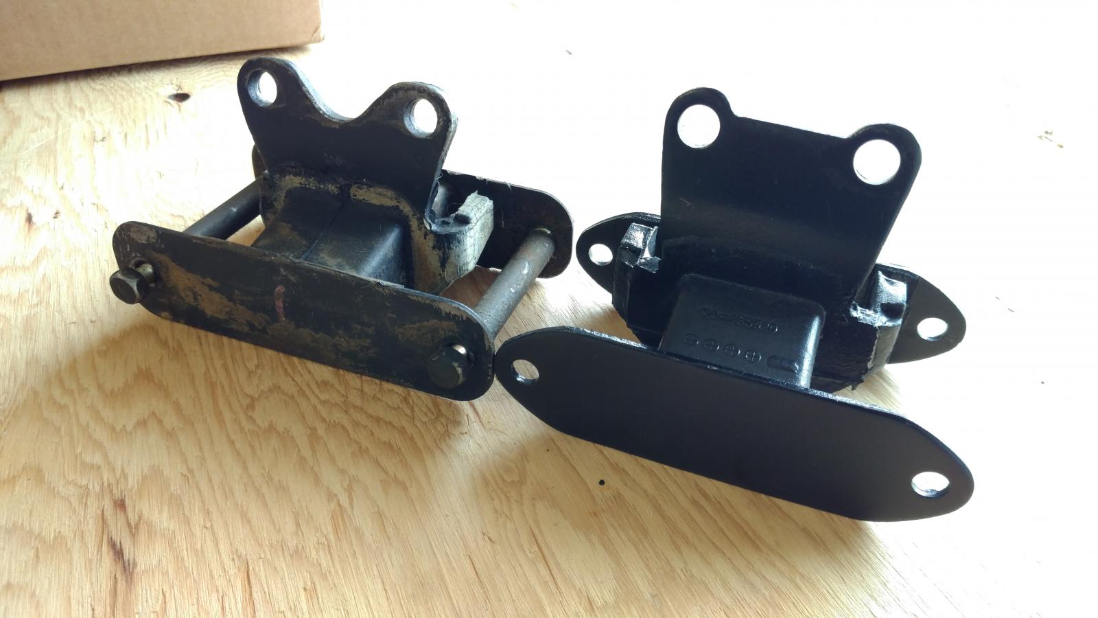

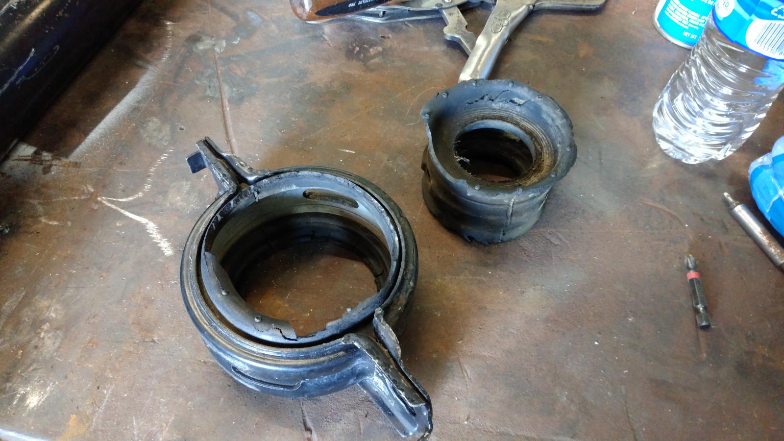

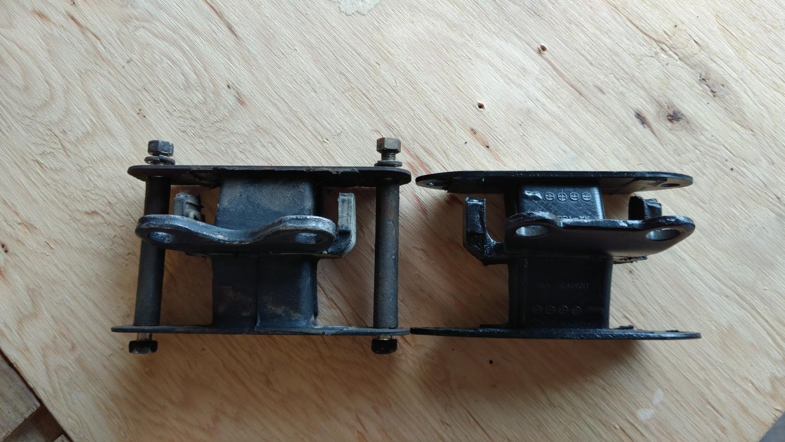

Next up I started working out the tranny mount bushing using the common one for the 75 Colt I think it was? its this one https://www.rockauto.com/en/moreinfo...=1080223&jsn=4
Attachment 19398
Attachment 19399
Attachment 19400
They are very similar but as you can see in the picture there are some minor differences notably the factory MM one is a 1/16 of a inch longer and the Colt one is about a half a inch taller. Also obviously the Colt one is no simple bolt on for the km132. So here is my solution. Its just tacked together for the moment but I think its as good as I'm going to get short of designing a whole new mount.
Attachment 19401
All I did was measure the distance from the table to the top of the MM mount and then cut the Colt mount so the MM flange would sit at the same height and I tried to get the angle of the mount close to factory. Worst case, I bought two of those Colt mounts so if the first design fails I have a spare. :stan:

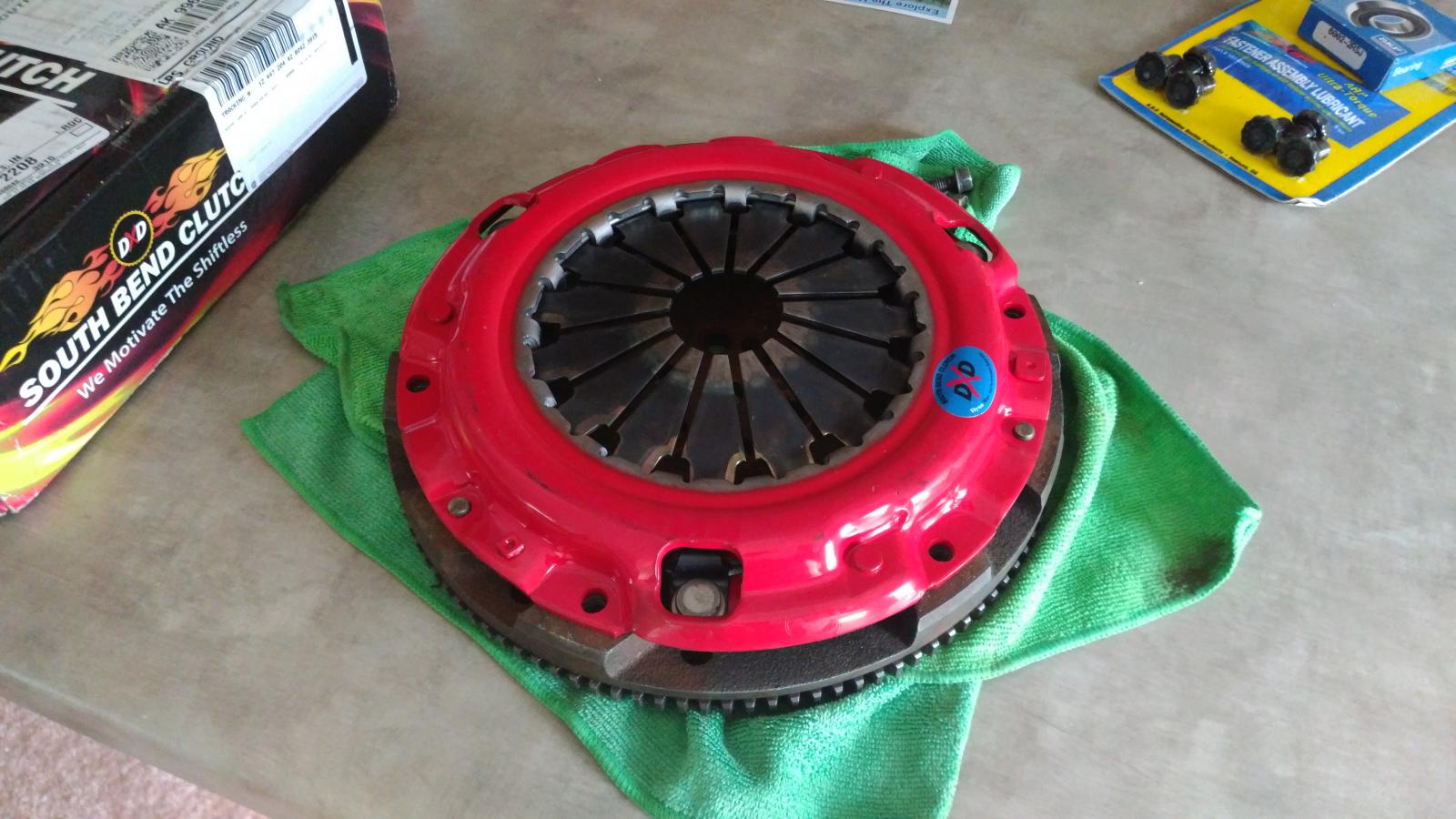

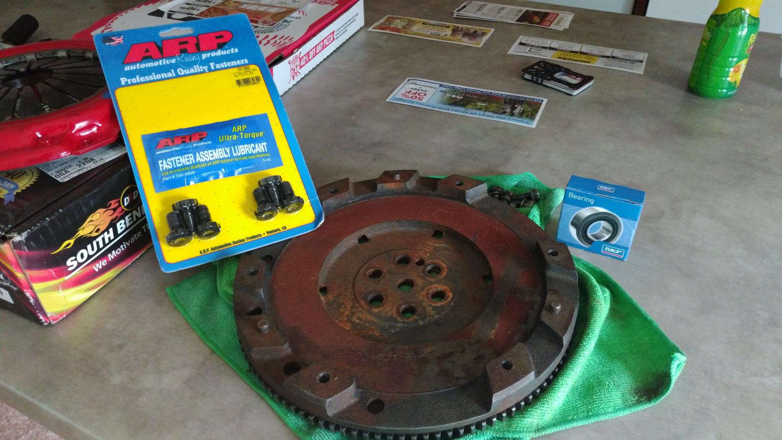

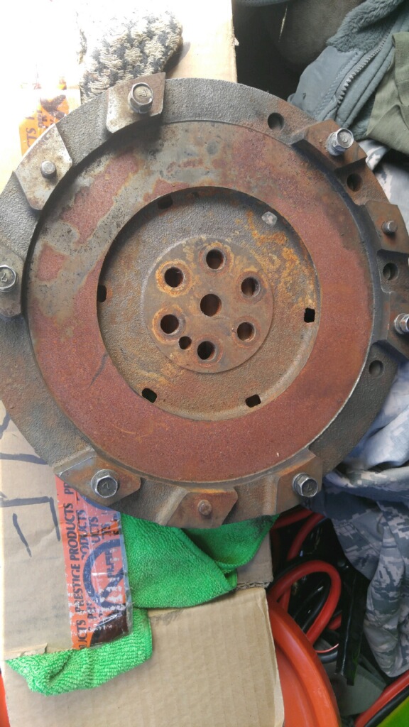

Also got the flywheel I had to scour the freaking internet to find! FWD Turbo 6-bolt DSM flywheel is a tough one. But it works!
Attachment 19402
Once I get the pilot bearing and the clutch surface done it will be on the truck with these over engineered bolts ARP has :dance1:
Attachment 19403

O and I forgot! Thank you Geezer and DroppedMitsu, I figured out where that piece goes!

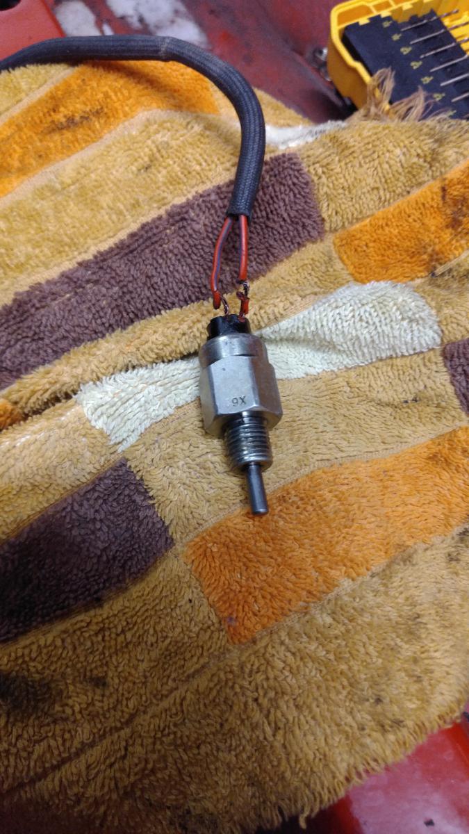

You have been reading about this thing all over the site - it's THAT reversing light switch. You know, with the ball bearing has got everyone clawing their eyeballs out in frustration. Please say you haven't 'dropped the ball' so to speak?
*oh, and you're welcome. If it wasn't for the fact that my truck is still up on stands I wouldn't have known where this deflector channel thingy was. :thumbup:

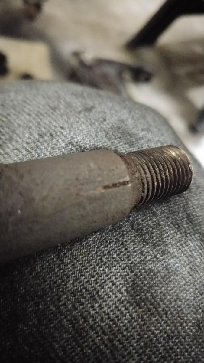

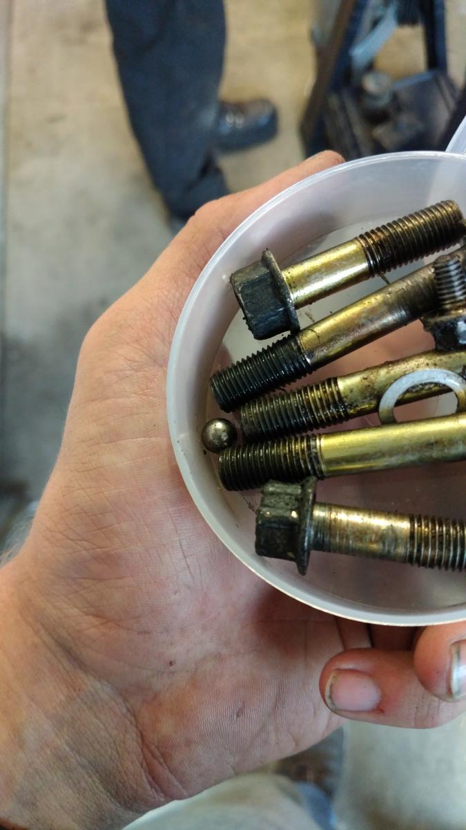

Found the little ball you where talking about geezer! I still want to try to find a new switch if I can though.

Also put the first two coats of primer on the front of the chassis.
Attachment 19414

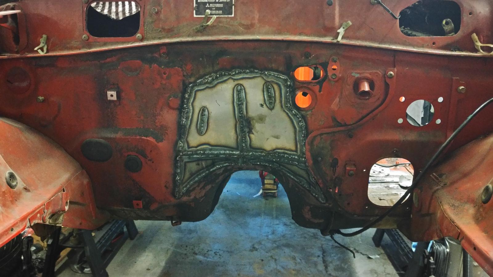

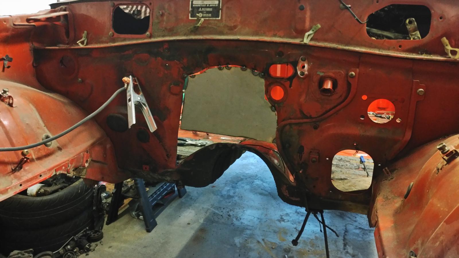

And started mocking up the new firewall. Might recut this piece to make it more flush, or might just fill in the gaps. I also beat the outside of the hole I made back into the cabin as smoothly as I could. The results are about a inch or so deeper than normal. since I am going to do the Jay racing kit all I really need to clear is the little sensor thing on the back of the head. Hopefully that should do the trick. I cant go to deep as I am going to try to reuse the factory heater core and stuff. I am also thinking of making a little removable panel so I can access everything on the back of the head if needed without removing the head or engine.
Attachment 19415
If you have a pair of vernier calipers, measure the %@#$ing ball!!?! They all use the same ball bearing and it would be of great help to everyone who is trying to replace theirs after losing one. In bold letters, in it's own thread - maybe with a big picture of it and everything (I'm being sarcastic now). Your frame is looking really nice btw. Don't know if you actually need an access panel to the CAS at the back of the head, it may be more trouble than it's worth. You'll need fasteners welded to the firewall and then you have to able to get to them which will be no mean feat from inside or out. Is it easier to move the engine forward on custom mounts or something? The CAS recess is going into the area where the heater box resides.
More progress, first of all I got the rest of the chassis painted finally :rolleyes:

Also got the rest of the new firewall in place, its a little rough here and there but I don't think its to bad for my minimal metal working skills. It will look better when I grind it down.
Attachment 19424

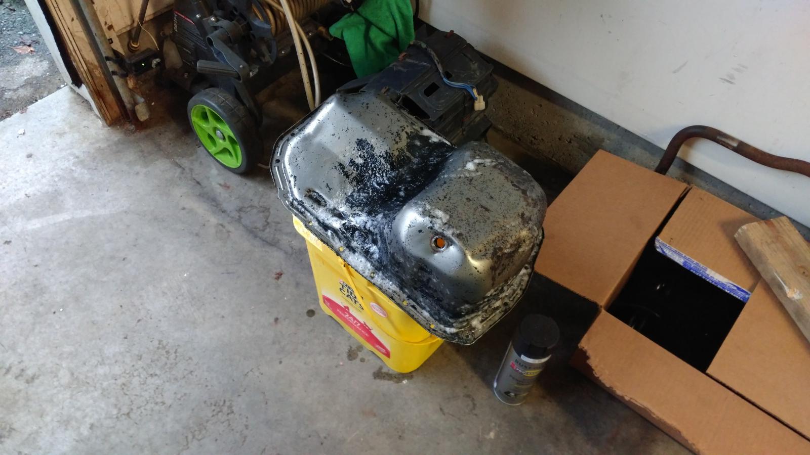

I picked up a turbo oil pan cause I only had a N/A but I had to bang some dents out of it and I decided to strip the paint, it was pretty rough.
Attachment 19425

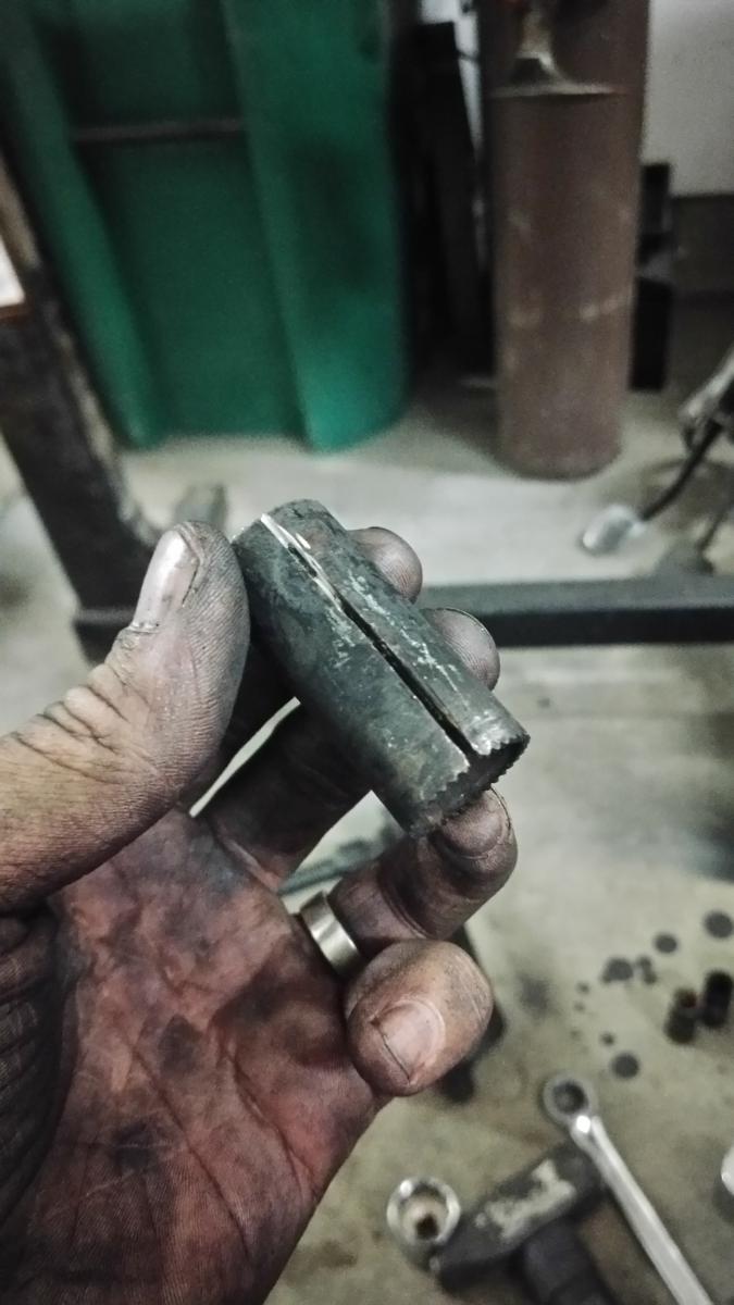

And for the finale, as requested by Geezer. I started a thread about that Reverse switch metal ball.
