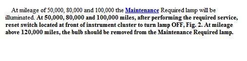

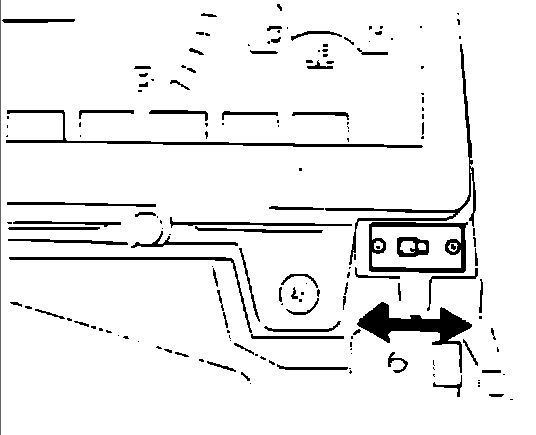

You need to remove the dash panel that is over the cluster gauges. There is a switch that resets the engine maintenance light. It's a function that wont reset by itself and lights up at specified mileage that is reached by the odometer. You'll need to remove 4 screws, two on the underside of the top panel and two behind the hazard switch on the left and the blank on the right. Be aware that the maintenance light is designed to go off 3 times, and will NOT reset after the third reset. After the third time you need to remove the bulb as it will no longer reset.
Attachment 21205Attachment 21206
