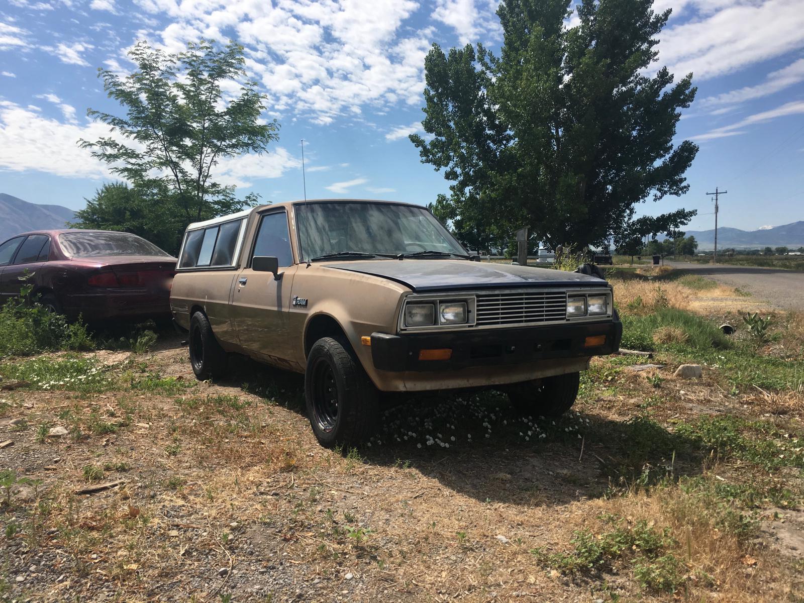

Attachment 19839
I bought this truck for $200 back in June of 2017 from a friend who bought it from his neighbor after he threw a rod through the block.
at first I just wanted to replace the stock motor. but I soon found threads about swapping V8s into these things so I decided to go that way. I am currently putting a 5.9 Magnum from a 97 Ram 1500 using a 904 transmission.
The truck isn't in the best shape. It has a giant rust hole in the floor by the drivers side brake pedal and a smaller one on the passenger side. There are other rust spots in the body and the rear springs are going out. Dash has a few big cracks in it and the seats are ripped. It came with pretty good tires though. And a spare hood, brand new transmission (for the 4 banger) and a bunch of left over tools in the back of the bed and a shell.

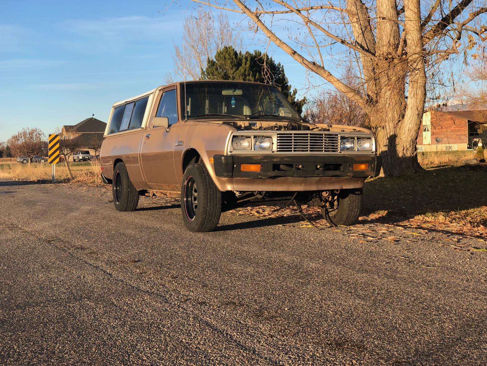

Attachment 19835

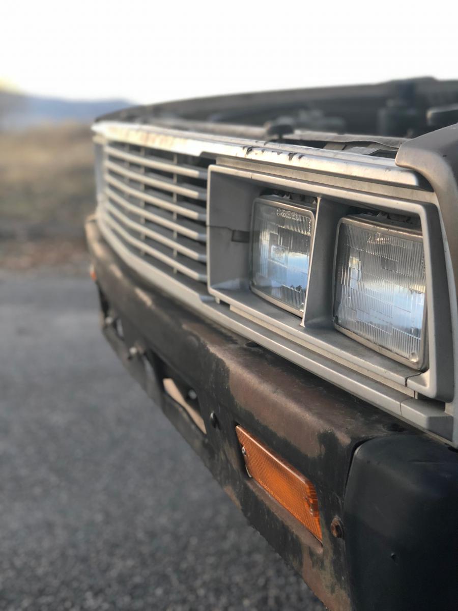

Attachment 19836

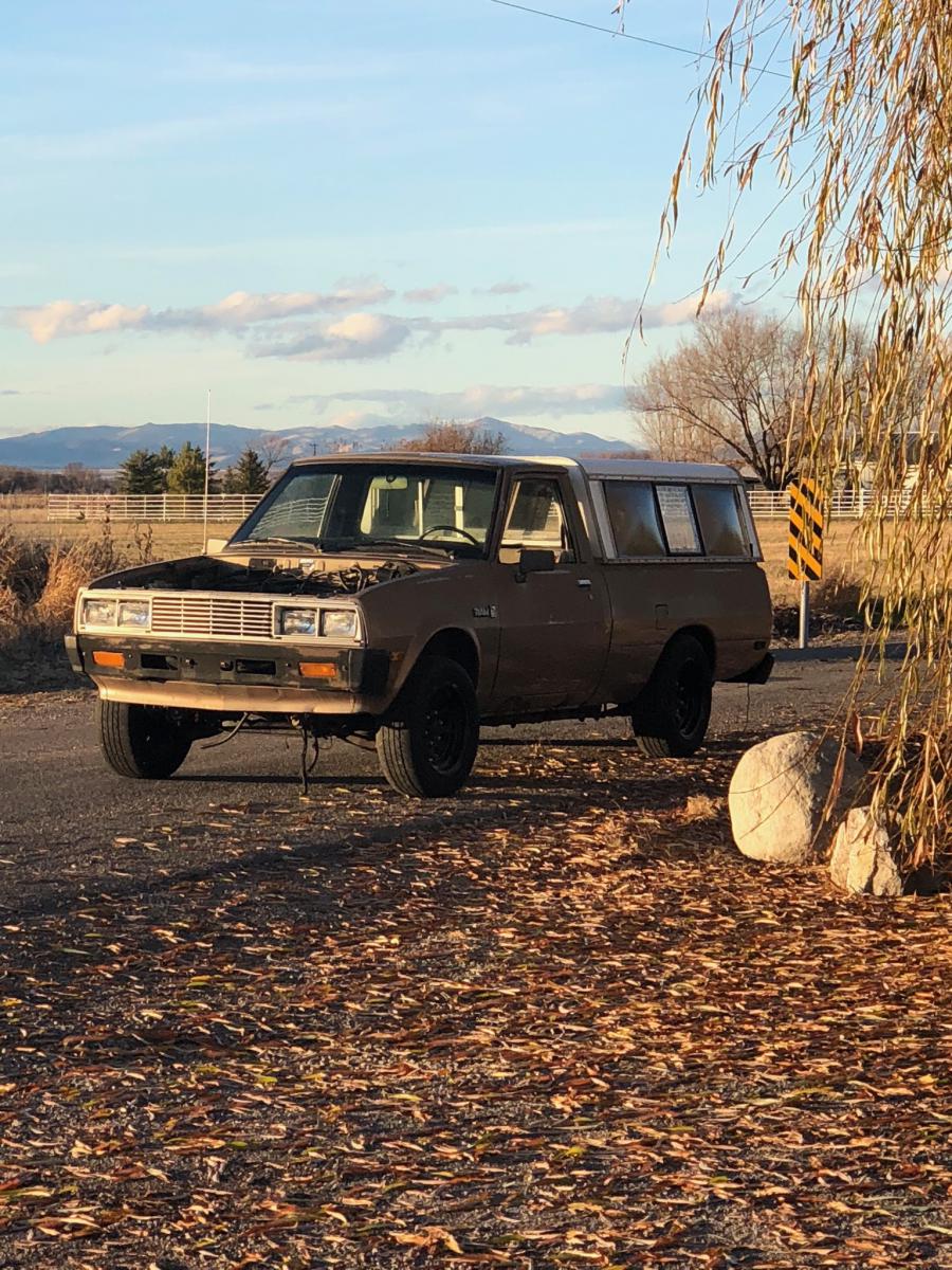

Attachment 19837

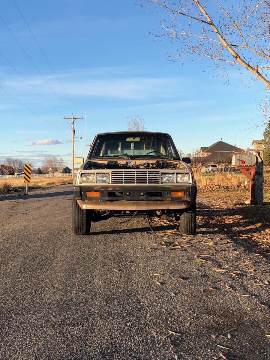

Attachment 19838
