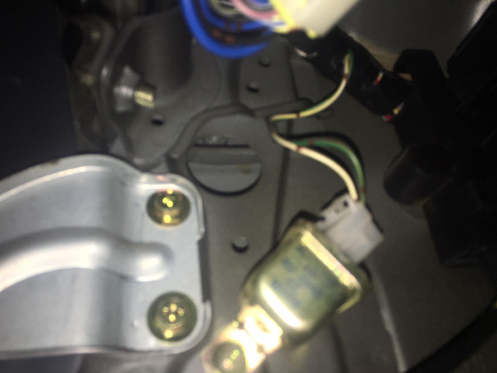

On my ’88 the buzzer is located just above the hood release handle.
Attachment 21665 Two wires, a yellow w/white stripe which is from the door switches, and a green w/orange stripe from the ignition switch, connect to the buzzer. Hopefully your buzzer is there and only disconnected. If there and connected, check fuses #1 and #7 and the buzzer itself. The buzzer serves as both a key and fasten seat belt reminder.

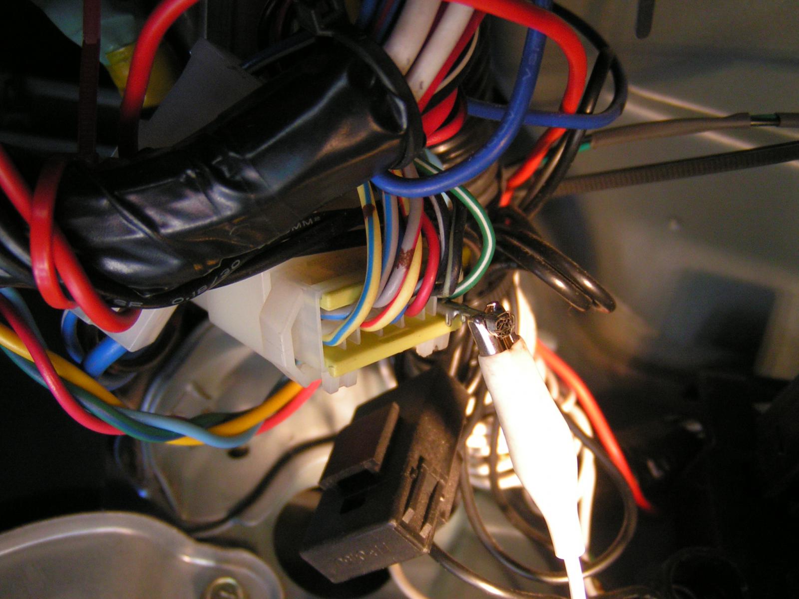

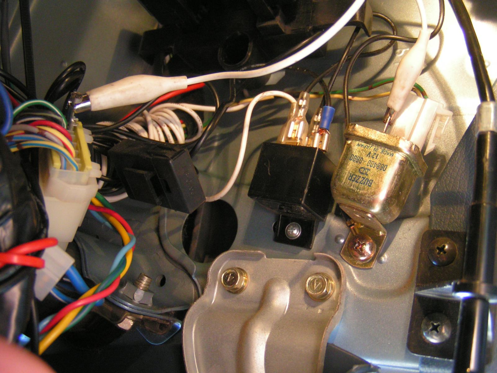

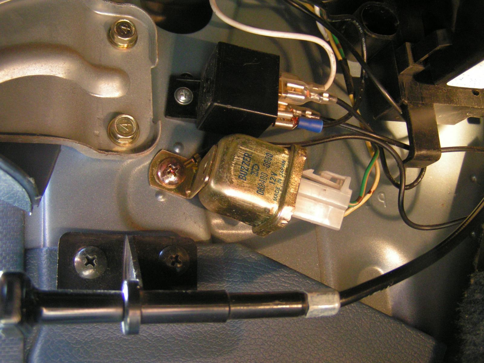

Attachment 21667
The pics show my test-of-concept using a wire with alligator clip ends and a male pin connector to back probe and connect the 10-wire connector’s green/white wire. I just never got around to making it more permanent. You can also connect the new wire to the load side of fuses #1 or #12, but the connector I used is more accessible.
