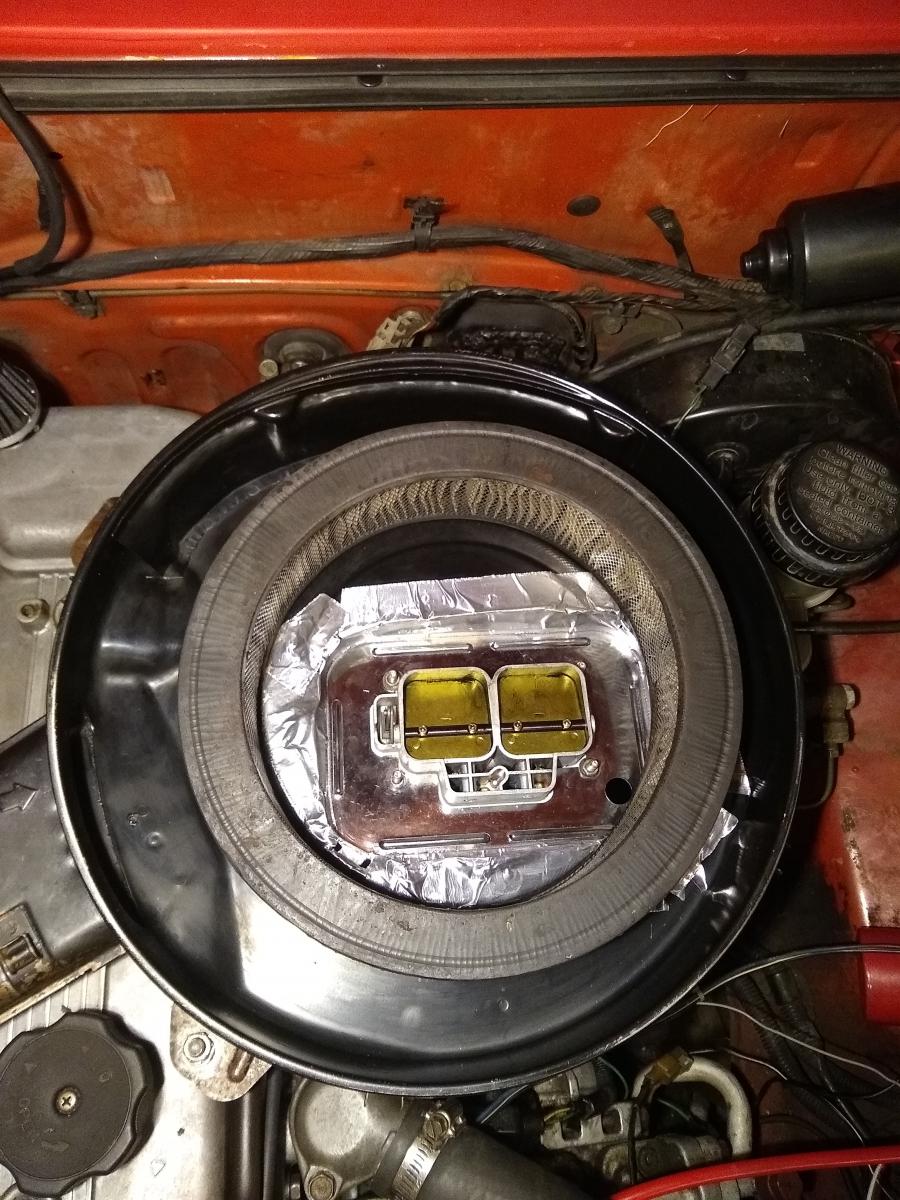

I've been playing around with modifying the stock air cleaner for the Weber carb, and right now my progress is ugly and kinda hacked together... Lol
Attachment 22791
Attachment 22792
I figured it would be easier to use the existing Weber bottom plate as a template, and it's spaced away from the carb like that because I'm using the mounting points on the valve cover, the four studs on the Weber itself, and I'm thinking of making a bracket to hold a center stud for the lid.
Yes, that filter is extremely dirty and well worn, but it works as a placeholder.
And yes, I know that it's not the most efficient airflow design, but it'll work for getting somewhat cooler air to the carb. Maybe. If I actually follow through with it.
If you plug the mounting hole in the top of the air cleaner box you might not even need the centre bolt. It's primary purpose is to clamp the whole air cleaner assembly down to the carb but if the base of it is secured rock solid, you won't need to factor it in. Hmm, the Weber sits higher than the stock carb with the adapter under it - I didn't know that...
This will work better than the open element filter and maybe with some heat shielding in it (or even around the main intake duct as it's hanging over the exhaust manifold), it might aid intake temperatures further :think:
