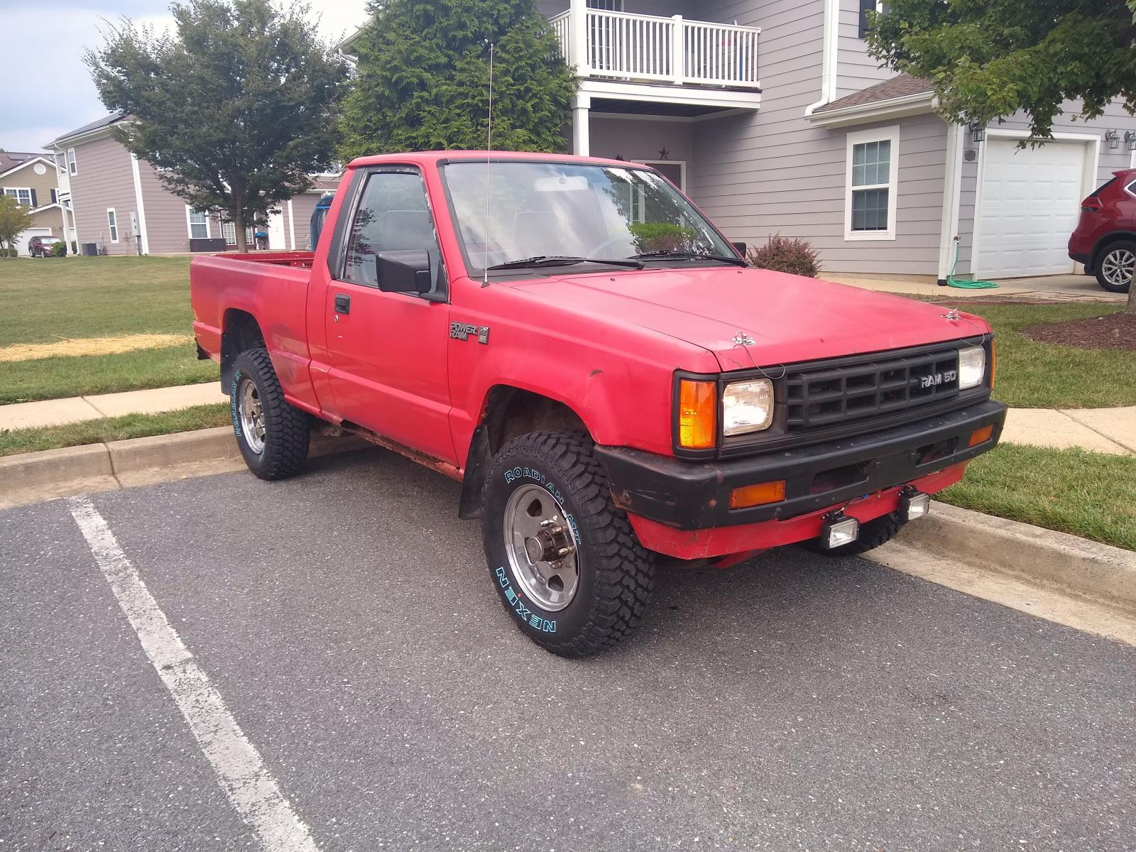

New meats on the truck.
Attachment 23175
It took a little while, but I'm starting to get much better at driving it. Practice, practice, practice...

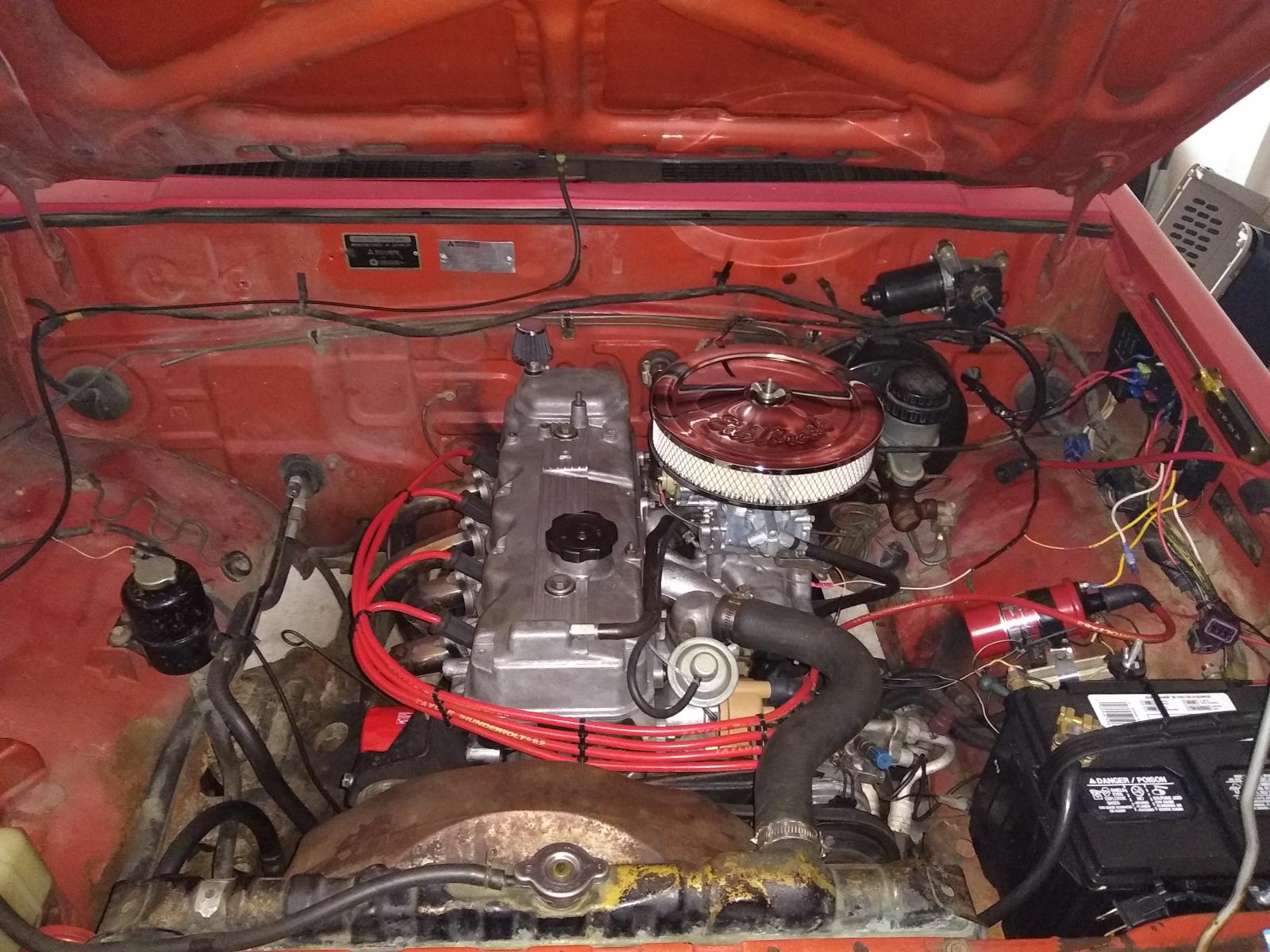

I don't plan on doing much with the exhaust until later, but I am planning on getting a universal 10" air cleaner to replace the tiny Weber filter. Later on I can either put a snorkel hat on it or get another stock air cleaner and modify it for the 5-1/8" neck.

Got the adapter on (with a little modification) and a 10" round air cleaner (with a little more modification)
I had to file the K&N brand adapter just to get it to fit onto the Weber, and I used the original mikuni carburetor's air cleaner stud with the adapter's bracket.
I know the air cleaner says Edelbrock, but that was the only one I could get on short notice.
