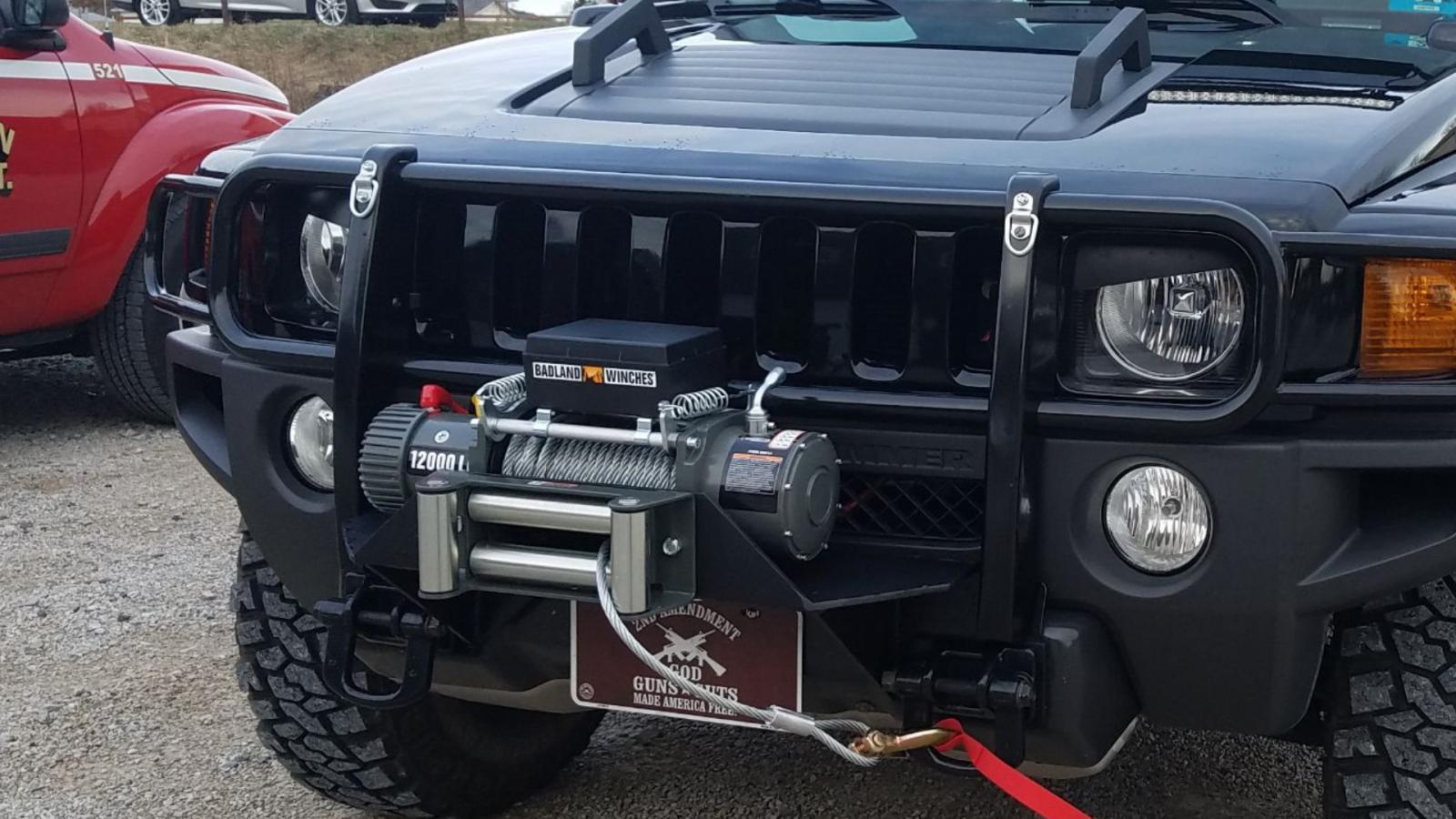

I figured anything made for a MM is long out of production and near nonexistent. But I definitely like the cut down arb look I'd say that is a lot of extra weight on my poor wore out torsion bars. I'm no professional welder but I've been trying to visualize something I could weld up to work. I made this one for my hummer.

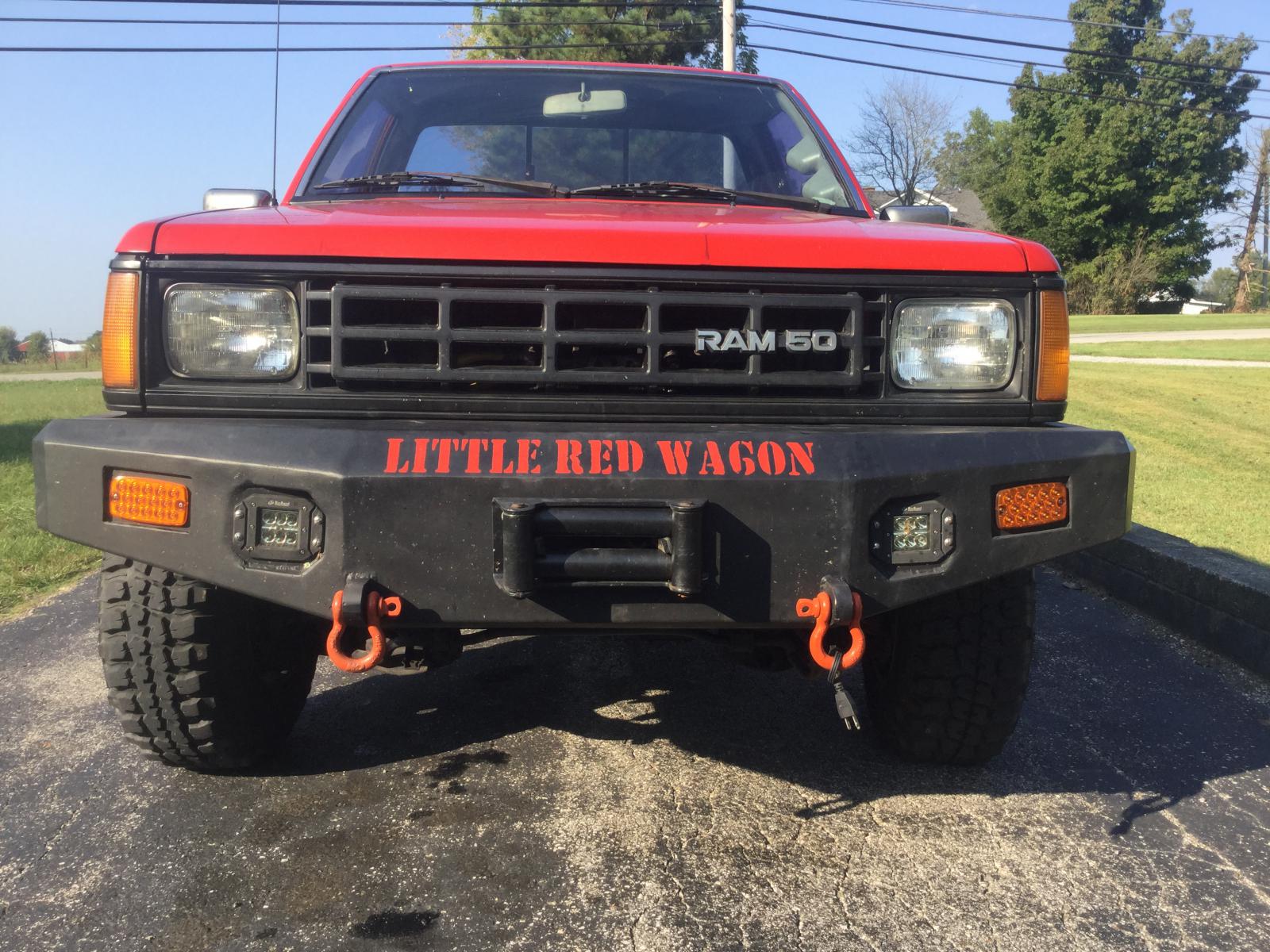

Here's what I did for my bumper. The tow hooks are on 1"x 2" pieces of bar stock that run all the way back and tie into the bumper mounts. We have a plate that bolts onto them to mount a winch. It fits in there quite nicely, if I can ever get around to buying a winch for it. That may be a little more involved than you want to do, but I hope it at least gives you some ideas!
