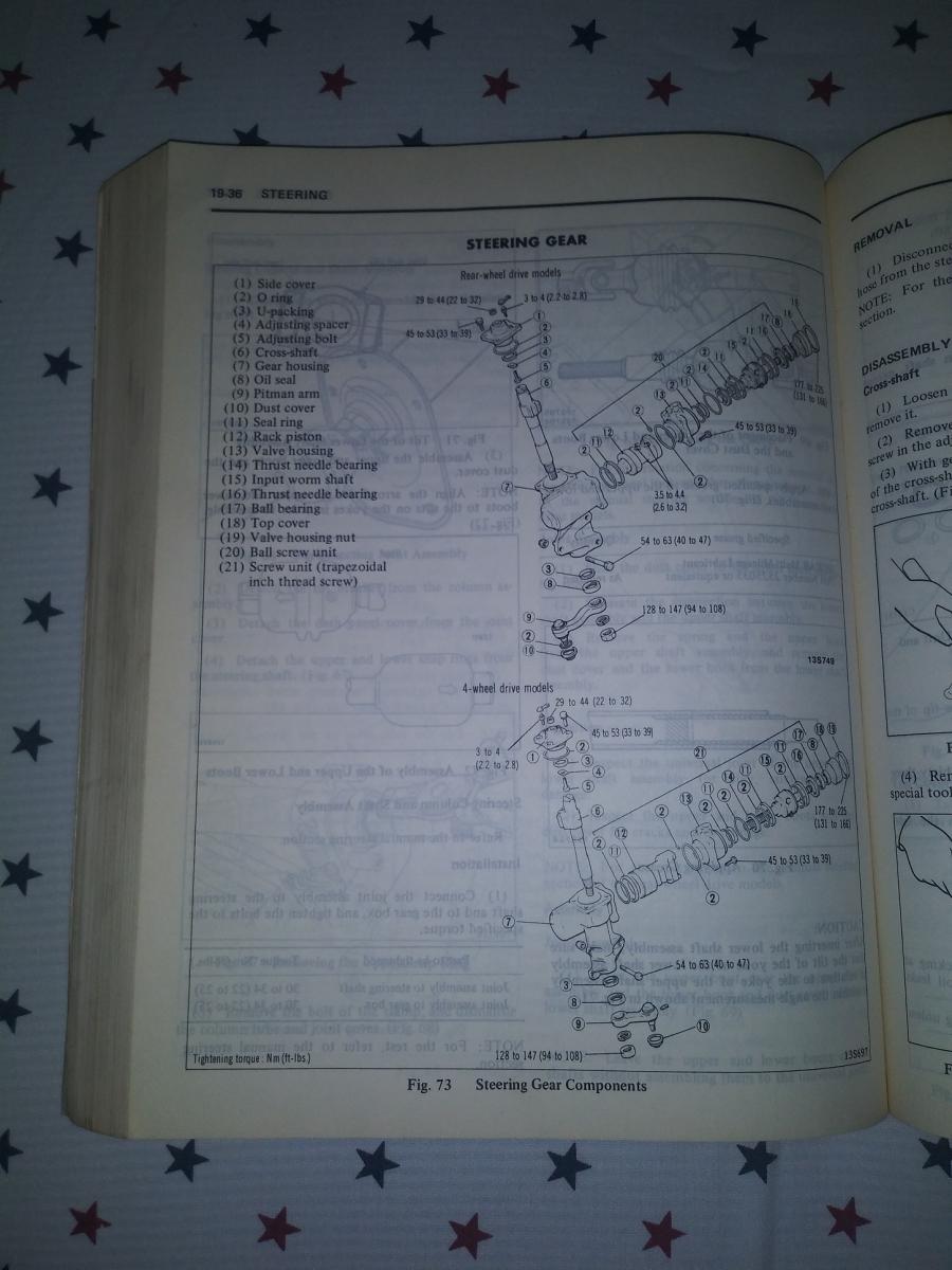

Hello, i am a new member. I have a Ram 50 that I bought in 1991 with.9 miles on it. It just turned 300,000. It is my daily driver. It is not pretty anymore. I got sandwiched and crunched it pretty good- number 3 in a 6 car pile up, but I drove away. I would like to repair and replace things , but, I am having trouble finding things. I am leaking power steering fluid under the steering rod area. Is putting new seals in the steering gear a doable job? I am not seeing a lot of info on it and the new steering gear looks like it could cost almost $300.00.
