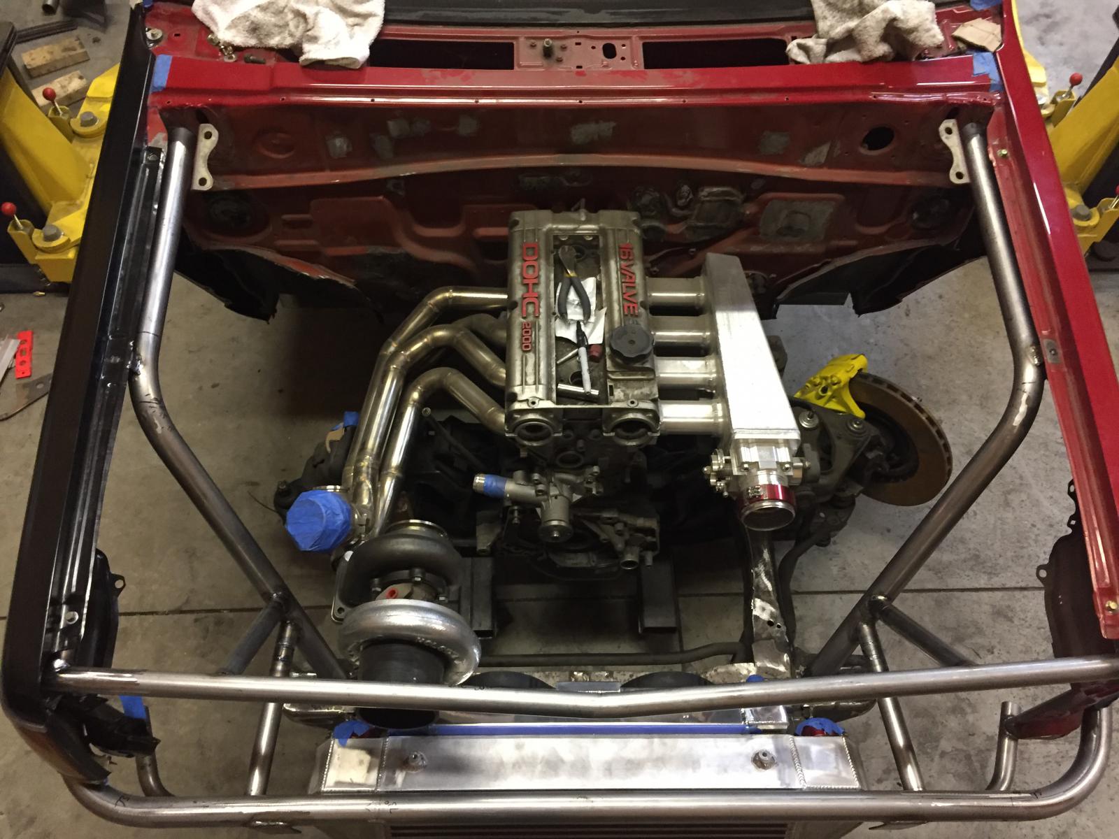

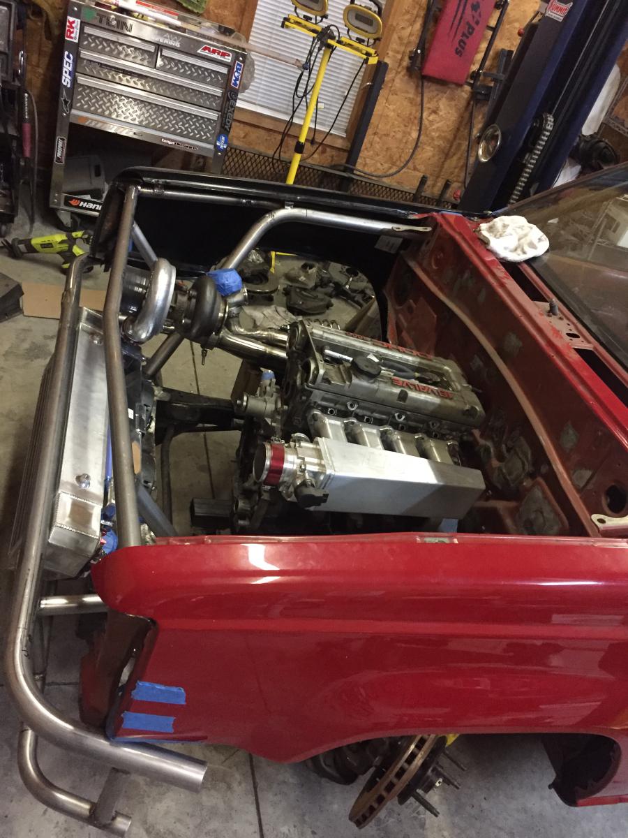

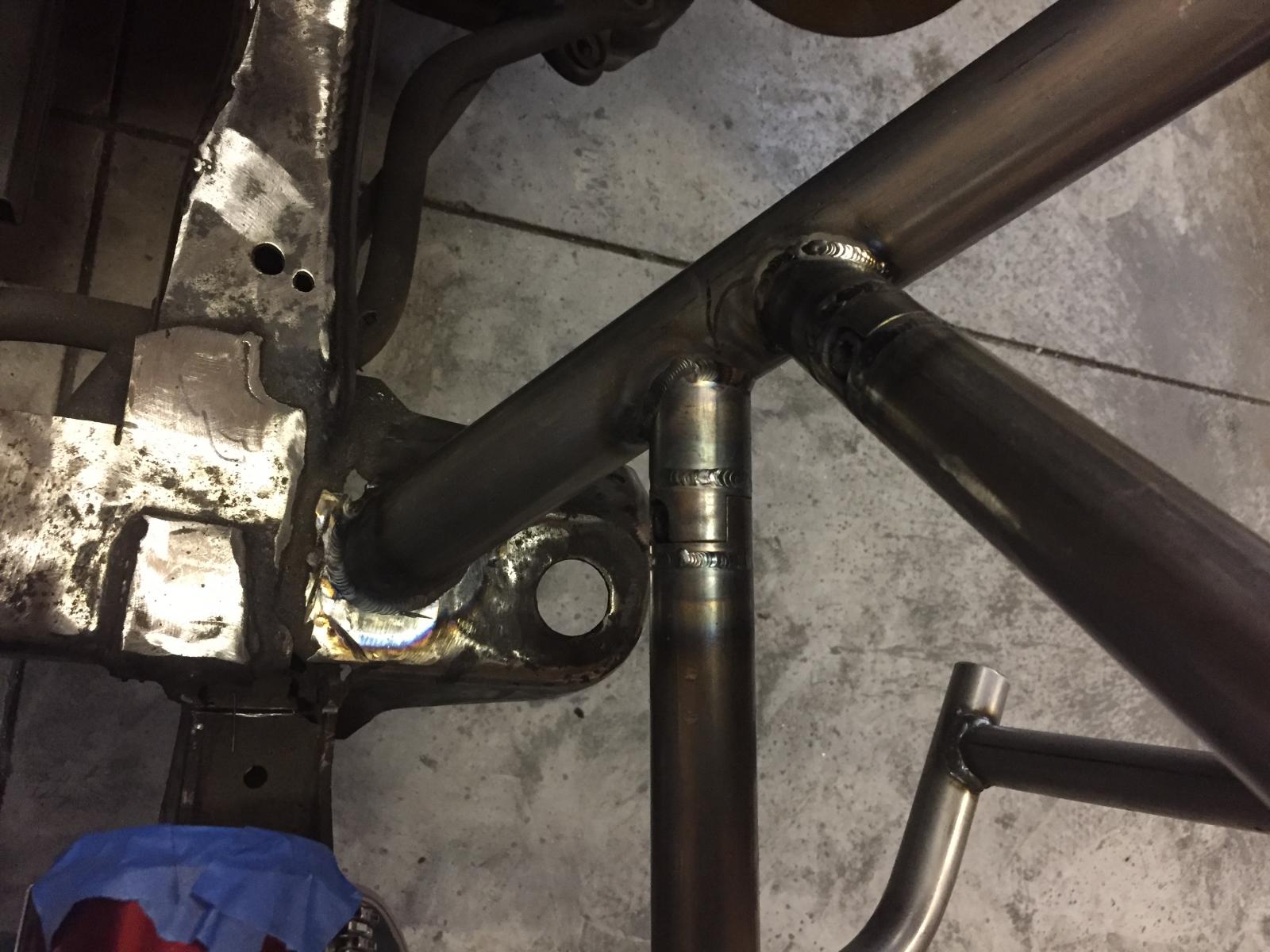

Finally knocked out the majority of the tube front last weekend. I got everything bent up and thankfully my buddy was willing to TIG it all for me (I only have a mig).Tubing is 1-5/8" and 1-1/4" DOM .120" wall thickness. Used removable tube clamps on all junctions, so the entire thing (minus the protrusion bars going through firewall) are removable for ease of engine repair/replacement. Still need to add brackets/hood pin provisions/etc etc but she's getting there. Will have a new firewall and bolt-in sheet metal fenders as well. Bars go through firewall and tie into roll cage. Paint and assembled motor coming soon! just thought I'd throw it up!
