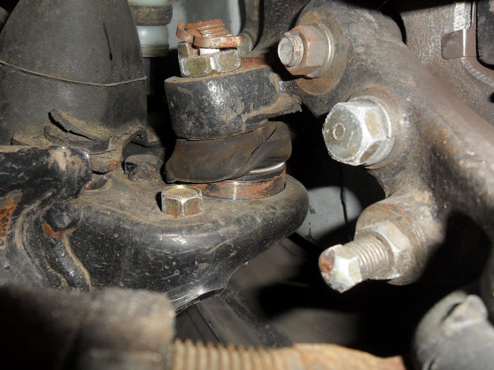

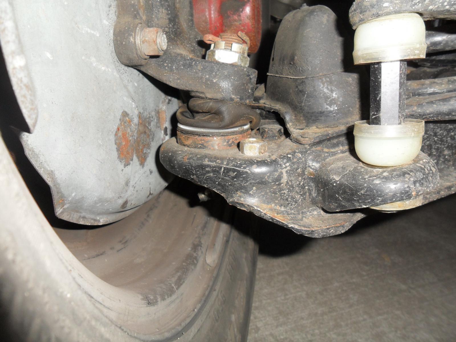

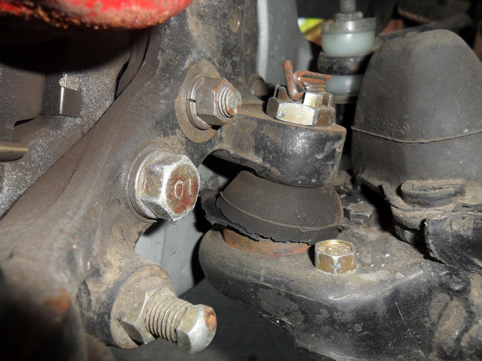

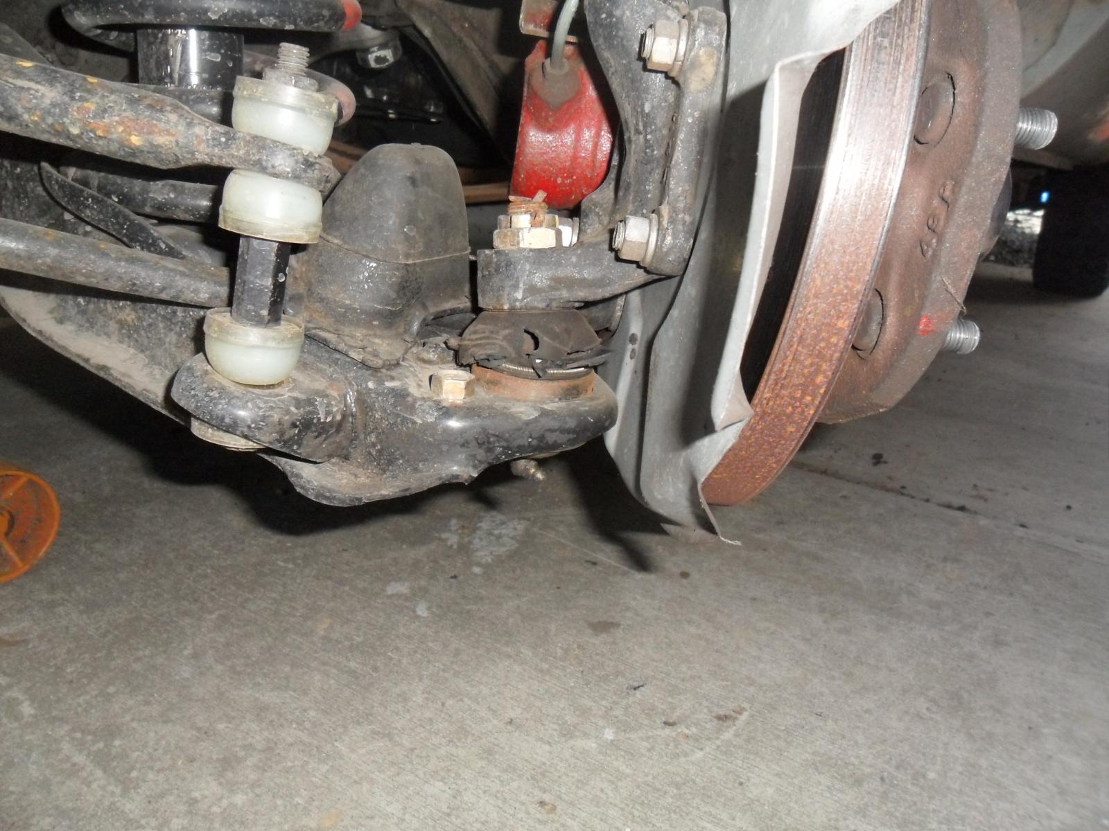

Thank You Tortron. Everything was tight. I had pressed new inner and outer wheel bearings when I did the job. Then I took the wheel off the driver side and I see the lower ball joint is toast and the passenger side is almost toast. I do not recall compressing them that much when I torqued them. I wonder if the alignment guy "did me a favor"?
Since this was just 6 months ago should I be asking Rock Auto for a refund or replacement of my moog parts? I better look to wee where I bought them before I complain :) I do sometimes buy parts from other online retailers. Some photos for your enjoyment
Attachment 20549 Attachment 20550 Attachment 20551 Attachment 20552
All those joints look bone dry - not a lick of grease anywhere...

I noticed how dry it was too. I greased em all good. I think I recall a bit of the red grease showing around the bottom. I made sure it came out on all of the fittings. I remember greasing everything because the driver side tie rod came w/o a grease Zerc.
Hard to say what the actual cause of the ball joint failures are. The boots shouldn't have come apart like that (I've only recently removed all the factory joints on my Gen 1 and the boots were in better shape than your new ones). I hate to say this but I think you don't have much of a leg to stand on in making a warranty claim. The fact they have a lot of surface rust in them indicates either extreme conditions or they weren't serviced.
How often does one "service" a ball joint? That is surface rust due to the quality of the materiel and that would not get removed in any service I know of.
Blast of grease every 6 month will be ideal, but whenever you do an oil change would be good enough.

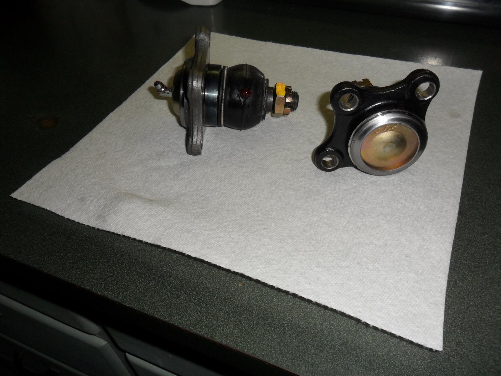

Got new ball joints today. One had no grease fitting. I put the other fitting in and greased it. I compressed the boot so I knew the grease had filled it when the boot was back to shape. Turns out the boot leaks, you can see the red dot facing in the picture. I wonder if my failed units had a leak?
Attachment 20679
Edit- Emailed RA. Got label sent back awaiting new parts.
Edit2- Parts arrived 6-14-18 Too beat should get to them tomorrow. They opened the boxes and b=]packed them with expanded foam rubber taped them up and really packed them tight in the shipping box. Both are made in Japan and have a screw in the hole for the zerc . I'm still gonna grease em before I install em to be sure.
OK new ball joints in. It drives nice again. I'm not sure what happened but there is definitely grease in these ball joints. It was squeezing out as I torqued them. I also greased every other fitting until I saw grease coming out, except the control arm shaft. The driver side upper ball joint squirted the grease right back out the zerc!
