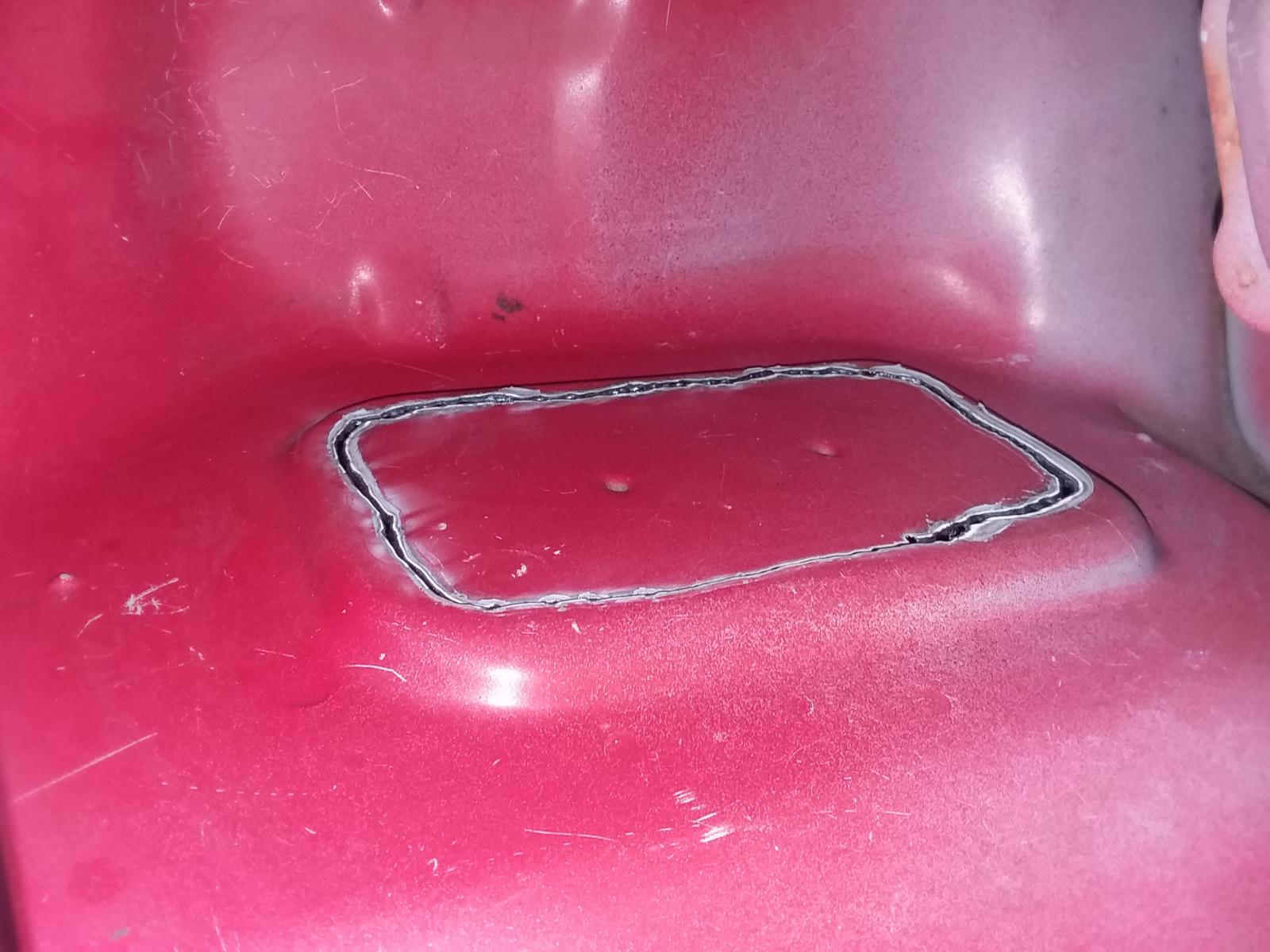

i know right? idk if im gonna tryin weld them up, or just dimple eash hole in a little bit, & use this underwater
fairing filler for sailboats that my dad uses, stuffs even petroleum resistant. ive used it to replace shifter bushings
on my e30 and covered in grease theyre still tight 5 years later... not big on filling holes but i dont know if heat
is gonna be a good idea on that paper thin roofskin. i dont want to warp it any worse than it is already.

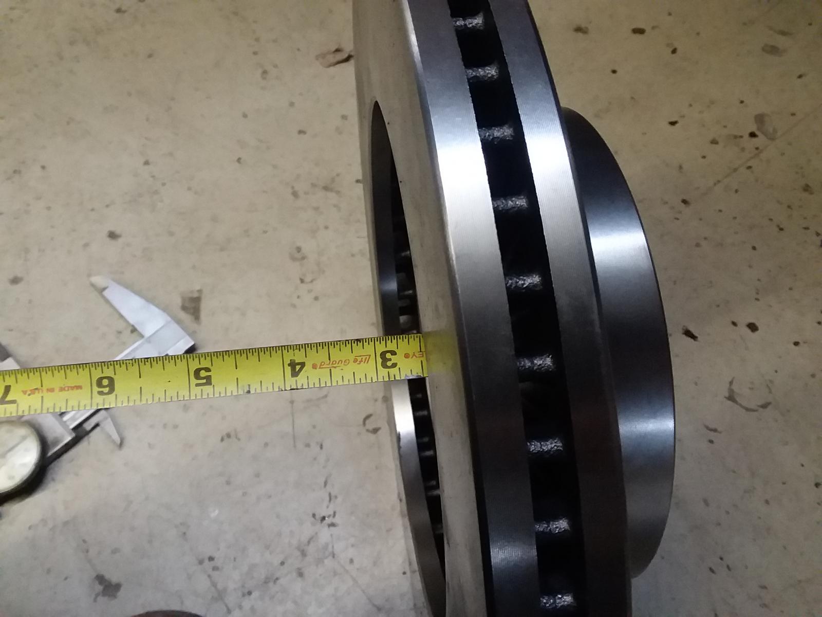

But regardless of the bullshit, i ordered a Tundra front brake rotor for fittiment on monty here.
my findings were fruitful-ish:
So my first issue was that the toyota rotors bolt on in-between the hub and the wheel, where the mitsu rotor bolts to
the back side of the hub.

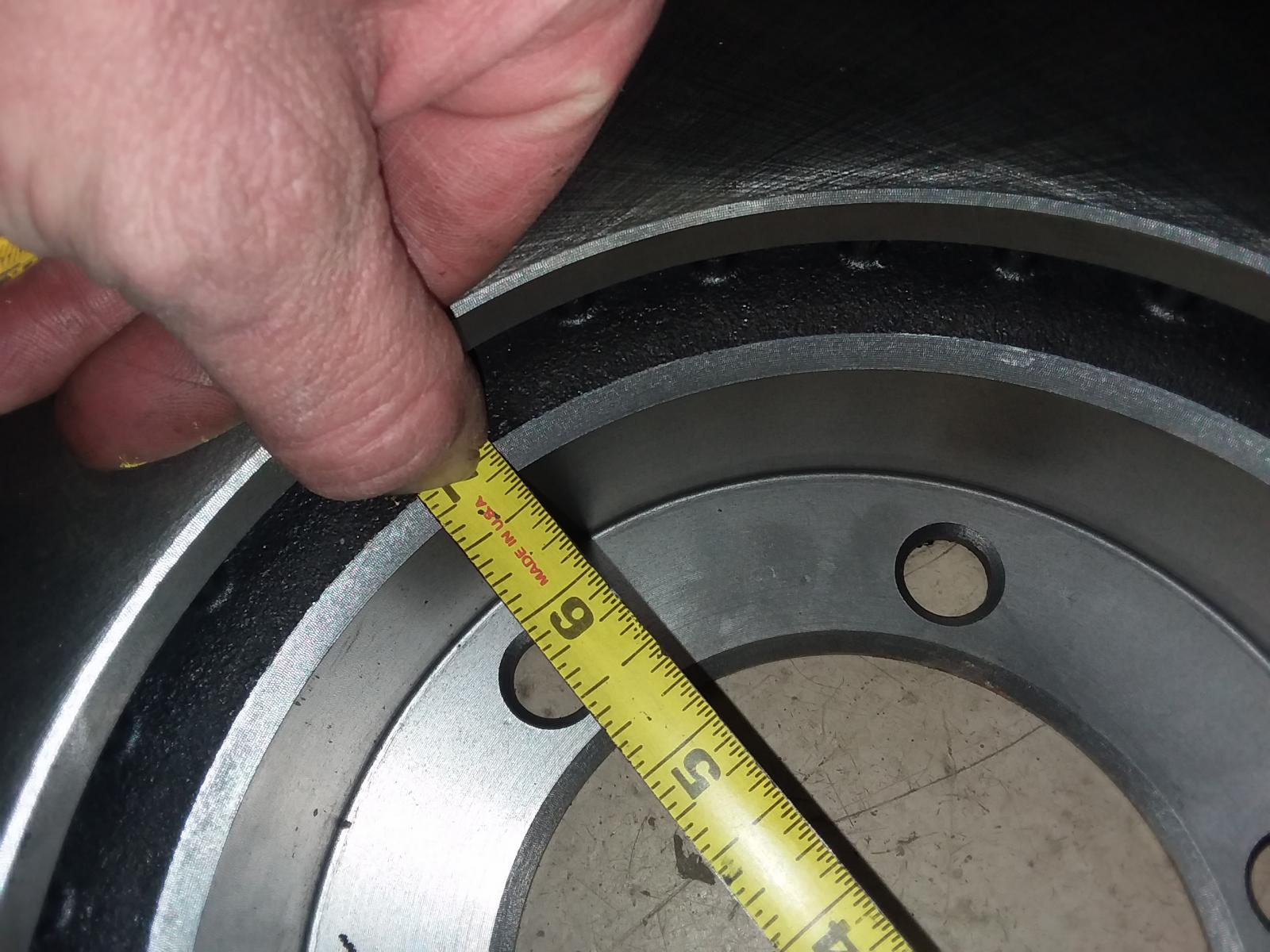

Now, 1st i wanted to see the offset of the toyota rotor hat as well as the rotor hub diameter to make sure itll
clear the mitsu hub and sit at roughly the same spot as the stock rotor.
Attachment 22276 Attachment 22277
and the tundra rotor sits at the same spot as the mitsu rotor, the tundra going on as it does on toyotas,
in between the hub and the wheel.

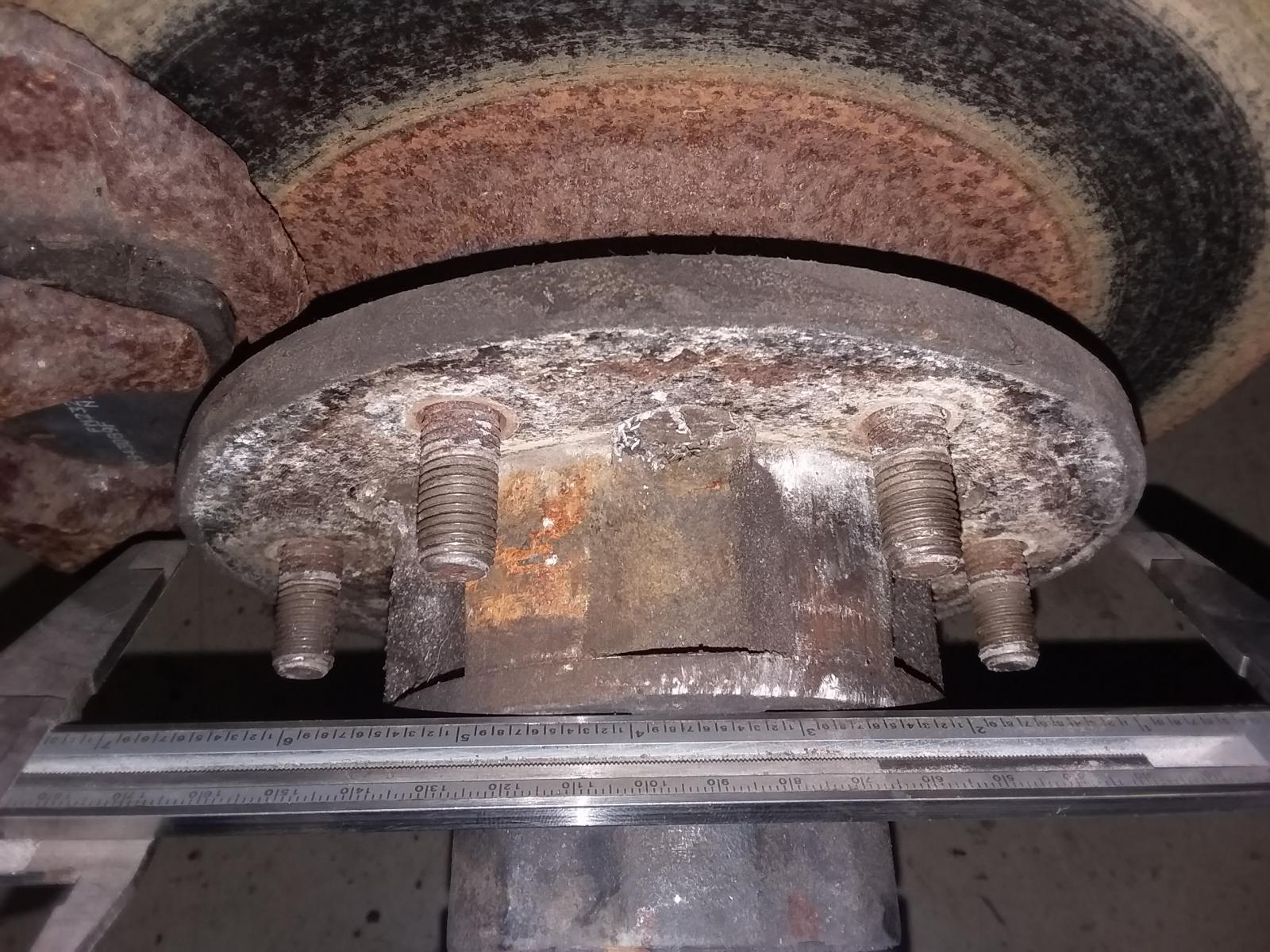

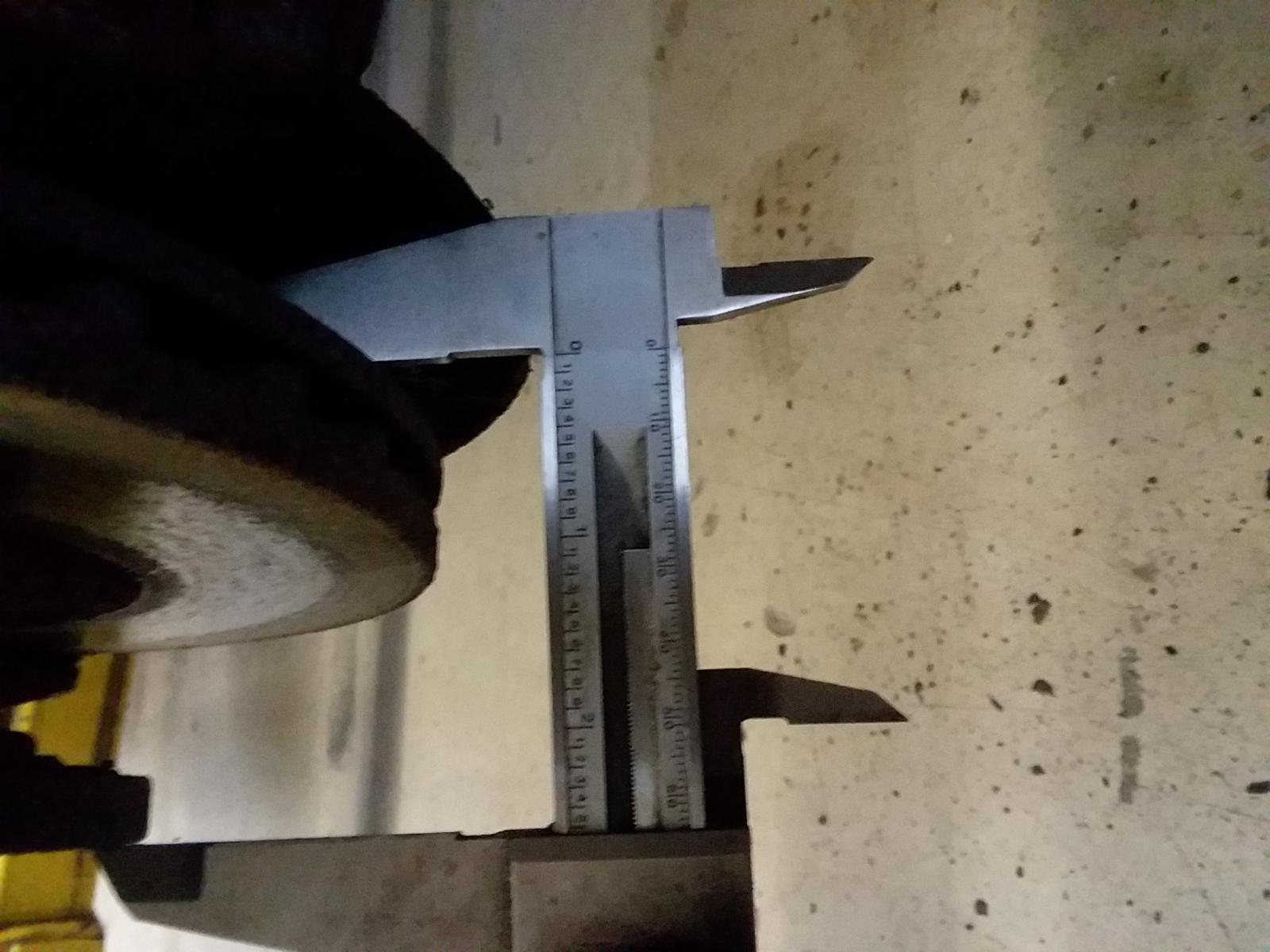

the only thing thats going to need modification is the mitsu hub itself, which is quite a bit bigger diameter
than the inside of the tundra rotor:
Attachment 22278 Attachment 22279
but there is more than enough meat on the hub to machine it off and still have plenty around the studs,
which might need to get swapped out for longer ones...

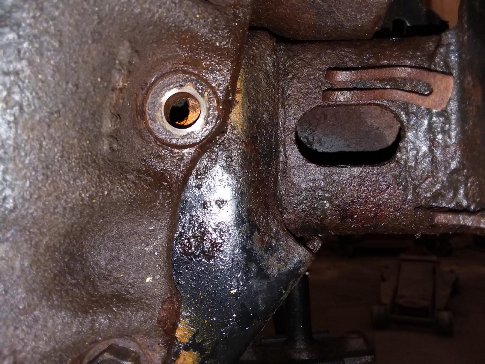

heres the steering box mount points, minus the front upper bolt
you can see the bosses are actually each a piece of pipe that goes all the way through
the framerail and is welded on both sides. so i hafta cut out the rear-most boss and move it back
about 1/8 inch, which is a small amount for all this work i will admit. but being that they are welded
in lengths of pipe, i cant oval them out, and i dont want to use a smaller diameter bolt.
with the plasma cutter and the MIG it wont be but like a 45min job.
Attachment 22381
