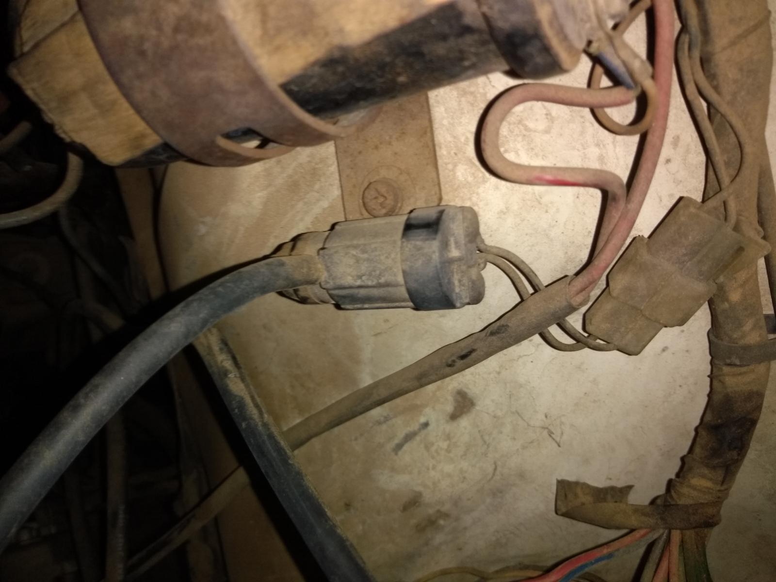

I have some more questions... What is this thing here that the vacuum line is attached to:
Attachment 24397

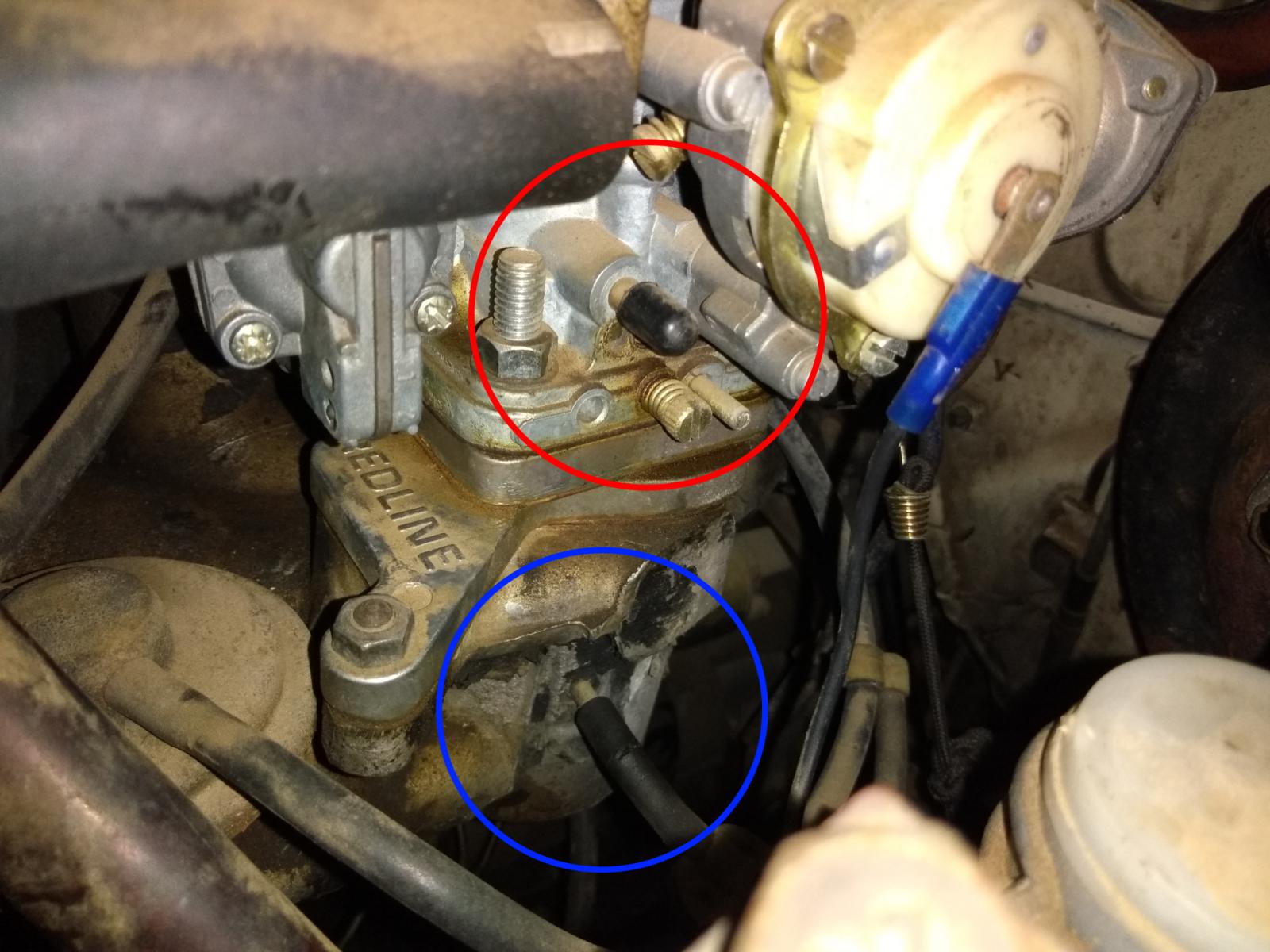

And what's this black thing in the red circle, and what's this vacuum line in the blue circle for?
Attachment 24398
The thing in image #1 is a vacuum triggered switch. It has come up before on the site and performs some kind of 'ignition on' circuit connection. A member had one fail recently and their truck wouldn't run. The thing in the red circle in image #2 is a vacuum barb cap that I think is part of the EGR system. Trace the vacuum hose in the blue circle to wherever it's going. It might be going to a control circuit or scavenging vapour/gas from the valve cover.
you'll have to follow the blue circle to find out where the hose goes. red circle, the cap is ported vacuum port. typically the vacuum advance on the distributor is hooked to ported vacuum. The lower hose is manifold vacuum port. some folks hook the vacuum advance to manifold vacuum. They are the same except when the throttle is closed. manifold vacuum when the throttle is closed provides a full vacuum signal. ported vacuum kills the vacuum signal when the throttle is closed. Personally, i find ported vacuum to be better. It provides better engine braking, and acts the same from part to wide open throttle. If your vacuum advance is hooked to the manifold vacuum, i'd recommend swapping the hose and vacuum cap.
As geezer said, that vacuum switch prevented someone else's truck from running. You could unplug the connector, attach a jumper, and see if the truck will run.

OK. The red circled port must go to the vac advance on the distributor.
The other vacuum switch you show on the firewall is the AC idle kick up. But since you have a Weber it does not do anything anymore.
